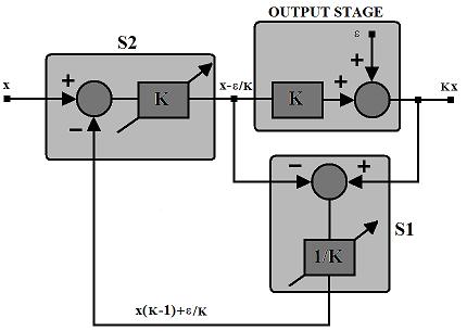

Mikeks wrote:
Hawksford is a negative feedback loop without any positive feedback
I've posted what I think is the diagram you are talking about and the loop gain equation you said was: K + e - 1. This is what I asked you to do many pages back. If these aren't right then please post whatever it is you are talking about.
This diagram is not Hawksford's model but is similar.
I am at a loss as to why you can't see the PFB loop with infinite gain around S1 and S2. Similarly the NFB loop gain is infinite.
Your node equations are only correct, in stable equilibrium, if the error term e is zero or is independent of all other node values, ie: the system is linear.
Hawksford was careful not to make this assumption. He represented his output stage as a non-linear function N. He called the input to N, Vn, and the output N(Vn). To find Vn you have to say Vn = Z(Kx) where Z is the inverse function of N defined by Z(N(x))=x. Hawsford avoided solving Vn at all - in fact he simply ingored it and assumed it was whatever it needed to be for the output to equal the input. This is why Hawksford's system is impossible to implement when a=1, b=0.

traderbam said:
For the umpteenth time: :rolleyes:
http://www.diyaudio.com/forums/showthread.php?postid=1069141#post1069141
http://www.diyaudio.com/forums/showthread.php?postid=1070832#post1070832
With this statement, Brian, you've demonstrated that you really have no idea what is going on. :eek:
No.
No.
With this statement, Brian, you've demonstrated that you really had no idea what is going on all along.
No.
No.
If this statement is true, then it implies that Cordell's design never existed. :rofl:

andy_c said:
Mike, I think I've mentioned this before, but traderbam is talking about the outer loop in the path containing the output stage. This loop looks more like a normal feedback loop, whose loop gain seems to correlate with the amount of distortion reduction. Its prpoerties also lend themselves to normal analysis methods of gain and phase margin for looking at loop stability. The inner loop, with its low loop gain, doesn't seem to lend itself well to these traditional stablity measures. Try it with the loop gain probe. You'll see the high loop gain in the outer loop.
Andy, I agree.
Bob
mikeks said:
Well, if you agree, what do you think of this? :)
If you look at HEC as a NFB system in disguise, and you look at the outer loop, yes, the loop gain appears to head toward infinity, at least at low frequencies where component values are perfect and it is assumed that we are looking at the small-signal case, where nonlinearities do not come into play in the analysis.
I believe that in an HEC circuit, you should always be able to find a PFB loop by proper block diagram manipulation.
None of this takes away from the elegance and effectiveness of the circuit, and it does not, in my view, make it wrong to characterize the behavior of the circuit as that of error correction.
Bob
Hawksford had in the tiltle of his 1981 paper "distortion correction". In the body he talks about feedback and feedforward correction and under section 1 calls the combined system a "distortion cancellation technique". In section 2 entitled "circuit topologies for output stage linearization" he refers to "distortion correction feedback". Bob, your paper uses the term "error correction".
So it seems that there is much variety in the naming of related concepts.
At the conceptual level, or theoretical level if you will, the functionality between Hawksford (feedback correction, b=0) and a NFB loop is identical. There are always many different ways to implement the same thing but I don't understand how these various names distiguish among different implementations.
I notice Bob's circuit, which is based on Hawksford's fig 5, is not a direct implemenation of the model (so Hawksford's own fig 5 is not quite the same as his conceptual model). It uses an extra NFB loop from the gates and this creates a different response than the model with a=1. It's functionality is different to fig 5 which has a different connection on the lower half.
Bob, you are very clear about calling your circuit "error correction". Could you define this term so that we can decide whether a particular feedback system implementation qualifies as "error correction"?
