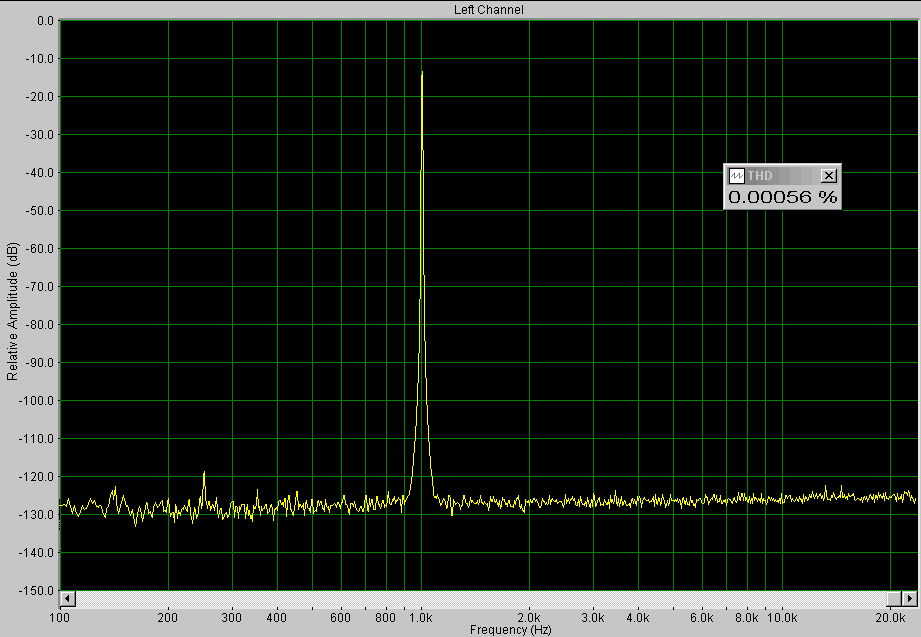

ICs do make a difference. I changed the NE5532s to OP275s in my Sony CDP-XA2ES, and it makes considerable sound difference.
That is interesting, as the NE5532 seems to be really low distortive, at least too low enough to reasonably measure it.
My soundcard has tons of these, and measures with harmonics below noisefloor.
Mike

Yes, that's a loop back measurement. The card is m-audio delta 24b96. You get these low distortion levels only with reduced levels at 48khz. At full scale it looks like all other cards.
