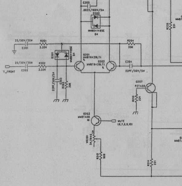

, and add a soft clip circuit to the input of the feedback amplifier
What is a soft clip cct in input of feedback amp looks like? Do you have a drawing of this?
I don't think it is different from mine:
