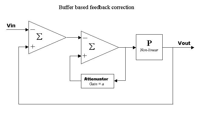

Hi Rodolfo.
You wrote:
How does one reconcile the fact there is an infinite loop gain under ideal conditions, yet nothing in the math explicitely points to singularities? How is it that actual amplifiers are built and not only do not explode but a nice "distortion nulling" pot allows smooth adjustment?
The system equations clearly show the infinite gain condition in the limit as 'a' tends towards 1 (in the HEC diagram) as far as I am concerned. The amount of NFB loop gain tends towards infinity and is effectively independent of output error. In other words, the system is under the tight grip of feedback no matter whether the plant (N) is linear or not. The feedback loop gain is not error dependent, just like a more conventional NFB system.
I would be surprised if several real circuits have not exploded (or at least demonstrated marginal stability) as designers have tried to get their systems working on the bench. Real circuits do not explode because they are gain and frequency compensated such that the PFB loop never attains infinite gain AND the phase margin of the NFB loop is large enough. [Bob Cordell's circuit is an example: his circuit is only a shadow of the HEC block diagram, it slugs the forward gain, slows the ciruit down and incorporates an output L. And it loses phase margin into reactive loads. Which is Edmond's point]. Otherwise they would indeed oscillate. Just like any other NFB loop. There is no "feedback on demand" as far as the plant (N) is concerned...it is held with an iron grip at all times. Just like any other NFB loop.
This can be better understood if one looks for a moment only at the loop formed by S1-S-S2-B. Under ideal and cancellation conditions, the path gain is exactly unity and real. It is equivalent to a ball set on a flat floor, as long as it does not hit constraints (walls or supply rails for the circuit) it stays put or keeps happily rolling, no black holes here.
If the ball is meant to be Vdrv then the height of one side of the table is Vin and the other is Vout. The table is only level when the output exactly equals the input...the feedback error signal is zero. Of course, in any NFB system if you force the error signal to zero the plant input is free to assume any value...free to roll along the level surface. What is special here?
In reality one cannot make a unity gain loop without some form of active device in between, which automatically places at least one pole in the transfer. I represented this fact with amplifier S, and if one makes the numbers for an arbitrary first order model, the equivalent transfer from S1 + input to S output turns out to be an ideal integrator with the same gain-bandwidth product as the bare amplifier S. From there on, it is bussiness as usual from the standpoint of correction, stability and so forth.
Absolutely. As the PFB loop gain approaches unity the bandwidth of the synthetic forward gain block containing the summers and S decreases as its gain increases as we've agreed before. This is like reducing the 1st pole frequency of an op-amp in OL mode. We have also agreed that the decision as to whether a synthetic gain block is superior to a conventional gain block is dependent on summers having an inherently superior GBP and distortion characteristic and upon circuit topology conveniences.
The diagram shows another possible implementation topology. The middle, unity gain subtractor needs to have very wide bandwidth and very low distortion as both degrade proportionately to the synthetic gain = -1/(1-a).
By the way, do you have any recommendations for suitable subtractor/buffer ICs?
traderbam said:
Hi Rodolfo.
The proof is in the pudding. It makes a wonderful amplifier. So much so, that Halcro decided to essentially copy it. What's your problem with that?
It has plenty of phase margin into an arbitrary reactive load with a mere 0.5 uH coil. What's your problem with that?
You're getting desperate, Brian. You are unable to get others to subscribe to your one-dimensional view of HEC, so now you have to slander an implementation of it.
I detect a severe case of NIH here.
Bob
