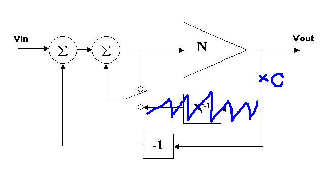

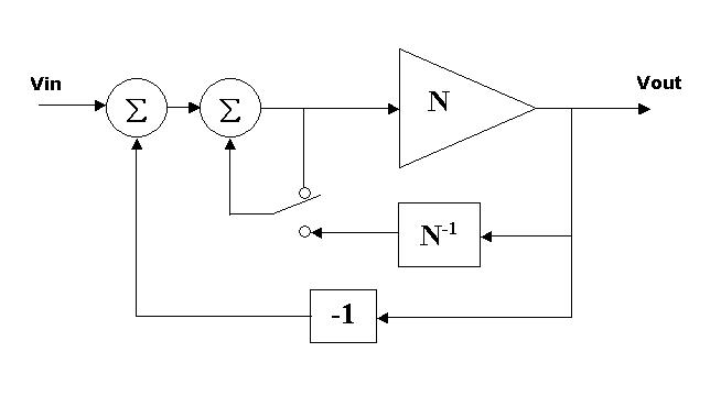

Well, see, I have these two black boxes (one for each switch postion) built with the same forward path amp block, having identical transfer functions, and being told that yet they have different loop gains.

Jan, I have an idea. Would you accept that this diagram is the same as yours, in function?

No.
Again, in this case, I can built two black boxes, one for each switch position. By your own account, these boxes have identical transfer functions. They are built with the same forward amp blocks. You cannot come up with any transfer function measurement that identifies which is which. Yet you tell me you measure different loop gains. How can that be?

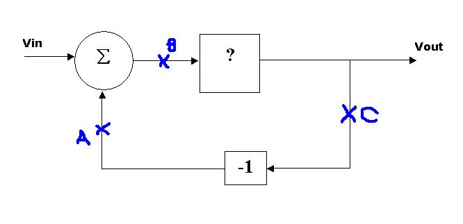

This diagram shows a feedback loop around an arbitrary gain function "?". Do you agree or disagree that the loop gain can be measured at A, B or C and that all three measurements will be the same?

traderbam said:
By "arbitrary gain function" I mean to say that "?" could contain any network of gains and PFB and NFB loops and summers.
No. Only if '?' would contain no feedback network elements (pos or neg or any combination) would I agree that A, B, C would give the same loop gain. As soon as '?' is in any way recursive, it doesn't anymore.
I think we lose again focus. I agree that the particular case you showed before with the two summers in series and the isolated pfb loop at the input of N looks innocent enough to say, OK, we measure loop gain at C and that's it.
But we can't just ignore the fact that those two black boxes I made from that last circuit give me two different loop gain values at C for essentially the same circuit. We need to resolve that. Once we do, we can apply that to H.EC and make meaningfull comments. As long as measurements on the same circuit give inconsistent results, you cannot make meaningfull comments based on those measurements. We have to resolve that.
Herein lies the cause of our discord. I cannot think of any content of "?" that would make the LOOP gain any different at A, B or C. That's because the loop gain is calculated by multiplying the transfer functions together of each block in the entire loop, so changing from A to B to C just multiplies the same blocks in a different order. Since the result does not depend on the order of multiplication (a*b*c = b*c*a = c*a*b) surely it cannot matter at which point the LOOP gain is calculated or measured? Can you help me understand where I have gone wrong?
I have no problem with two circuits having the same Vout/Vin (external transfer function) whilst having different LOOP gain measurements at C. Why should the measurement at C be the same?

In your particular example here, for instance, what would be the transfer function of the pfb block looping back into itself? Since its Vout would be its Vin + its Vout again, we get Vin is zero. A meaningless result. However, if you properly re-shuffle those loops (without changing the functionality) as we've been doing, you DO get a meaningfull result for *the* loop gain.
traderbam said:
[snip]I have no problem with two circuits having the same Vout/Vin (external transfer function) whilst having different LOOP gain measurements at C. Why should the measurement at C be the same?
Well, you've got to be kidding here! We've done the exercise with the SPDT switch leading to two identical circuits (functionally) having at C two different loop gain measurements. Since it is loop gain that determines the transfer function, that in itself should ring a bell large enough to park your car in.
Nothing is stopping me from making a switch with an infinite number of positions, making an infinite number of identical circuits by shuffling around the feedback loops. That would lead to an infinite number of different loop gains at C, all with the same transfer function. That would pretty much make any loop gain measurement irrelevant.

This may shed some light on it. From the guy that does the spice developments for Beige Bag:
Before getting into the simulation loop gain methods, it is important to remember that most of the college and academic discussions concerning loop gains, and servos in general, are based on a BLOCK DIAGRAM model representation. See Figure 1, from Reference 1.
Figure 1
Typical Block Diagram
Each block in a BLOCK DIAGRAM has the following characteristics:
1. It is infinite impedance at its input (if it represents a voltage-to-whatever transfer function. If it represents a current-to-whatever transfer function the input impedance is zero.)
2. It has effectively zero output impedance (if it represents a whatever-to-voltage transfer function. If it represents a whatever-to-current transfer function the output impedance is infinite.)
3. The signal flow is unidirectional. Changes at the output of a block due to loading or signal application do not create changes at the input of a block due to direct transmission through the block in the reverse direction. Information flows only in the direction of the arrows.
Note in particular point 3. When you leave the pfb block in-line, so to say, and don't cut that part of the loop, you violate characteristic 3.
I don't know WHY that characteristic is a condition, but it does lead to different loop gains at C for the same circuit. Once you include the pfb block in the loop-cut thing, i.e. make all the arrows go in the same direction, those differences disappear.
Block diagram attached.
