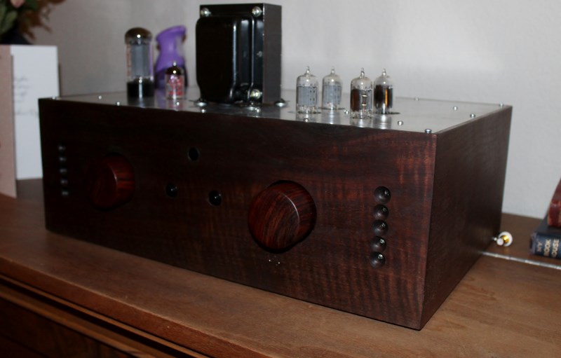

Well, in addition to the neohm 50R resistors in the I/V positions, I upgraded about 12 other resistors with a nice quality resistor. I also replaced the coupling caps with Duelund Cu PIO 1 uF coupling caps, which on purchased on sale from Parts Connexion.
I am very pleased with the end result.
