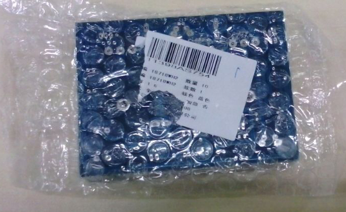

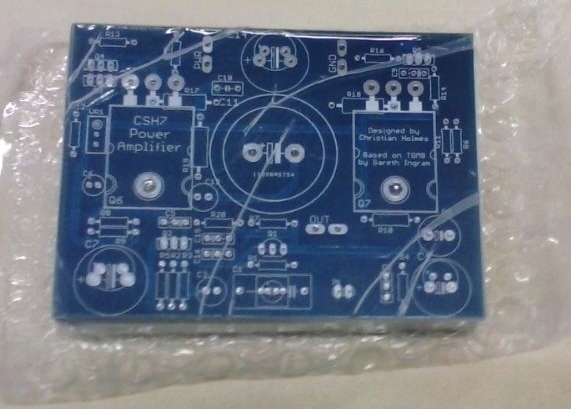

Hey guys, some "teaser" shots the board house sent me before putting them in the mail.

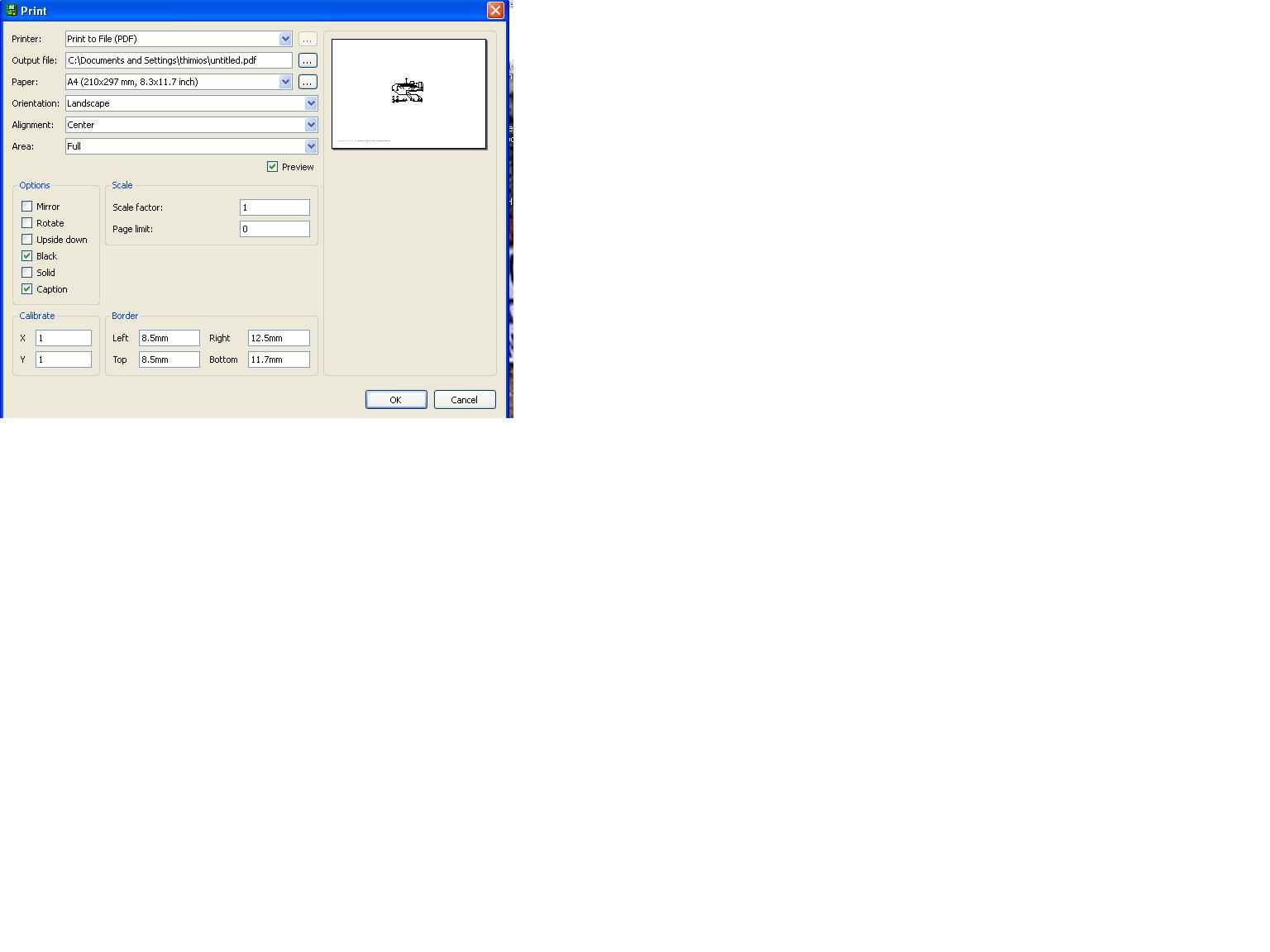

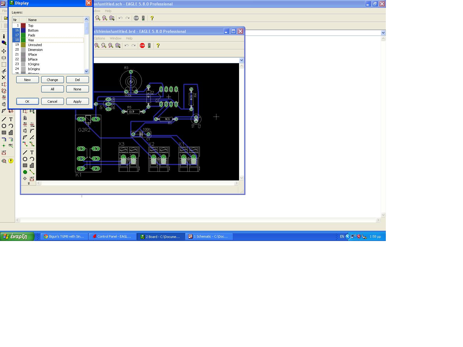

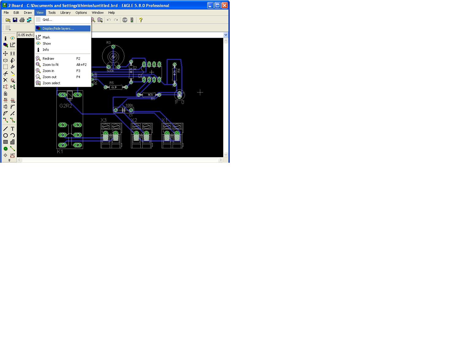

Hi timinos, is this what you want?
No,you must press,view,display,hind layers,bottom,pads,vias(checked) and print this first.
Then press,view,display,hind layers,top,pads,vias (checked)and print again.
Press view,display hind layers,press none,mark bottom-pads-vias press ok.Now you see bottom traces and pads only!That is what you must print.
Because you have a dual layer board you must print the onother time.
Press view,display hind layers,press none,mark top-pads-vias press ok.Now you see the top traces only!That is what you must print.
Finaly you have two different pdf,one show the top and the other the bottom traces(nothing else,only traces in black&white).
Hope this help.

Andrew, I asked myself the same question about posting layout files but in the end I decided to do so. So long as Christian is OK with it I'd say "so what if they do" make copies - then perhaps more people will enjoy the amplifier. I suspect there's very little profit to be made selling small boards if you take into account your own labour effort.
I agree with that Gareth. This is just a hobby for me so I'm not interested in profiting from my it. I seriously doubt there is any money to be made from this type of stuff, but if the Chinese rip off my PC board and make a few bucks then so be it :)
I'll post up the Eagle files once I've built and tested.
