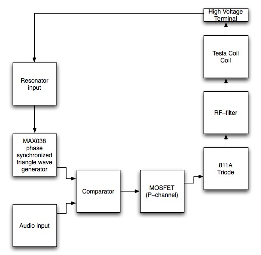

Breaking News
The 6146W pentode stage has been replaced by a power triode stage.
Previously there were two signal inputs to the 6146 pentode; one finely synced however otherwise
"dumb" square wave from the oscillator, and one audio modulated drive voltage.
Since the MAX038 also generates a pretty decent triangle wave; why not use this for creating a
real audio modulated PWM drive from the oscillator directly?! running at 10MHz!
One other feature is that with the PWM module one has the choice of operating in negative
and positive amplitude modes (simply by switching polarities in the comparator).

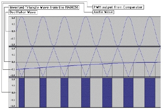

PWM module
The grid of the 811A is now driven by an 'embedded audio signal'.
This pulse width modulated square wave can have a maximum duty cycle of
50% or half the oscillator wave length. To achieve this, the triangle wave from
the MAX038 has to be double the amplitude of the peak maximum audio signal.
And then the audio signal is lowered/biased so it doesn't go beyond the zero point
level of the triangle wave.
On the other hand, there should also be some PWM output even when there is
no audio signal present, so as to keep the oscillator going.
I'll make a more detailed schematic some day soon.

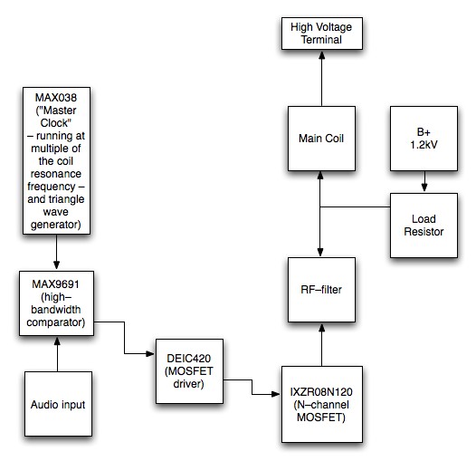

MOSFET–stage transducer driver
Since the coil resonance is constant and non–drifting, the modified tesla coil based Biefeld–Brown effect based driver could be driven directly by a MAX038 that is tuned to the resonance frequency of the coil. That is, without any external 'clock input' from the coil. This way there are probably no need for the phase sync and phase adjustment/delay circuitry.
My previous calculations for the phase adjustment where no good anyway

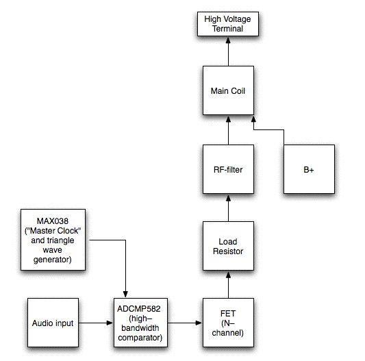

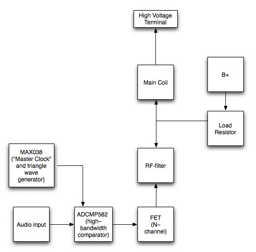

Solid State plasma tweeter driver
Simulating a resonator circuit I got some indication that a master clock running at
multiples or 'early harmonics' of the resonance frequency gives comparably higher
voltages (lowering the coil resonance = extended wire length, giving more amps).
The comparator has been replaced with one that is a bit easier to work with.
edit: I have a feeling that I may in this some day wake up to the ever returning
amplitude invertion problem, so some lobbying towards the Audacity programmers
might be a good thing
