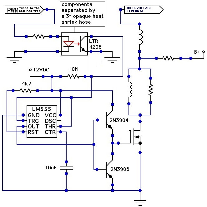

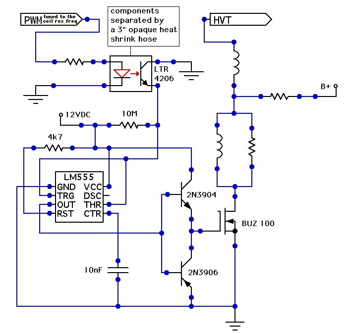

Optical Link
Here is a schematic for an optical link and MOSFET driver, based on
the schematic from http://www.electronics-lab.com/projects/misc/017/index.html
Hardware Engineers
It seems that this project could need hire a few good hardware engineers...
The phototransistor had a faulty/reversed polarity in the schematic posted previously.
And the circuit's bandwidth is probably not high enough for a 10MHz signal (I couldn't
get the 555 started in the simulator to verify).
The main reason for the optical link is to avoid frying the master clock at an eventual
fault in the MOSFET, for simplicity it could well be omitted.
