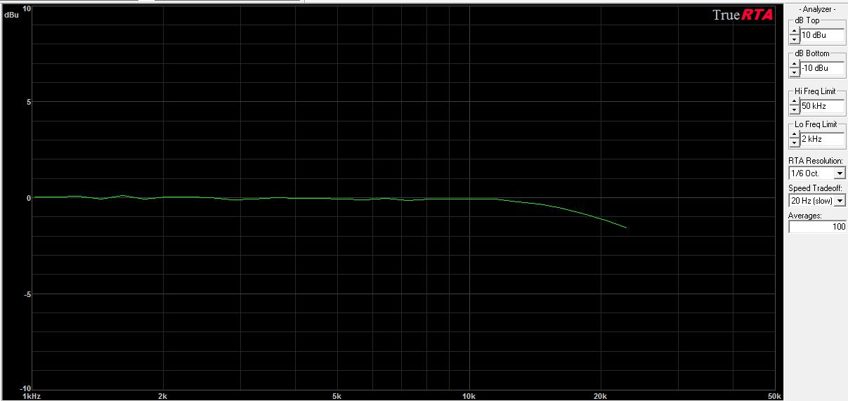

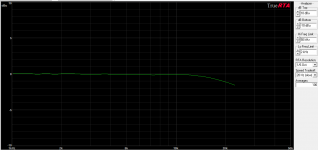

Marco, have you tried comparing the frequency responses of the two DACs? The "digital glare" versus "smooth/subdued" subjective description fits what a slight roll off in the upper frequency range might sound like. Like you said, it was subtle. Might be worth measuring.
I'm convinced that almost everything we hear can be captured by the humble frequency response. Or least, a lot of what we hear can be captured in the FR.
Multi-bit vs. delta-sigma? Or is it simply the Frequency response??
Now this was interesting.
Intrigued, I went and measured the frequency response of my system when reproducing pink noise (24bit/96kHz WAV, FR flat out to 48kHz), first
- (A) using the RATOC (R2R multi-bit) dac, and then again
- (B) using my network's built-in (delta-sigma) dac as a point of reference.
For both measurements I used my calibrated Beyerdynamic MM1 mic and the TrueRTA software package. My mic preamp/ADC only works up to 48kHz sampling rate, so that is what I used (the mic itself isn't calibrated beyond 22kHz anyway).
I then computed the DIFFERENCE between measurements (A) and (B), and this is what came out (see attachment).
Basically, the RATOC dac seems to employ a "smooth roll-off" low-pass filter rather than the more common/standard "brickwall" filter such as the one that is used in my "reference" dac, and this results in a frequency response with a gentle slope past ~12kHz which leads to a subtle attenuation of approx. -1dB at 20kHz.
Might this small frequency response difference be the main (only?) reason for the subjectively slightly "smoother" sound of the RATOC dac? (Rather than the whole multi-bit vs. delta-sigma thing?)
