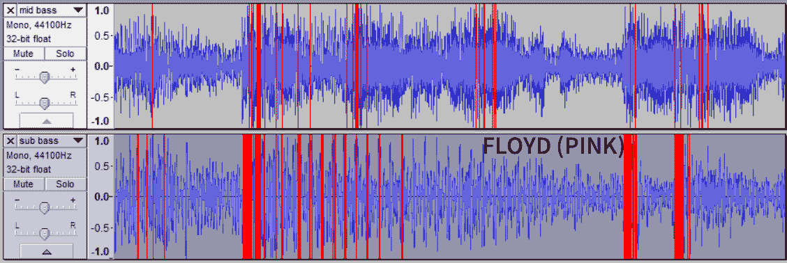

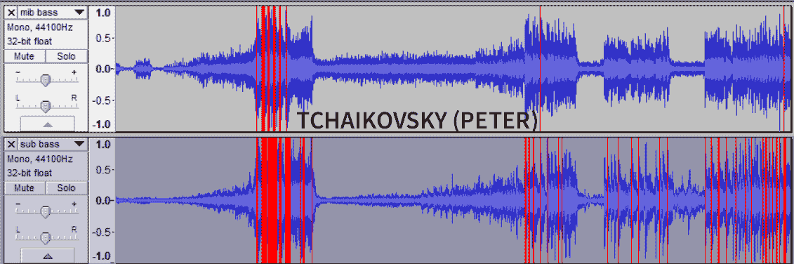

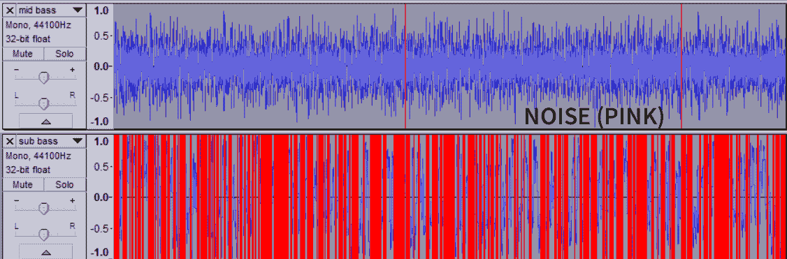

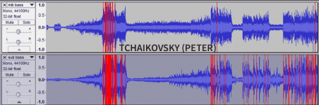

Here is the basic idea for visualizing when the sub and the mid-bass driver would get into the compression zones, and how often. Red is the compression zone.
3 different signals:
  • 1812 overture finale
  • Pink Floyd - Wish You Were Here
  • pink noise
The upper track on each graph is the mid-bass, 100-800 Hz. The lower track is the sub woofer, low passed at 100Hz.
You'll see how much the sub would be into compression, when the mid-bass driver is just touching that zone. This is based in the graphs published for John's system.
