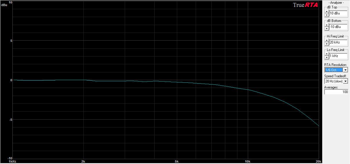

Same measurements but with 44.1kHz file
This time, I went and measured the frequency response using pink noise at 16bit/44.1kHz.
- (A) using the RATOC (R2R multi-bit) dac
- (B) using my network's built-in (delta-sigma) dac as a point of reference.
I then again computed the DIFFERENCE between measurements (A) and (B), and here is what came out (see attachment).
Basically, the RATOC dac exhibits the same kind of slow roll-off, but now starting lower (-1.2dB at 10kHz already), and is down by a whopping -6dB at 20 kHz!
This correlates very well with the fact that the perceived differences between the two dacs are more manifest with redbook (44.1kHz) source material vs. high-res files.
Again, does this point to the fact that it is probably the frequency response resulting from the choice of anti-alias filtering (slow roll-off vs. "brickwall") - and possibly the associated time-domain behaviour in terms of ringing - that accounts for the perceived differences, rather than the inherent conversion technology (i.e., multi-bit vs. delta-sigma)?
It seems to make a lot of sense...

Further musings on this DAC thing...
So, according to the manufacturer, the RATOC dac operates "without Oversampling and Digital filter".
So it probably just employs a slow analogue anti-imaging filter. This goes a long way towards explaining the measured FR droop, especially at the lower sampling rates.
In essence, this is not only a ladder R2R multi-bit dac, but it is also of the rare "NOS" breed, and as such it is the polar opposite of a modern, conventional sigma-delta dac which oversamples everything x4 or x8 and employs a steep "brickwall" digital low-pass filter.
NOS dacs have their followers, despite having some undeniable issues (poor rejection of out-of-band frequencies being the most prominent one, of course). Basically, they trade off FR linearity for improved transient response.

That is an amazing different in FR, I've never seen anything like that on a DAC. But if one of them is using a low order analog filter, That does seem possible.
Do you have a way to test the DAC with sweeps and without going thru the speakers. By that I mean a good soundcard with line level inputs? The line level input on a laptop would probably be good enough. I'm a little puzzled by the smooth, smooth graph. That's unusual with pink noise. Perhaps the averaging is very long?
If I read correctly, marco_gea used the input mic as a "line" input. Is this right?
Reading some datasheets from digital filters (eg. DF1706), the "slow" roll-off perhaps match with this response. Since I use the DF1704 filter in my PCM DAC, I measured the inpulse response (years ago). The less ringing in the square wave is evident with "slow' setting. A difference in time domain, for sure.
Yes, I measured the whole chain using my calibrated mic into the sound card.
Any effect due to the amp, speakers, room etc. is zeroed-out when computing the difference between the two measurements.
According to the manufacturer, "The RAL-24192DM1 doesn't use the DF1704 8 x Oversampling and Digital Filter chip". Instead, I think the "raw" output of the PCM1704 r2r dac chip is just passed through a mild analogue filter. I think this explains the -6dB @20kHz with 44.1kHz material: approx. -3dB are due to the inherent sin(x)/x function, plus -3dB at the corner frequency of the analogue low-pass filter @ Fs/2.

Thanks for the test, Marco, and for confirming that it is indeed the change in FR that you are responding to by subjectively classifying it as smoother sounding. That's exactly what a slightly rolled off top end sounds like. There might be ringing, but the way we perceive sound is via the FR, and so, the FR manifestation of the ringing is what we would hear.
Can you also measure just the DAC response, like Pano said? The 6 db roll off seems a bit much, and I wonder if the directivity of your speakers is playing some role here.
The next step would be to make the two DAC (only) responses the same (do not correct the measured speaker response) and see if it gets rid of the relative subjective differences between the two DACs.
That would be a bit of a pain in the neck to do, because I have already installed the dac in the system, and it's awkward to reach behind it now, without moving a lot of stuff around.
Yes, initially I was surprised too, but then I thought: -3.8dB at Fs/2 are due to the intrinsic sin(x)/x response of the dac process itself (which, unless compensated for in the anti-imaging filter, is universal and unavoidable). The additional ~2-3 dB of attenuation may well be due to the "shoulder" of the gentle (-6 dB/oct??) analog low-pass filter...
The directivity of my speakers (or any other speaker- or room-related effect) has NOTHING to do with what I measured, because the plot I posted is the result of mathematically calculating the DIFFERENCE between two measurements (respectively using my other "Reference" dac and this one), so any speaker- or room-induced alteration is automatically zeroed out in the process.
Yes, I was thinking of trying this. I could do it by connecting my PC to the RATOC dac (instead of feeding it by SPDIF) and doing the appropriate pre-equalization in the PC itself. But it would be tricky to compensate exactly for the FR "droop", and also I'd have to figure out a way to switch between the two chains (network dac vs. PC>RATOC dac) seamlessly in order to be able to A/B them in real time...

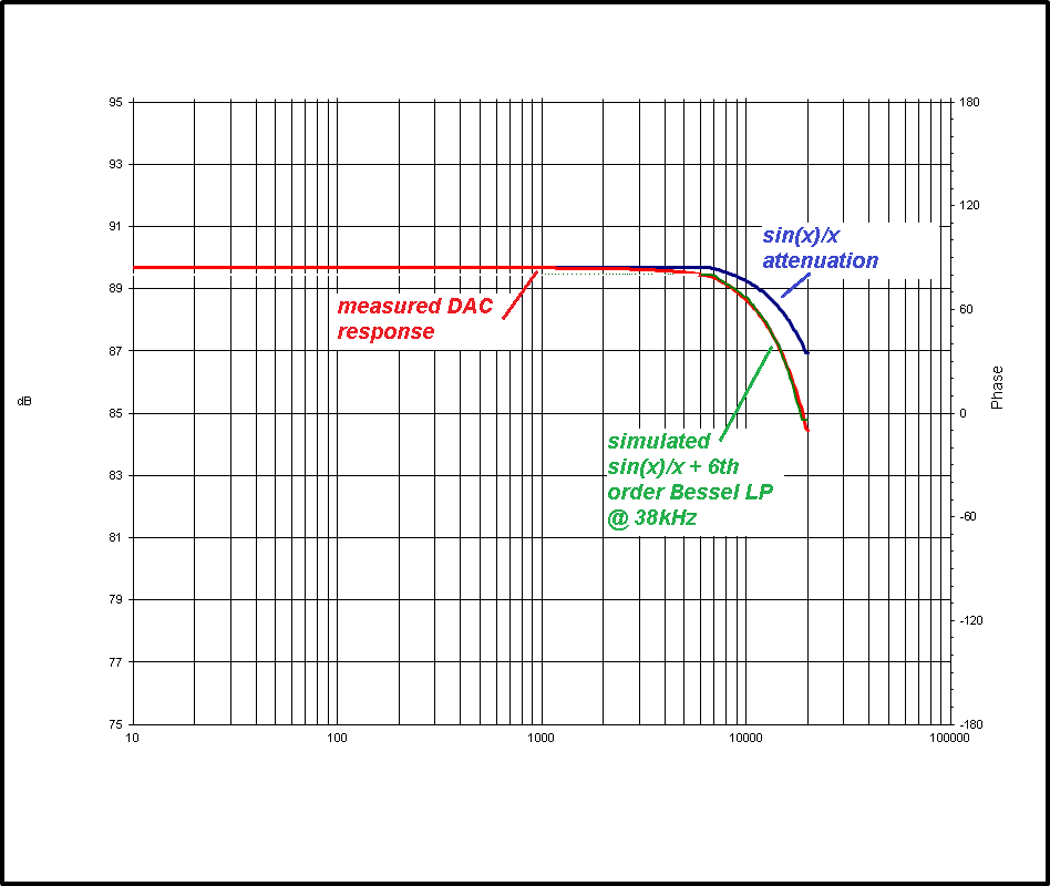

This link explains the basic process well, I think: DAC frequency response
I went ahead and modelled the theoretical sin(x)/x attenuation with Fs=44.1kHz, and then tried concoct a LP filter in order to match the measured frequency response of the RATOC dac. Turns out, a 6th order Bessel at approx. 38 kHz (= 0.86*Fs) does the trick (see attachment).
So maybe this is what they are doing in there. No digital filter, followed by an analog 6th order Bessel? (in fact, a 4th order Bessel with a slightly lower corner frequency seems to fit just as well, so it could also be that. But a 1st or 2nd order filter it definitely is not).
