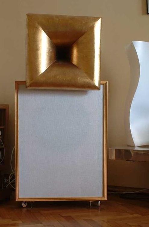

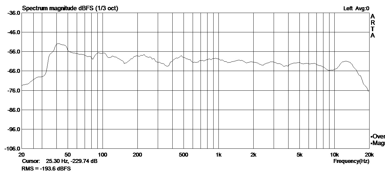

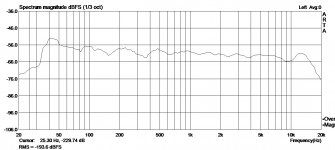

My 2 way Altec based loudspeaker (416-8c in 180 lit. BR + 288-8k on 400Hz JMLC horn); both channels measured at listening position (average of 10 measurements 1m2 around listening seat).
