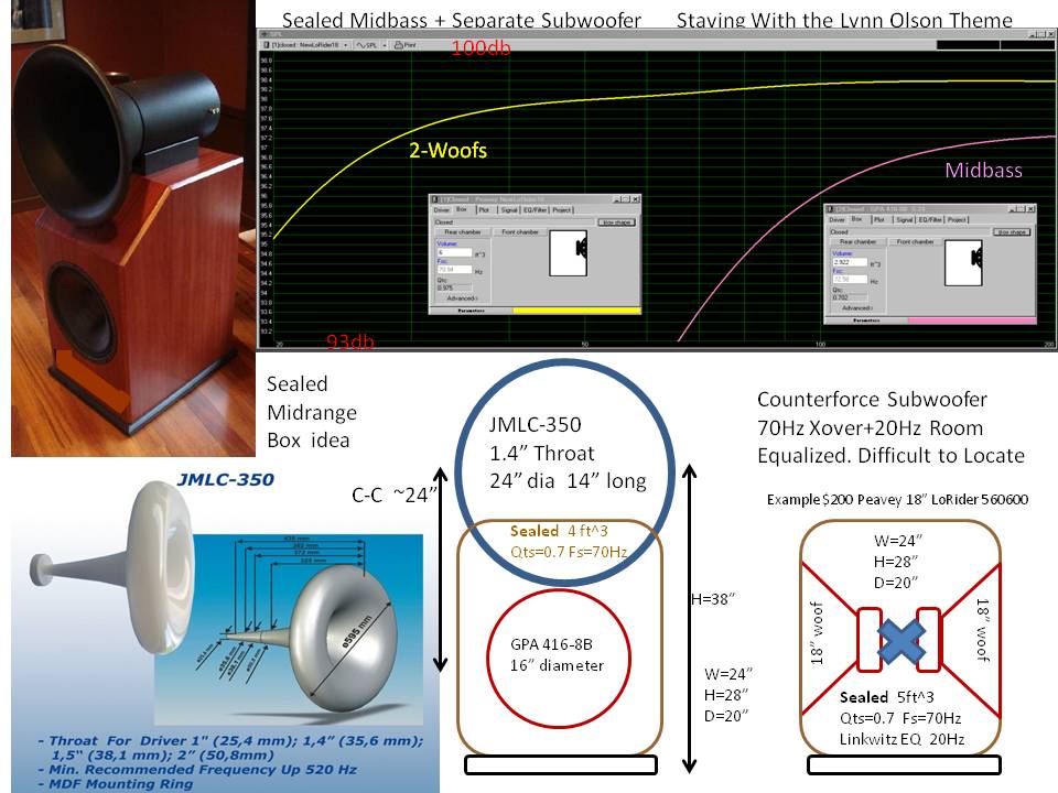

When you add a "real" "big" woofer to your speaker, will you put it under the midbass like Gary Dahl has done(JMLC+TD15M+TD18H stack), or will you add a separate side "real" "big" woofer cabinet? i.e. Is it better to push the center of the JMLC above ear level when adding a woofer, or better to put the woofer to the side of the midbass(GP416 or TD15M) to maintain the center of the JMLC at ear level?
Adding a woofer allows using a modest volume sealed cabinet for the midbass, which is often the best sounding design solution.
