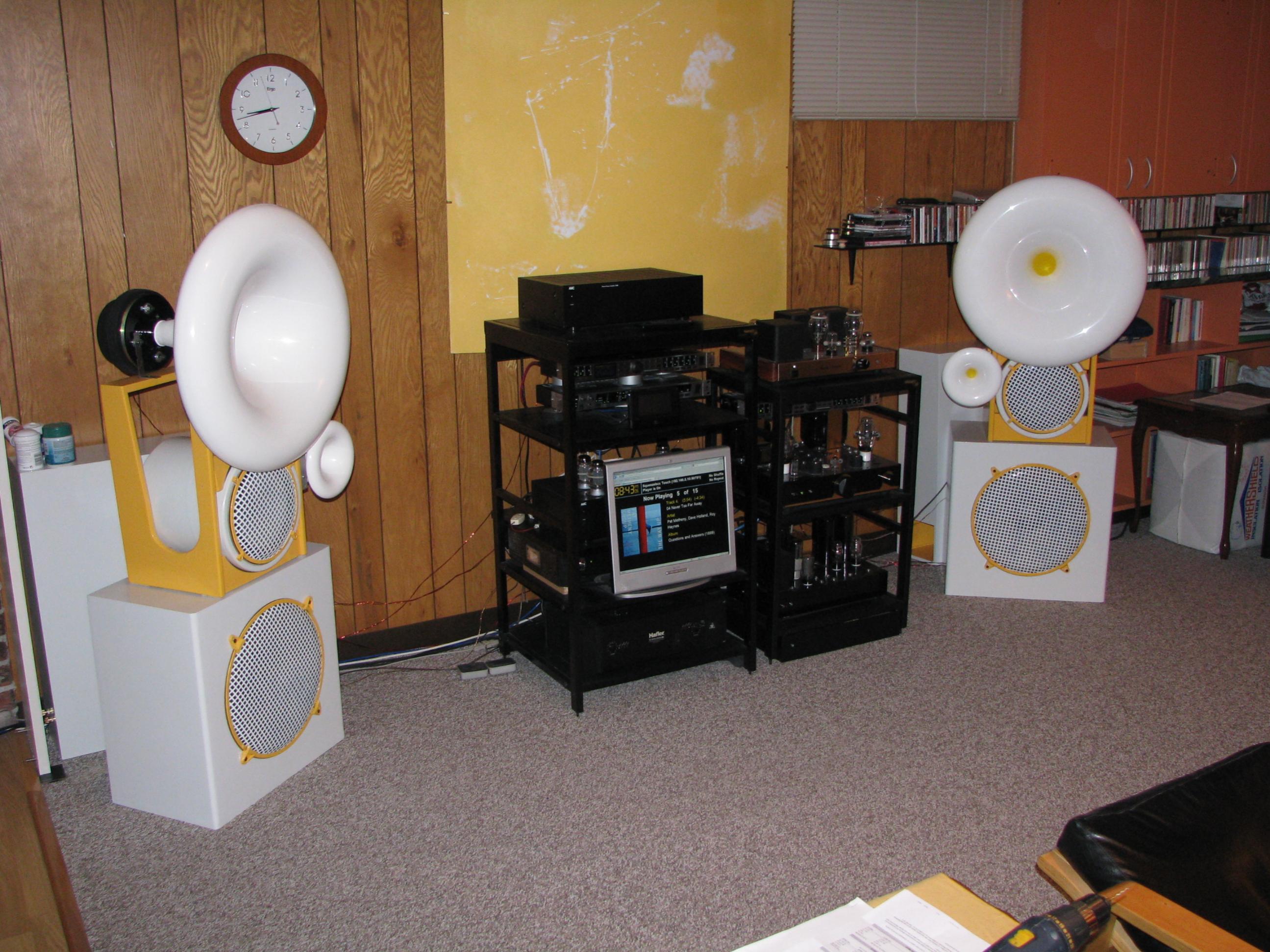

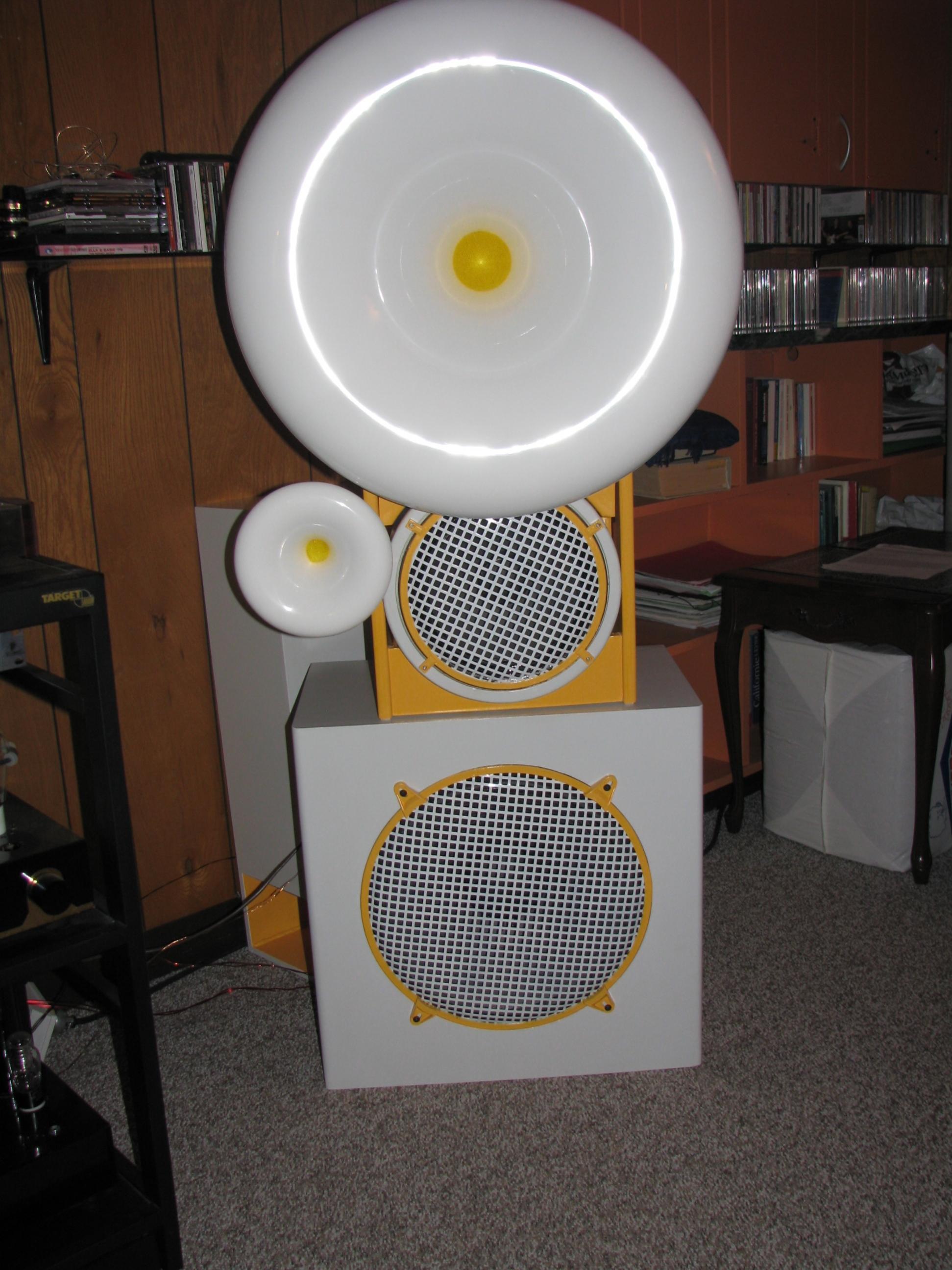

When you add a "real" "big" woofer to your speaker, will you put it under the midbass like Gary Dahl has done(JMLC+TD15M+TD18H stack), or will you add a separate side "real" "big" woofer cabinet? i.e. Is it better to push the center of the JMLC above ear level when adding a woofer, or better to put the woofer to the side of the midbass(GP416 or TD15M) to maintain the center of the JMLC at ear level?
Adding a woofer allows using a modest volume sealed cabinet for the midbass, which is often the best sounding design solution.
Do you mean something like that? This is my system and the presently discussed design strangely looks alike. This is a 15 " woofer JBL 2235, a 10" mid bass Delta 10-A (Rms 2.0 ;)), Autotech JMLC 350 with a GPA 388-8 (ceramic magnet and aluminum diaphragm) and Autotech JMLC 1000 with Celestion CDX1425, digitally crossed and multi amplified

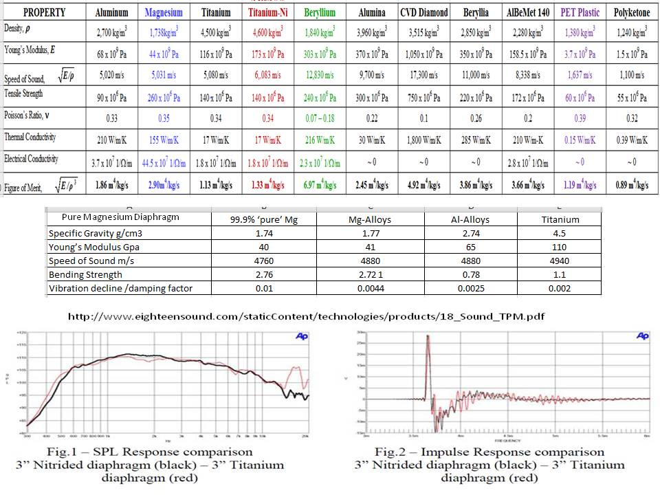

Have you/anyone heard the JMLC-350 with a compression driver that uses either a plastic or magnesium diaphragm? I am researching JMLC-350 with the 1.4" throat that use a plastic diaphragm compression driver equalized up to 18Khz.
From typical material analysis data, I am surprised that magnesium diaphragms are not more common for 3" diaphragms used in 1.4" exit compression drivers.

A cursory look at the graph you printed shows something that I have seen many times with titanium, its tendency to have high frequency breakup modes. I see the same thing in POS graph of the aluminum vs Be diaphragms in the Radian drivers. It shows as a rise in output at high frequencies and also as that rather rough decay plot of the impulse response.
This is the major reason in my eyes not to use titanium in high frequency devices, what many will refer to as fatiguing when listening to music. I can imagine that many manufacturers would not want to work with magnesium due to the flammability issues during manufacture. It is not an easy material to work with and even in aerospace it is now seldom seen being replaced by carbon composites where weight is an issue.
