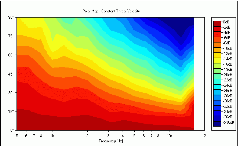

And then posted simulations, rather than measurements, am I correct in assuming you have not measured the actual polar response of the horn (or woofer) you are using in the "Beyond the Ariel" prototype?
I measured the polar response for the AH425 for this paper:
Attached is the measured polar response and the simulation.
What Lynn showed, is the near field pressure map. It is not a directivity map as such.
Bjørn,
Thank you for answering the directivity questions posed to Lynn regarding the horn he is using in his prototype speaker, the near field pressure simulations he posted previously were of no use (to me).
It is clear from your measurement that the AH425 varies smoothly (other than some waistbanding at 1000 Hz) in its -6dB dispersion from around 120 degrees at 500 Hz to 40 degrees at 10 kHz.
Using the AH425 would make for a high frequency variation of 6 dB across my couch, too much for my taste, but not terribly beamy.

I am not sure what you mean by a "pressure map".
The thing is that I am disinclined to post in this thread since it is clearly an attack where "facts" don't seem to be important. I'd just as soon not get too involved.
