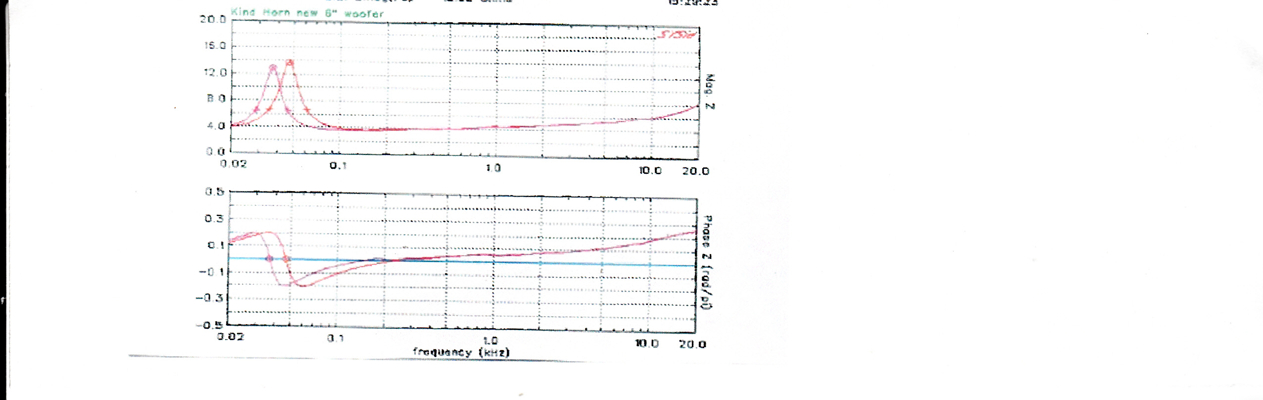

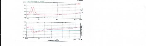

Here is a set of plots from the 6 1/2" cone driver I am working on. This was done independently by a friend of mine and sorry for the poor quality of the scan. It shows how well the impedance and phase response with no correction is possible. The double trace is because this was a mass added test to determine Thiel Small values. This speaker has no impedance correction added to it, this is strictly the raw frame driver and the speaker was not broken in yet so the resonance frequency is actually lower than it appears here on the graph. Broken in it shifts down to about 35hz fs.

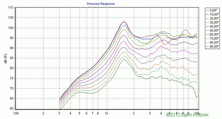

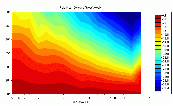

How is the LeCleac'h horn any different than the constant directivity waveguides near the crossover region? Both are radiating into an angle defined by the horn.
In terms of radiating patterns, the only difference between the LeCleac'h and a constant directivity horn is the HF direcitivity, say above 1 or 2 kHz.
Hello,
One main difference between a Le Cléac'h horn and waveguides is the smoothness of the pressure field it induced (perfectly shown in BEM simulation) and which is reflected, both in the smoothness of the response curves at any angle and by the smoothness of the polar curves at any frequency.
After Earl Geddes gave IR of both an OSWG without foam and an OSWG with the foam plug, it was clear (at least for me) that the interleaving of the responses curves from -30° to +30° were due to diffraction Inside the waveguide (and most probably at its throat which is the part at which the first and second derivative of the profile of the waveguide are maximum see : http://www.diyaudio.com/forums/attachment.php?postid=1789598&stamp=1238488590 ).
Best regards.
Jean-Michel Le Cléac'h

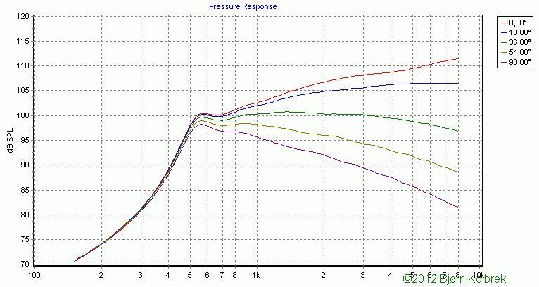

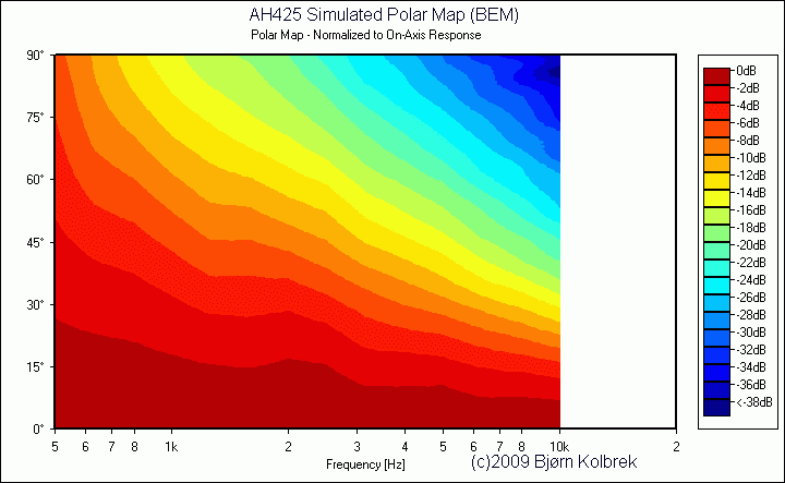

And then posted simulations, rather than measurements, am I correct in assuming you have not measured the actual polar response of the horn (or woofer) you are using in the "Beyond the Ariel" prototype?
I measured the polar response for the AH425 for this paper: Simulation of the acoustic field of a horn loudspeaker by the Boundary Element–Rayleigh Integral Method. Attached is the measured polar response and the simulation. The measurement data is exported from Arta so as to make the figures visually more similar for the paper, and since Arta only allows 1/3 octave data to be exported from the polar plot, it's somewhat coarse. But the AH425 has very smooth variations in polar response, so the differences would not be large in most of the frequency range.
What Lynn showed, is the near field pressure map. It is not a directivity map as such.
Bjørn
Bjørn
It is about time that someone pointed that out. But you should also point out that the polar plots for the OSWG and the AH425 do not use the same scale - one is in dB and one is linear. Why, if the AH425 is so great, is it necessary to cheat on the data when it is presented? I also assume that the OSWG has a sharp mouth edge, or some other feature that no one would actually do in practice because a good OSWG does not look like what you show.
Hello Earl
Thanks I was wondering what was up. I just didn't make any sense to me that those could be "right". I even posted David's 4430 measurements as an example of what a good CD device should look like as far as the polar response trying to get clarification. I didn't realize they were pressure maps.
I have a question as I am not familiar with that type of measurement. Looking at the pressure map on the AH425 can they be looked at as an inverse to the directivity?? Looks like they are related or is it just coincidental.
