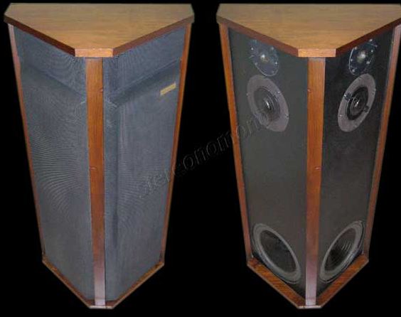

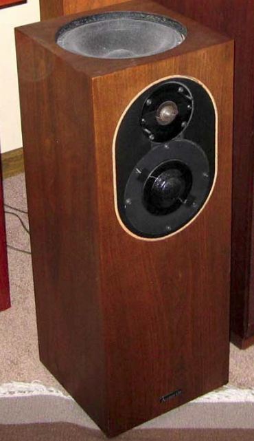

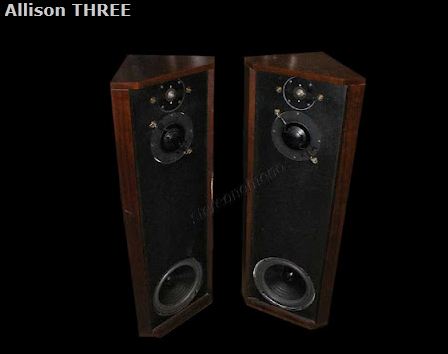

I have no doubt that tomtom's idea of building the cabinets into the wall is optimal, and I've heard the difference with Manger units in freestanding cabinets and (better) inset into a wall. Alas most of us can't go that far.
This made me think of AR's compromise, the AR-LST and MST:
But the guy who went even further was Roy Allison. The idea was to couple the bass as closely to the wall as possible, to avoid dips in output. Other noteworthy ideas were to have an optional "concert hall" rolloff of about 5dB in the treble and use acoustic suspension, which sounds more natural. I include some Allison models (One and CD-8, Three and Four) to give you the idea. These are solutions for flat wall, corner and bookshelf respectively. FWIW, crossovers are simple L and LC sections AFAIK.
This may be off-topic, but interesting, I hope.

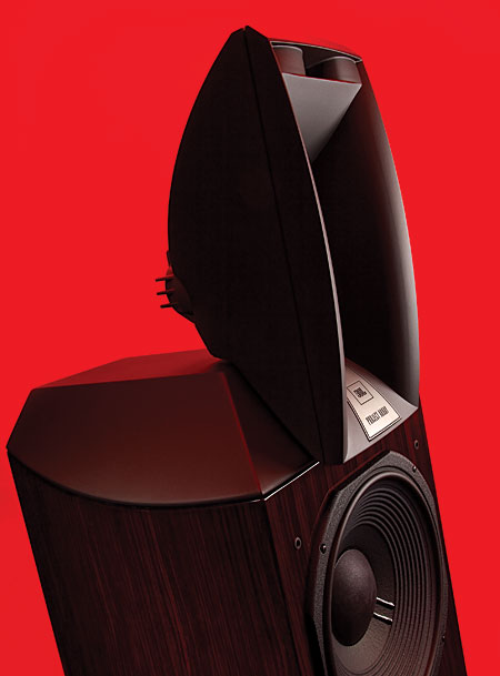

Moving to the JBL Synthesis, well, the horn is pretty different. The AH425 combined with a large-format Radian 745Neo or Altec/GPA 288 requires no in-band EQ at all; I'm seeing 2-meter on-axis response curves flat to +/- 1dB, and an impulse response that is 0.5 mSec or less. I believe the JBL constant-directivity horn requires a fair amount of in-band EQ, but I have little knowledge of the JBL crossover, and have no idea of the impulse response of the overall speaker system.
I'm seeing figures around 99~100 dB/meter/watt for the new speaker, which is short of the all-horn-system figures of more than 103 dB/meter/watt, but not bad for a direct-radiator, and well-suited for moderate-power vacuum-tube amplifiers. I don't really think single-ended 45 or 2A3 amplifiers have enough power, but then, I tend to think of 1~2 watt amps as headphone amplifiers. Remember, even Paul Klipsch toured the USA using a Brook 12-watt amplifier to drive his demo Klipschorn, and Klipschorns are about the most efficient hi-fi speaker ever manufactured.
