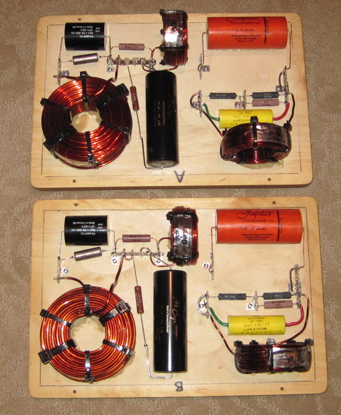

One last distraction, then back to our regularly scheduled programming:
Note the inductor orientations in our crossovers are nearly identical. Admittedly, I only used measurement, not my ears (they would fail me), but it appears there is safety in numbers. If addressing the question of pickup from the voicecoil/magnet, you also get a third dimension (vertical spacing) to play with, making it even easier.
Caps are glued with a flexible RTV, instead of the foam idea.

Very similar, and a lot better than what you see in high-end $80,000 speaker systems.
You also have the good taste to avoid those awful-sounding flat-pack inductors. Why anyone ever got the idea that packing an inductor with nasty-sounding plastic between the layers is a mystery to me. A conventional air-core inductor wound with (relatively) oxygen-free wire has almost zero (subjective) coloration, which is a lot better than nearly any capacitor. Not sensitive to microphonics, either.
Use good-quality wirewound resistors with a generous power rating and you are good to go.

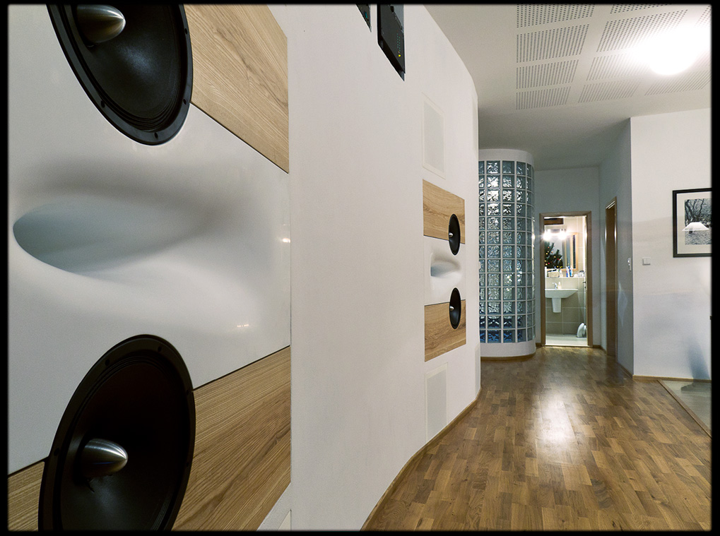

Hi these are TD12M - and horns are custom - with build in Toe-in. Part of toe in is curvature of wall and part is in horn. Speaker baffle you see is 120x100cm.
There is also 4x 15inch per side for lowest octave. - under the cloth grills.

Hi all,
Firstly Lynn, i hope that you are comfortable with publishing detail about my system in your thread. When its problem i ask moderator to move it.

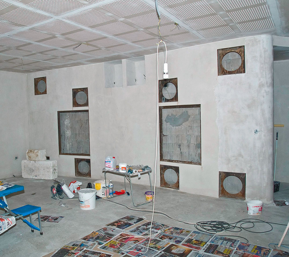

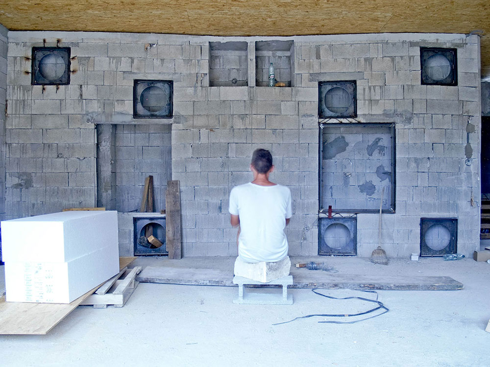

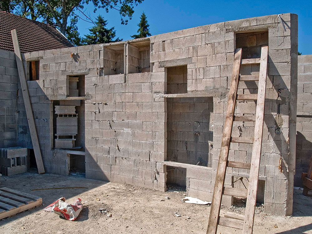

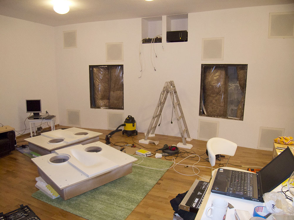

System was build-in in new house. Actually it is house around speaker. The listening room is also main living room with kitchen as i dont want to separate from family. This room has no parallel walls. Its about 7x6x3m /W/D/H/ Wall are concrete but roof is light wood construction transparent to everything below ca 150hz - this was to suppress some of room modes. Room is normal furnished and only ceiling is threated with absorptive dry wall + ca 20 cm mineral wool. The room is reasonable live.
Speaker wall is hollow wall with internal volume about 1800L per side. This serve as enclosure for bass /subbass speakers/. Wall is 10cm concrete with steel reinforcement. This wall is also structural part of house as it support roof. Main cabs are MDF.
I was quite busy with house building that i havent much time to take photo.
I attach some photos that i hope are clear enough.
The biggest compromise i made was that room and listening position isnt totally symmetric in room. It was due other purposes of room. I was hoping that side walls are far enough and system directive enough to not to be a problem and i was right.

System is working in progress. I have not final amps. I was experimenting with STW /i canceled it after 1/2 year/. Its not decided whether i use DSP or analog line level. It was planed analog - i dont need delay - horn has exact depth i need to delay compression driver. But so far i dont see DSP as bottleneck. With final AMPs i will see. I listen only digital no turntable. Mostly classical. Oh, XO is 50 and 500 ca 48db/oct but quite assymetrical.
