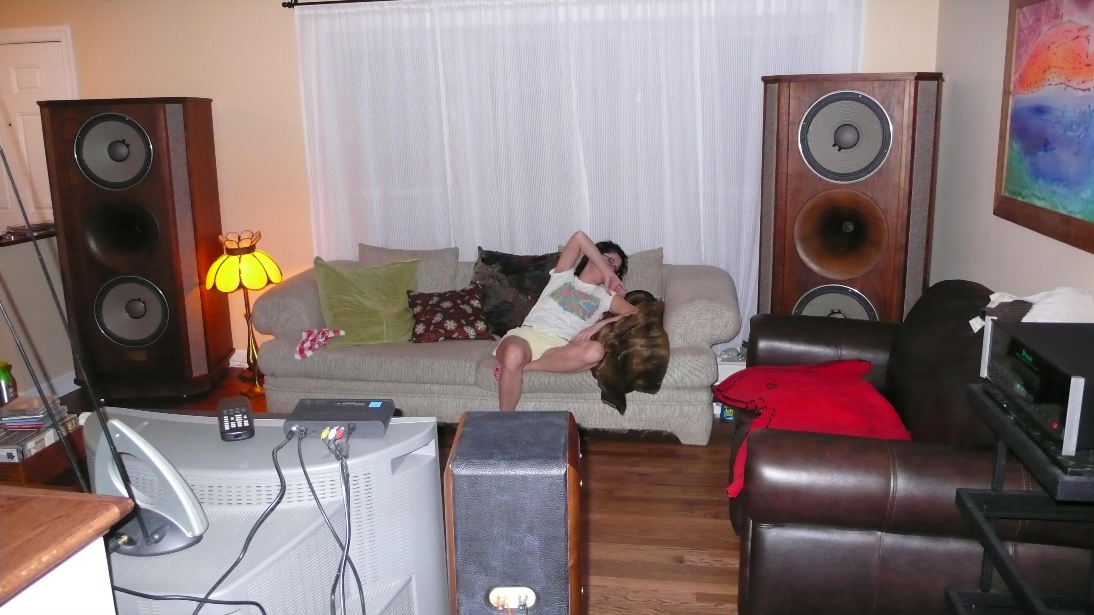

I had a first listen in disorganized room with my fiancee running for shelter:D
Big, tight , bad sound. Impressive and confused would be the word . It's funny how my girl commented on the woofers performance (she's got bat's ears) ..."they do sound little different don't you think" Well, I said... Lynn said the lower ones are diffracting from the floor:whacko: I will be parting them out next month.. but in the meantime I will enjoy simple redneck pleasures (Fleetwood Mac playing)

Man, those things are BIG! I can see why she's trying to escape!

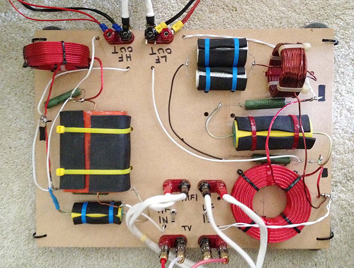

Here's my Ariel crossover - not beautiful, but functional, with all caps tied down. The tweeter crossover is on the left side, the midbass on the right. The input switches select between the Marantz home theater amplifier and the Karna high-quality amplifier. The crossover board is elevated from the rug by small foam circles cut from pipe insulation.
The B fields from air-core inductors spread out several inches - my rule of thumb is 90-degree orientation away from each other and at least 3~6 inches of spacing between inductors. Crossover is external (for microphonic reasons), no ferrous screws are used on the crossover board, and if there is an enclosure for esthetic reasons, it is made of wood or plastic, not aluminum (eddy currents) or steel (nonlinear inductance and unwanted interaction with air-core inductors).
The crossover is spaced off the rug a couple of inches on foam pads to damp vibration and prevent the wires underneath the board (which are the independent star-grounds for each section of the crossover) from snagging on the rug. I keep it at least a foot away from metallic amplifier chassis, or other large bits of metal.
Yes, I have wire preferences, but they're pretty simple: industrial Litz wire with cotton-cloth covering. Litz wire can be tinned and soldered with a solder-pot. If 2 feet of wire sounds different - in any way - than 20 feet, you're using the wrong speaker wire. Likewise, if the wire has to "burn in" for days or weeks, that's the plastic dielectric slowly losing the DC polarization charge that was created by manufacturing stresses. Ditch the plastic and get rid of burn-in hassles for good. If you're worried about triboelectric effects and self-motion from induced currents, better to let the wire move free than contain it in a high-Q resonant plastic straightjacket. Think about it: which is more resonant, tightly wrapped plastic (just like a plastic cap) or dead-soft copper in a Litz-wire bundle in a loose cotton sleeve?
One nice thing about Litz wire is there's no strand-to-strand current flow, thanks to the enamel coating of each strand. So even if the wire moves around a bit, it doesn't matter, since there's no strand-to-strand current flow and associated distortion from copper-oxide corrosion on the surface of each strand.

why we're discussing outboard crossovers, it reminds me of something that sometimes bothers me. Inductor orientation relative to loudspeaker voice coils and magnets - is this just an imagined problem or is it real?
It's fairly simple to validate your orientation, too. I just excite coil 1 with a low AC signal from my function generator, and coil 2 is connected to the scope input. As you move coil 1 (or 2, depending on your preference) and change orientation and distance, you can clearly see which condition provides for the lowest pickup.
The final plus on the side of type 2 Litz wire, which is what you have on hand, is what is called "proximity effect". Basically, to induce a 60 Hz power grid signal, you have to drape the cables across a power transformer. Power cords are ignored, nylon carpets are ignored, RFI is ignored until gigahertz, it even works perfectly in low signal level interconnects as long as three meters with no shielding.
