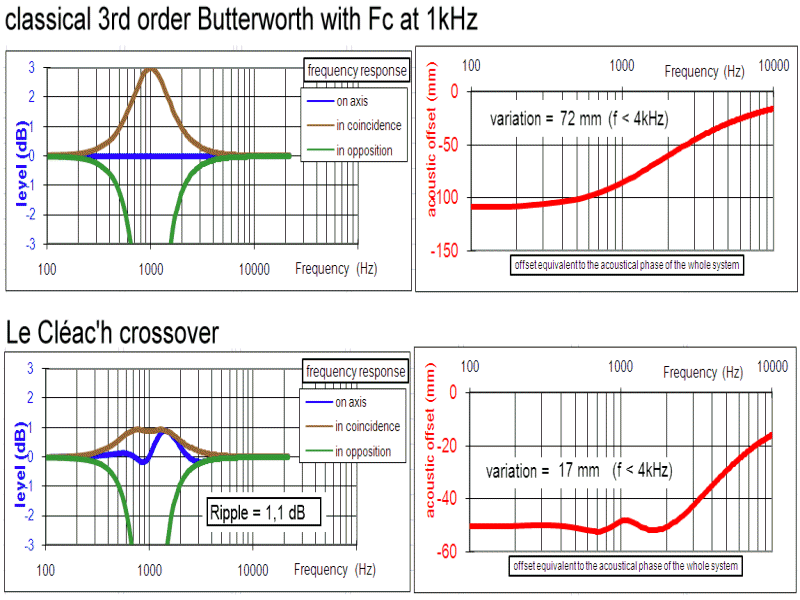

Hello John,
No, in my method the first arrival time are not perfectly aligned as you erroneously say.
If you use my spreadsheet (the link of which has been given previously), you'll see that there is still a minor group delay difference between the bass and the HF.
See attached file: the comparison between a classical 3rd order Butterworth 2 ways with Fc 1kHz and the equivalent Le Cléac'h croossover.
The in "coincidence" curve is very near of the response curve indicating a very good in phase operation between the waves emitted by the 2 loudspeakers. (an horizontal "in coincidence" will indicate a perfect in phase operation of the 2 loudspeakers).
But look at the variation of the group delay (expressed in equivalent distance travelled at the speed sound) between the classical Butterworth and the Le Cleach: 72mm of varition for frequency <4000Hz for the Butterworth, 17mm of variation for the Le Cléac'h, indicating for that one an increased phase linearity.
Above 4kHz the phase of the tweeter is for sure progressively tending toward 180 degrees but this is inaudible IMHO.
About the very low frequency why one would care if his tweeter is not perfectly in phase at -40dB level or so, with the bass loudspeaker...!
It is far most important IMHO to consider the interval of frequency wher the 2 loudspeakers have a significant SPL and in that range, with the Le Cleac'h crossover the 2 loudspeakers operate with very low phase difference.
(BTW, I don't set up the crossover using square waves, I used pulse response and phase curves, group delay curves and CSD... square waves are given in the document because during discussion in French forum, many people asked me to give them in order to compare with published square waves ... )
Many people use my crossover in a 3 ways systems and my spreadsheet is devoted to 3 ways systems...

Let me summarize what I see. You have a crossover with ... It is not phase coherent or transient actuate. For the case you are discussing the crossover frequency (in the power point presentation) is 1 K Hz. The HP and LP in the filters you mention are not in phase at all frequency below 4k Hz.
The part of the spectrum you claim to be in error, above 4k is also misleading because the presentation looks at a 125 Hz square wave for which the majority of harmonic content is below the crossover point. Move the crossover point lower, as would be required for a 3-way, or the square wave frequency higher, and the distortion become clearer.
The crossover can not be transient accurate because one driver must be connected with inverted polarity. Again, this, aside from the fact that the attack of any transient is in the wrong direction, introduces a NONLINEAR, frequency dependent delay of the form 1/f. Note, 1/f behavior is not linear, though it is stated as such in the power point presentation.
I accept that your crossover approach may be useful for improving the characteristics of 2-ways systems but it is not appropriate for 3-ways.
In any event, there is another problem with using offset to time align. Since the acoustic centers are purposely misaligned and do not lie in, or close to in the same plane, moving off axis in the horizontal direction causes loss of the alignment.
