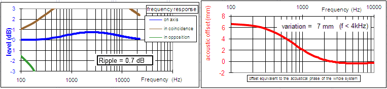

Hello John,
I can see that you didn't give a look to my spreadsheet for a 3 ways system. That's not the common little tool that you can see to calculate crosssovers for cars... It solves completely in the complex domain the calculation of the response of the 3 ways. The influence of each cell of the crossover (LP, BP, HP) on the others is perfectly treated.
As an example give a look to the attached graph which one shows the response of a perfectly aligned 3 ways system using only 6dB/octave crossover at 800Hz and 8000Hz. You'll see that a +0.7dB bump appears in the medium and alos that the group delay shows some variation (small but real. It is equivalent to 7 mm variation of the equivalent distance travelled at the speed of sound). This is due to the influence you mentionned of one cell of the crossover on the other.
Now about your remark about what happens with real loudspeakers. I prefer in that kind of discussion to separate what is related to the crossover itself and what is related to the loudspeakers themselves. IMHO the crossover is the weak element when we pay attention to phase distortion.
That doesn't mean that in my designs I don't take care of the phase non linearity of the loudspeakers themselves. (It is the opposite actually and since long time I developped under Matlab and used my own tools to analyze the response of real loudspeakers including phase and group delay... In the document I mentionned you'll find real measurements on multiways systems...)
But, as my philosophy is influenced by the "KIS" concept (keep it simple), the solutions I used for myself are generally based on loudspeakers (+ load) used in an interval of frequency inside which their own phase non linearity cannot mess the "theorical results" of the Le Cleac'h crossover.
But I know many people who are using my crossovers with less linear loudspeakers, adding phase equalizers, amplitude equalizers... often I helped them to optimize their set-up.
You said yourself that we have to "define a target" and then to bring some modification to the original design in order to reach that goal. That the same here. I define the target as the behaviour of a quasi-optimal crossover then I study the means to reach that goal.
We are here in a thread devoted to Lynn's project. Do you think Lynn will use a complex crossover with phase equalizers added, etc. In a first approach I guess that's Lynn will try the simplest KIS optimal crossover: the 6dB/octave. I hope it will succeed in that but I have some doubts. It is also doubtful that Lynn will appreciate digital crossovers. That's why the KIS philosophy of the Le Cléac'h 3rd order crossover could be interesting. With exactly the same number of passive elements as the classical 3rd order Butterworth it brings audible ameliorations:
- good linearity of the response curve
- good "in phase" operation of the 2 loudspeakers in the interval of frequency around the common cut-off (define at -5dB for the Le Cléac'h crossover)
- quasi constant group delay below 4kHz
For a passive 2 ways crossover it needs only 3 capacitors and 3 selfs.
Best regards from Paris, France
Jean-Michel Le Cléac'h
