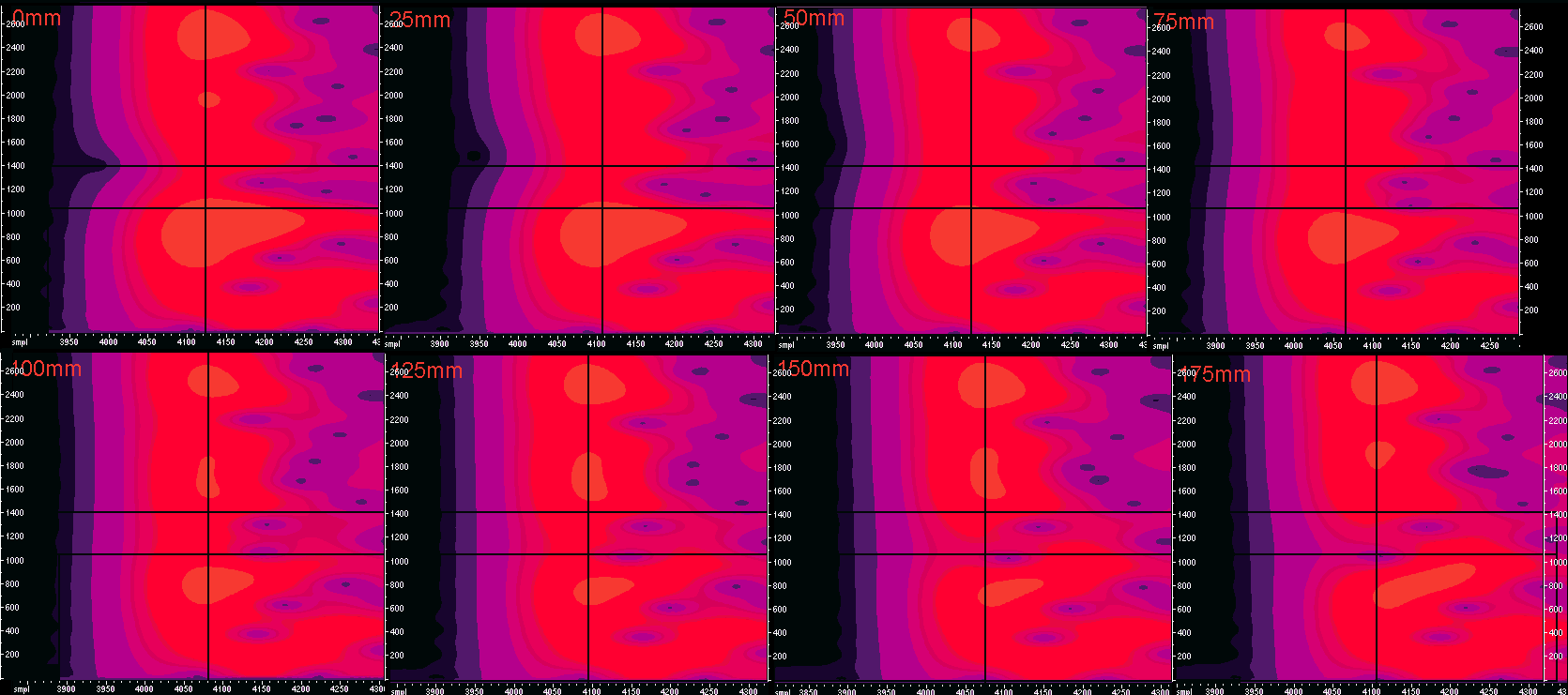

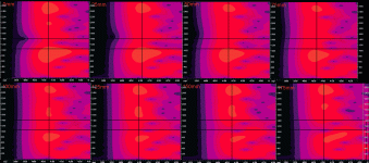

Hello,
A good tool in order to refine the alignement is CSD or spectrogram.
Here attched an example from my mesurements.
In that case the optimal alignment is obtained for the graph labelled "100mm"
Best regards from Paris, France
Jean-Michel Le Cléac'h

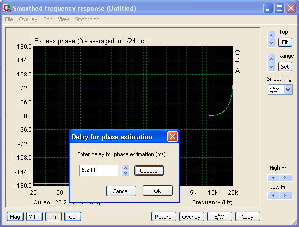

Acoustic centers are not always at the voice coil, for sure - but how do you measure them? I'm not talking in theory, in practice. I can measure the offset with the auto-align of the DCX2496, but where and how is it measuring? Phase and offset can also be measured with HOLMImpusle ( and other softwares) but how to know where they actually line up?
The practical aspects of measuring phase and time alignment are worthy of a long thread.
It's pretty easy with ARTA to at least get relative offsets if not absolute acoustic centers. It lets you plot excess phase and you can adjust the time you subtract from the impulse response until the excess phase is flat and near zero at the crossover frequency. Do that for both drivers and the difference in the two times is the AC offset.
