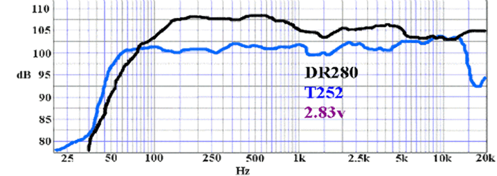

I think what you guys should consider is using
DR280 (size 24" x 24") from around 130hz up to 1000hz. I just guess that a horn lower mid may integrate better with an AH-425 than open baffle.
From 130hz and below, use BudP's designed cardoid sub and rotate it 90 degree. So, it will sit below the DR280.

If very uniform directivity is not your first priority (I remember it's not), then you might take some bigger than 8 incher drivers for, say, 300~1kHz. 10 or 12 inchers in small open baffle can cover this range with very little EQ, so there won't be a bank of OP amps. Sensitivity can approach 100dB/w. Dynamics, headroom sort of things will never be an issue.
2 x 15 inchers cover 300Hz and below will need some EQ and/or some more power, but no big deal, either. EQ requirement will also be very small for the 80Hz target, or even none if high Q drivers are used. (If more EQ is tolerable, then this portion should be capable of reaching 30's.)
If the ragged responses of K-horn, A5... etc. can be accepted because of the 'right' things they do, then there'll surely be a doable way in between them and that 'over-engineered' Orion -- a much less EQ'ed, coloration-free, still highly sensitive and dynamic, and almost fullrange system.
Of course there're so many faults everywhere, but in reality they are not that bad as expected and all can be dealt with. If box/panel resonances are so annoying and can't be tolerated, then OB is the only way!

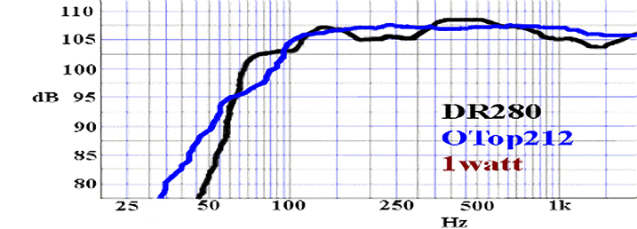

Here's an interesting thread comparing the OmniTop 12 to other BFM models - at the end, there are graphs comparing the DR280 to an OmniTop 2x12, with both models using the same drivers. (OmniTop with dual 12-inchers in blue, and a DR280 with a single 12-incher in black. Both graphs normalized to 1 watt, not 2.83 volts.)
By the way, an OmniTop 2x12 is not a large or particularly heavy speaker, measuring 28"H x 22"W x 18"D and weighing 60 pounds, which includes the weight of a pair of Eminence Deltalite-II 2512 drivers. At 106 dB/metre/watt, efficiency is in the Klipschorn range, with much better flatness. With Altec, GPA, and Radian large-format compression drivers 110~111 dB efficient (requiring only moderate attenuation), a SET with a single 45 power tube would be an entirely practical power amplifier.
