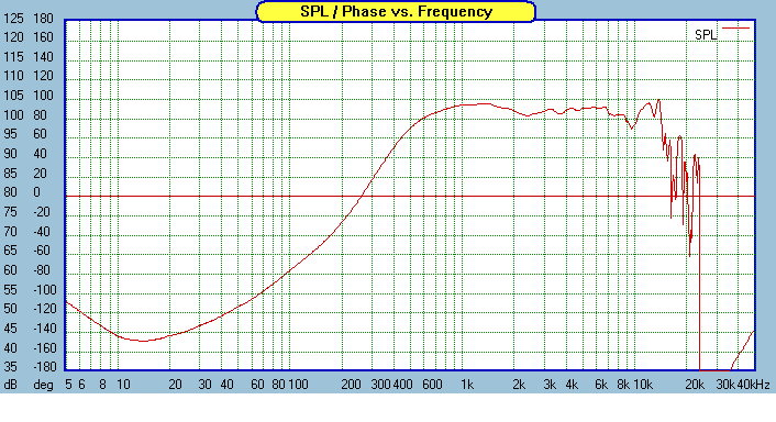

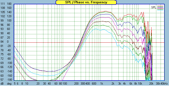

Augerpro was kind enough to measure the second GPA 288 on the AH425 horn - and as you can see, it measures differently. (All measurements at 2 meters with no equalization.) This measurement is much closer to Bjorn Kolbrek's measurement of his Altec 288C on his AH425 horn, so the previous measurements of the GPA 288 may indicate a problem with that particular driver.
I'm no horn expert - but I'd guess the phase plug might be misaligned with respect to the diaphragm, producing the broad rise centered around 1.5 kHz and the two sharp nulls at 2.8 and 3.6 kHz. The first driver has a smoother characteristic in the 1~10 kHz region, with the diaphragm breakup region above 10 kHz looking very similar.

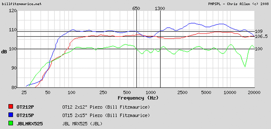

Here's the reason I've been poking around the Bill Fitzmaurice site - the OmniTop 15 and 12 look like interesting complements to the AH425. The upper graph is the dual-15 OmniTop 15, and the lower graph is the dual-12 OmniTop 12 (these are fullrange speakers, but the part I'm interested in is the basshorn).
Note the efficiencies of an OmniTop15 and an AH425 with an appropriate large-format compression driver are in the Klipschorn range, with much flatter response. True, the F3 is around 70~80 Hz, but everything below that is direct-radiator subwoofer territory anyway.
The reason you don't see FR response measurements of Klipschorns and Avante-Gardes published is that they aren't very flattering - rough would be the kindest word that applies. By contrast, with a good large-format compression driver (GPA, Altec, and possibly the Radians), the AH425 horn, a 700~900 Hz crossover, and 12+15 or 15+15 BFM OmniTop, a speaker with efficiencies in the 105~109 dB range and reasonably flat response looks eminently possible.
This kind of problem looks like a resonance of the air around the voice coil. It was quite common for older drivers but with time designers learned to control it.
Very possible - it's in one driver but not the other, so something isn't right with the manufacturing process. The Tangerine phase plug, unlike traditional circumferential versions, is a plastic assembly glued into the machined throat of the compression driver. My guess, and it is only a guess, is an installation misalignment or a residue of flashing left on the assembly.
The near-identical responses above 10 kHz - which can almost be overlaid on each other - tells me that the diaphragm resonances are very similar. Maybe one of the diaphragms is misaligned; that alone would affect both distortion and the frequency response.

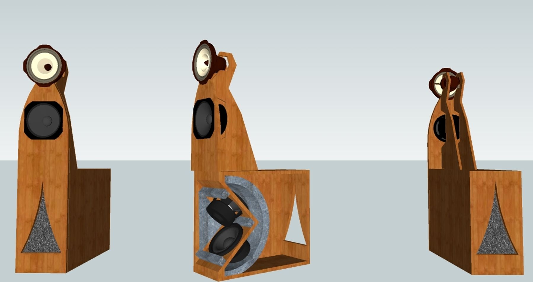

Gary's cardioid bass chamber has directly influenced what will be the home for the Lowther. Only 46 inches tall and with just enough bass to suit my environs. Should begin in about three weeks and I will actually have someone around who can cut wood closer than my +- 1 foot.
Bud
