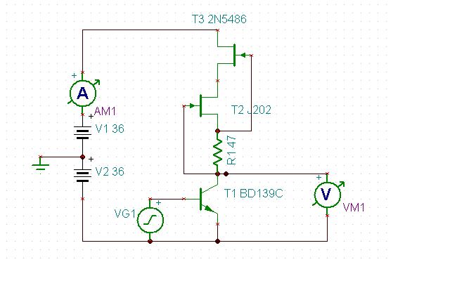

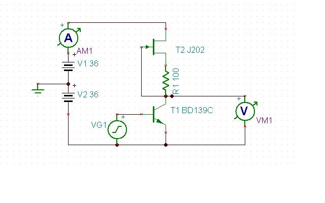

Has anyone bothered to actually simulate a VAS with these various CCS's? I'm doing that now and I'm finding that some of the ones with higher rejection cause higher distortion in the output. Sometimes, in spite of really high gain for some them, the distortion is lower. It's not clear to me how this is working. Further, with an ammeter in series with the VAS, the rejection is a certain dB below the output level and not an absolute value. This one, for example, has huge distortion with huge rejection (over 100dB).
And this one does not. Go figure. I don't know why yet. I mean, the difference is 100 times in distortion for the same input and in spite of the fact that this one has more gain and is running at about the same current as the other one. This one has about 70dB of gain and the other one about 30, and the other one has far more distortion!

I tried replacing the voltage generator with a current generator and I can't get it to function. I get negative gain.
If I drive the lower gain circuit with more voltage to get the same output as the higher gain one, the distortion will be even greater.
Replace the current source load with a ideal current source. Adjust the current to center the output voltage (it will be very sensitive). Continue to drive the base with the same source you use for the other circuits, reducing the drive voltage to restore the same output signal. We're trying to answer the question: What is the effect of the current source load?
OK, thanks. I am doing that but I get strange results. If I try to lower the current to make the collector near zero volts, the gain goes way down and distortion goes up. Sometimes, I get a collector voltage that is more than the battery supply! I think Tina is confused... I don't have time now to mess with it.
The ideal current sources in most simulators don't care about what voltage they are referenced to. I just connect mine to ground, unless the current does flow out of "both ends" in the given circuit, despite the violence to intuition. So yes, you can get arbitrarily high voltages.
