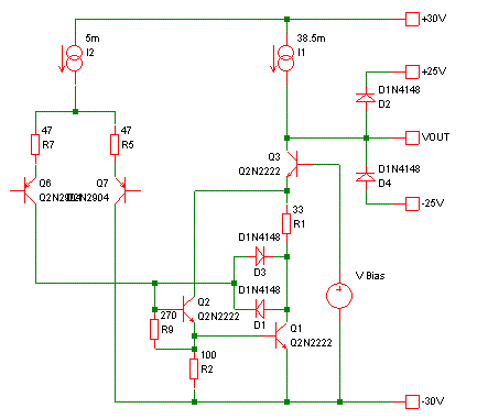

Regarding function of R1 "magic" & clipping control
I guess it does, but that wasn't a design consideration. I expect that allowing voltage swing on Q1's collector actually makes distortion a bit worse, especially as Vce is so low to start with. I considered that a small price to pay in exchange for civilized clipping behavior though.
Just reading through this thread so I refer here back a couple of months
Are you assuming imperfect CCS operation for R1 to have any effect as "magic" resistor ? presumably the higher impedance the CCS the less effect R1 can have . . . or is it called "magic" because any effect would seem impossible ?
No magic.
Those comments were referring to the circuit below. R1, D1 and D3 are for current limiting. Someone else asked if R1 was a "magic" resistor (to reduce thermal distortion), but that's not why it's there.
Maybe you thought the comments were referring to R1 in the other circuit?

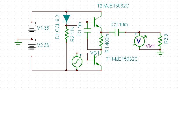

Well, I got to thinking and fooling around. Two power transistors in SRPP formation. One watt into 8 ohms with about 1.5% distortion. Not terrible, but not outstanding either. Given that at the time there weren't any good complementary transistors, I guess this was not too shabby.
