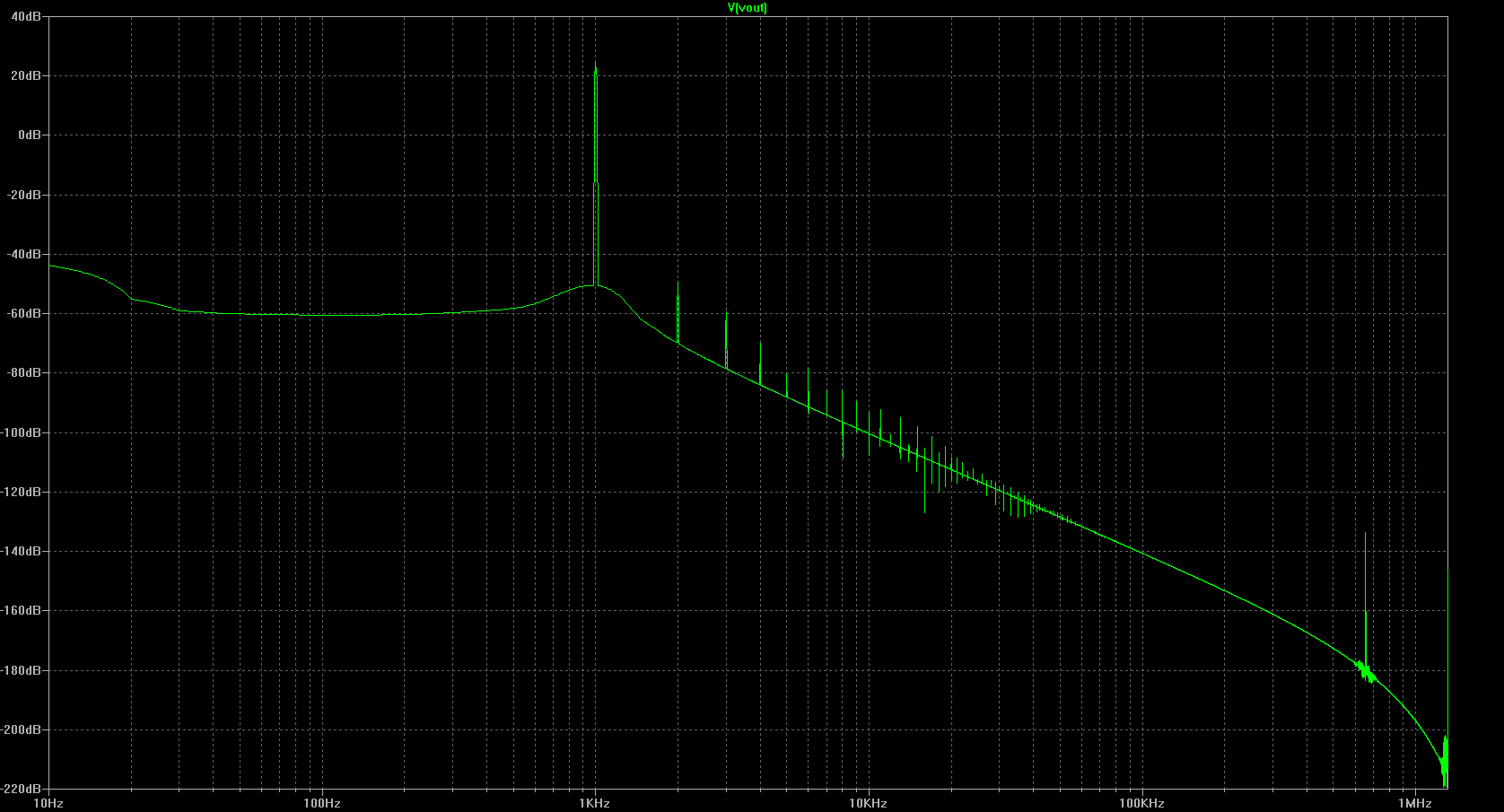

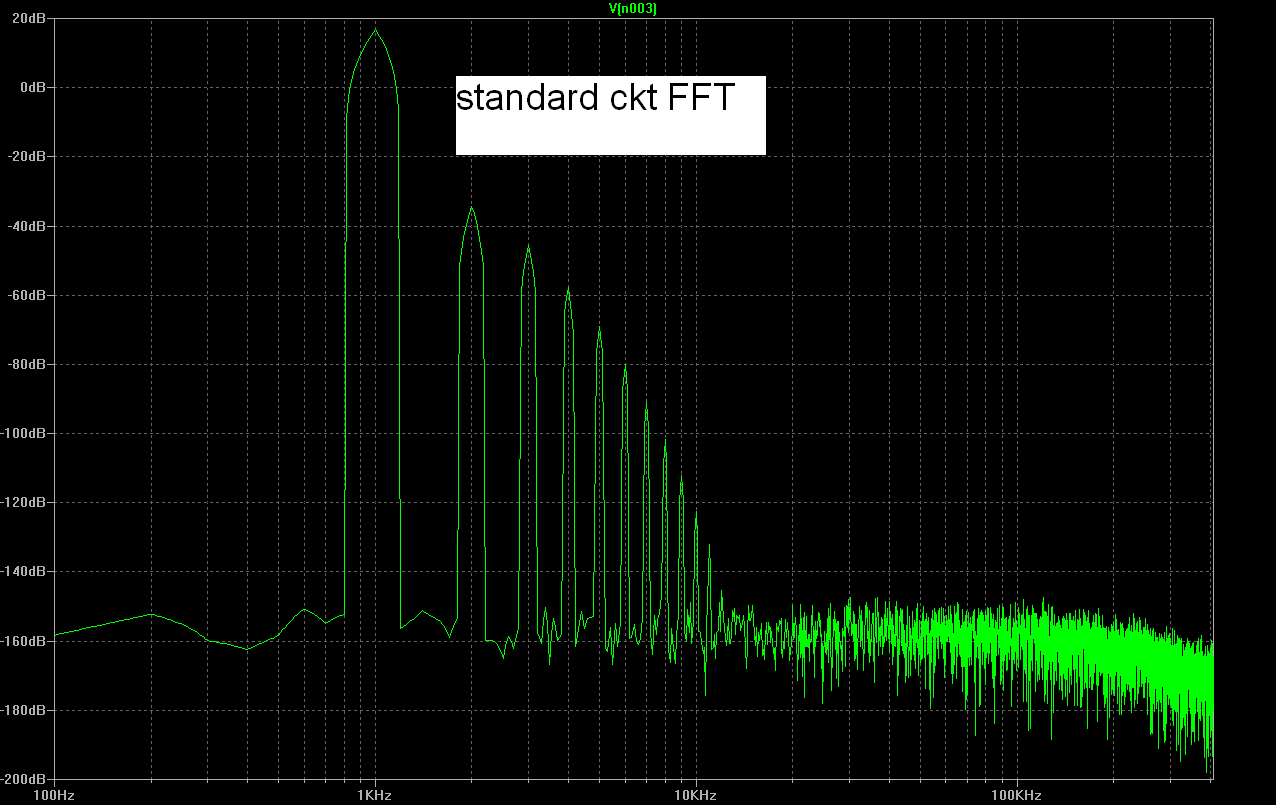

Here's a favorite of mine...It's based on an old patent by Milt Embree. Notice from the plots how wonderful the suppression of the high harmonics is. I've made both stages with about the same total current in the 500 Ohm resistors, and pretty much the same gain.
I have never put this in an amp as a Vas, but I've always figured it could be a good performer.

Are the voltage sources in those models zero impedance? It would be interesting, if so, to see the predicted performance with some impedance in series.
It does look intriguing though, with the input device's current rising with the positive signal and with what amounts to a current gain of two from the mirror, something I've done with sets of cascaded mirrors. I'll have to study it further. Thermal distortion looks like a (soluble) problem.

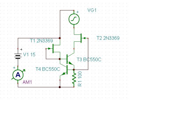

Lazy Cat CCS 1a

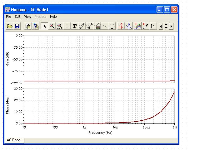

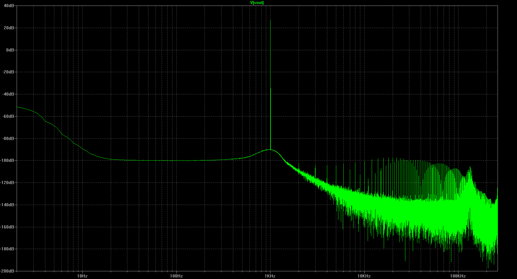

Hi Lazy Cat, here are the results from my sim of your circuit 1a. It has really great bandwidth, but only about -95dB of suppression. There always seems to be a trade off between bandwidth and suppression (or negative gain I guess you'd call it). I don't know which is better or more desirable.

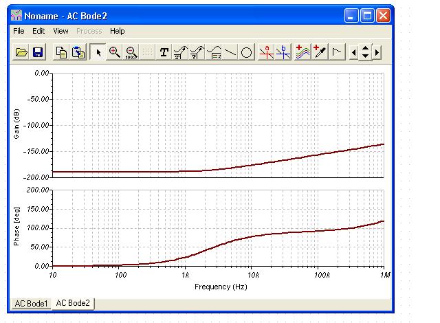

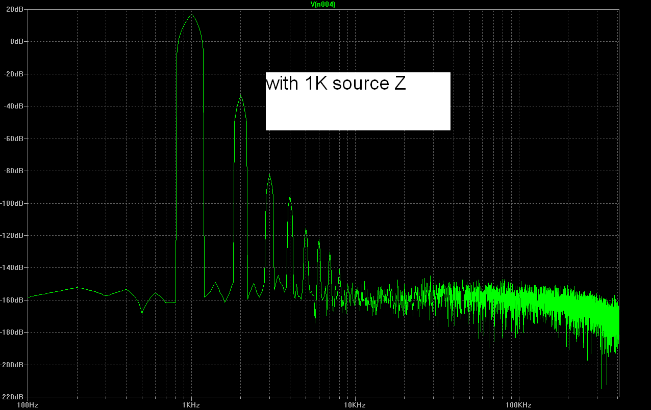

Here's a sim with 1K of source impedance.
As I suspected the circuit has high frequency peaking with that source impedance, easily tamed with a capacitor to common at the input (for my sim, about 5.6pF flattens things nicely for a 1k source resistance).
Unfortunately it looks like reducing thermal distortions is incompatible with the basic distortion spectrum behavior. There may be yet a way. One observation: the distortion is associated almost entirely with the lower quad of devices, and the common base stage contributes little by comparison.
The nondegenerated current mirror will worsen noise performance, although depending on its location in some overall circuit, this could be a small effect.
Oh shoot, I screwed up sorry. I had the wrong jfet's in there. This is screaming good.
Dirkwright, thanks for the sim.
Yeah AC performance is extraordinary, will practically test it soon.
Today I played also with this CCS, its stability/thermall independency is remarkable, certainly usable for many types of amps.

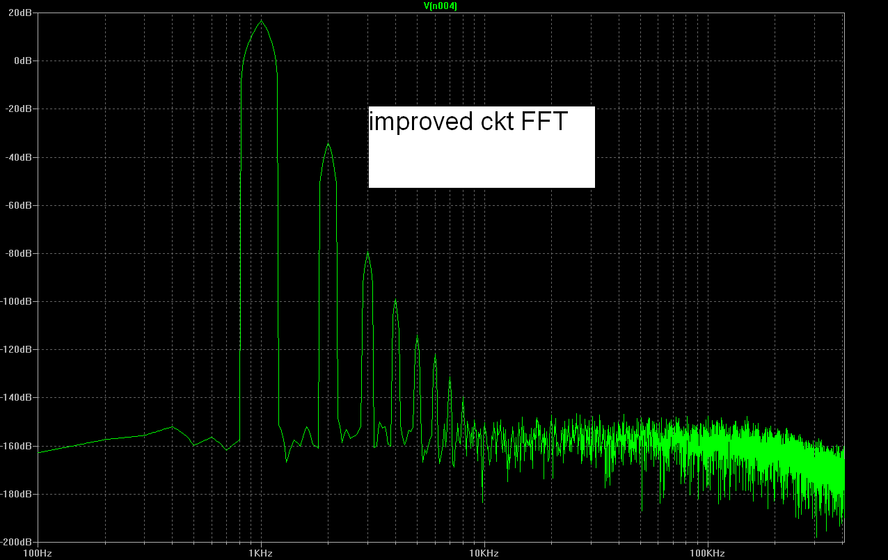

Simulations indicate some very promising results, especially considering the large current swings as a fraction of quiescents, and the falloff of higher harmonics is preserved. Almost worth building!

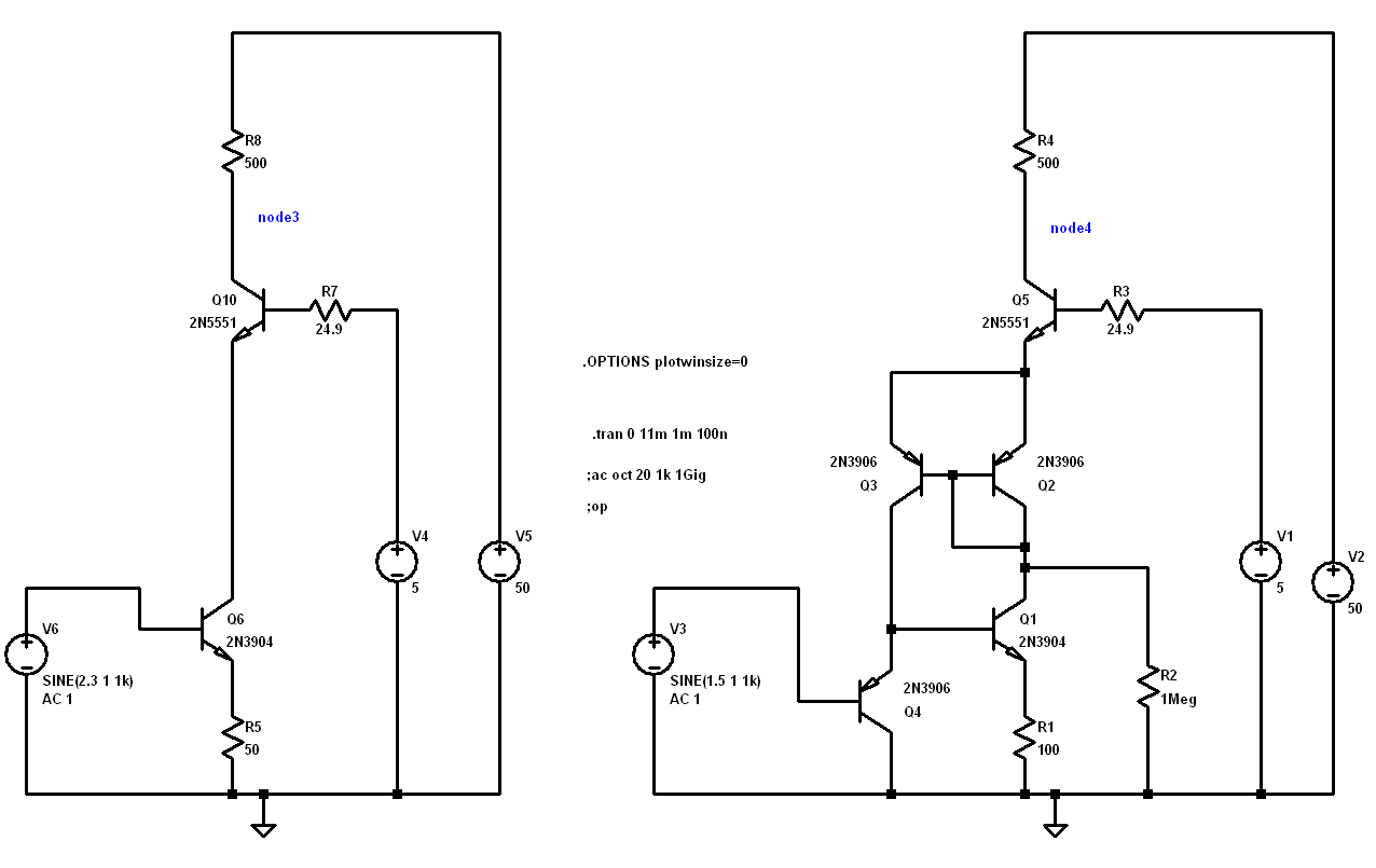

Example after Embree
The plot of the distortion spectrum is a bit difficult to read because of the obscuring grid lines. I've marked the 3rd with one of the cursors, about 98dB below the fundamental of 1kHz. 6th is at about -135dBr. The signal in is 2V p-p, output 20V p-p. The results are for a unity-gain amplifier of some moderate complexity but of negligible contribution to the distortion for a 1kohm source resistance. The one I used has a bit of additional peaking due to a negative input Z component.
The dissipation changes of Q1 and Q2 approximately track with signal swing. E96 values are shown for resistors although some residual tweaking could help a little. The Boxall configuration (Q3, Q4) of the common-base output is not on the face of it particularly helpful for distortion, but does make the shifts due to beta changes in Q3 small.
Although I haven't finished playing with the frequency response, it's out around 70MHz for a low Z source (25 ohms, omitting the buffer amp) with a teensy bit of peaking. To get that performance in a build probably will require SM versions of most of the transistors and a very tight layout. Embedding this stage in an amplifier as a transconductance with capacitive feedback would also be intriguing.

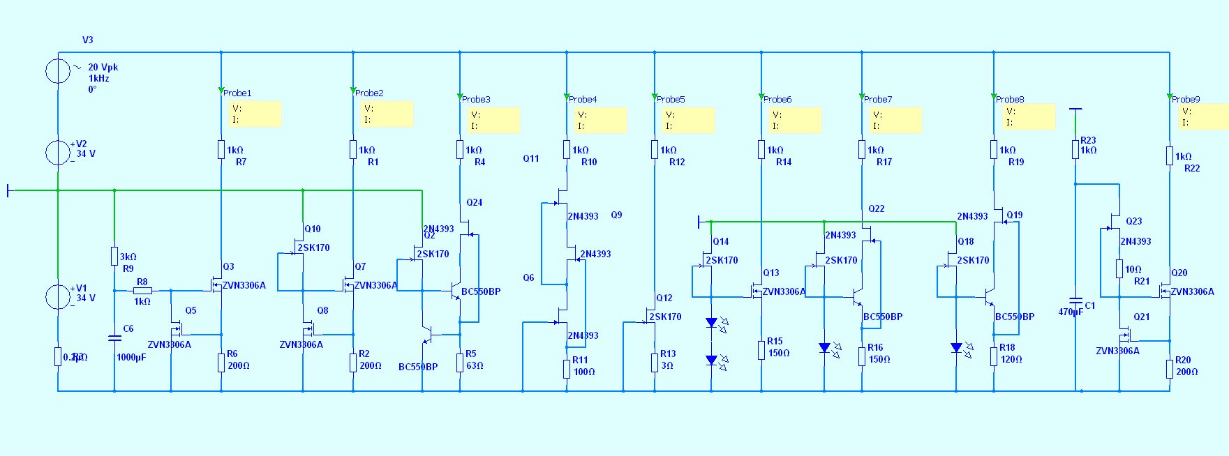

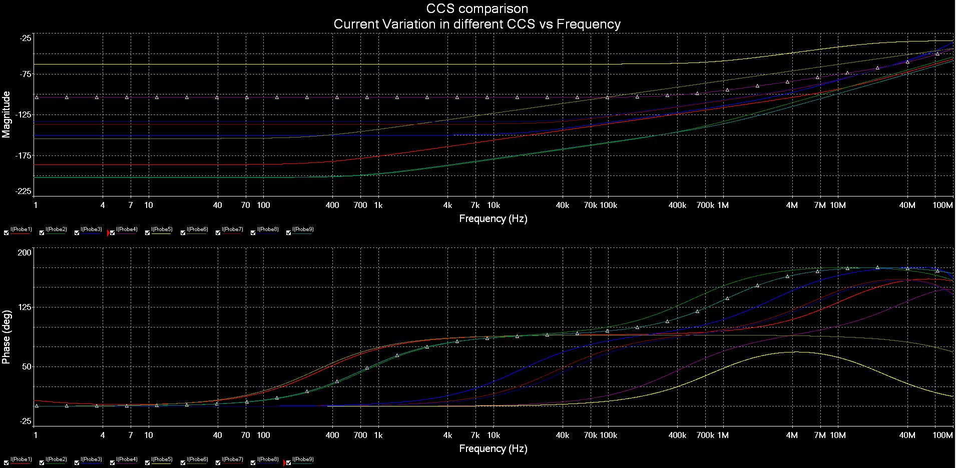

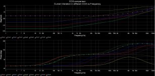

here is a plot of differnt current sources (led/Bjts and Jfet) and their output impedance's.. Common is that a jfet cascode or dual JFet cascodes really makes things a lot better....

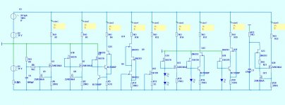

I Just found this post when it was referenced in another thread and decided to check the CCS in my DC linked fetzilla which I call "SMA" - Simple Mosfet Amp.
I was happily surprised that mine appeared out perform all of those shown so I went on to include all the designs I know.
I chose 10 - 12 mA as the constant current but as your Jfet design was not happy at that current I halved it.
Several of the designs I included appeared to outperform your design ( probe 4 ) but I suspect it was not optimised for this higher current.
The last design on the far right ( probe 9 ) was my best effort - marginally better that the one I am using which is also very good ( probe 1 )
I did try a Jfet o/p cascode on the probe 9 cct but when I actually spiced this in my amp cct in a transient sqaure wave test into 100nF + 8R load it make absolutely no difference so I dropped it again. The probe 9 cct also has excellent PSNRR.
I graphed mine differently - simply showing how well the CCS's resisted current modulation
p.s. Probes 2 & 9 results are similar colours and convergent until about 400Khz - sorry, that is not very clear
