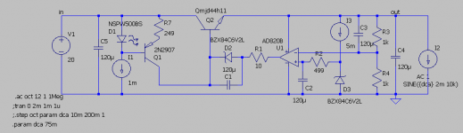

syn08 said:Guys, I agree that this little regulator is actually more complex than it appears at the first glance. There are literally hundreds of combinations you can build this, and here are a few variables I can quickly think of:
- Bipolar/MOSFET
- Polarity (NPN/PNP or Nchannel/Pchannel, with flipping the opamp inputs)
- Reference type
- Current source to feed the reference (yes, using a resistor to the output or a CCS like a JFET makes a significant difference)
- Ballast resistor or CCS
- Output cap value and ESR+ESL
- Reference bypassing cap value
- Reference bypassing connection (ground/output, yes it makes a very significant difference)
- Other bypassing (control input, like in the Minnesota shunt, yes, it makes a very significant difference).
If somebody with a simulator and enough time could try to optimize and find the best combination of the above, I would be the first to appreciate the effort.

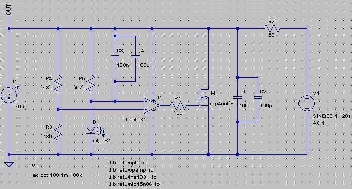

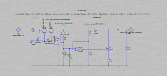

Hi Syn, perhaps I'm missing something. My simulation of this circuit isn't doing very well. I do like its simplicity.
syn08 said:This is how I'm wiring this regulator. If the regulator is in the same case with the phono stage you may delete 3 and the shielded cable T1, and simply star the output/sense and the grounds/sense at the low noise input stage terminals.
I guarantee that using this schema will improve the performance.
Re: Re: Wiring
What is the problem?

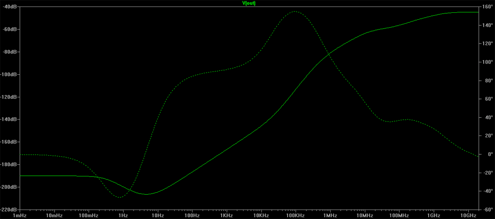

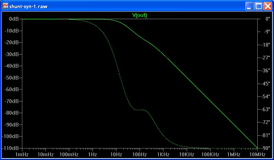

As long as we're simulating things, I thought I'd have a look at the improved Jung regulator. The output impedance is nice: below 1mOhm from DC to 4kHz, rising to 25mOhm at 96kHz.
onvinyl, nice result. Just in case, you might want to try inserting an LC filter just in front of the 22R resistor. I think you'll be surprised of the results. It does not matter how small the L and the C are.
salas, sure, I will post the result, although I'm not sure if people have any interest in that circuit.
Edit: here's the post where the result can be seen.

Quote
Compare again The minnesota uses a pnp and the opamp is flipped.. Why is the minnesota decoupling the divider up to the output?
Unquote.
The reason to place a cap across th e top leg of th e divider is so that the noise on the shunt output line is directly couled to the feedback input to th e op-amp. If you do not do this, the error signal is divided by the feedback ration - so in effect you have much less loop gain available to correct th e error signal. (Assumption: the cap is a low value compared to the parrallel resistor value).
Try this on your sims to see th e improvement.
Of course, you still have to use a value that keeps your sustem stable.
Refering to the Minnesota shunt reg schematic
1. They are doing what I mentioned in my 1st post - th e bipolar pass element is running in follower mode - so the output pole problem you get with a commom collector config is greatly reduced
2. They are using bipolars because they are much cheaper than mosfets

salas, sorry, I was playing around simulating onvinyl's regulator, which looks very interesting, but something is a bit off about it. If people show interest in our version we can open a discussion on it.
jwb, I would have to agree with you on the Jung regulator. It was designed and built by a professional. I don't have many doubts that whatever versions we simulate here are not as good, in reality, when the parts hit the board.
onvinyl, I can simulate just fine with the lt1115. If you don't use the alternate solver in the Control panel of ltspice, I would recommend turning it on. You can also set
.options reltol=1e-7 nomarch plotwinsize=0
for better accuracy.

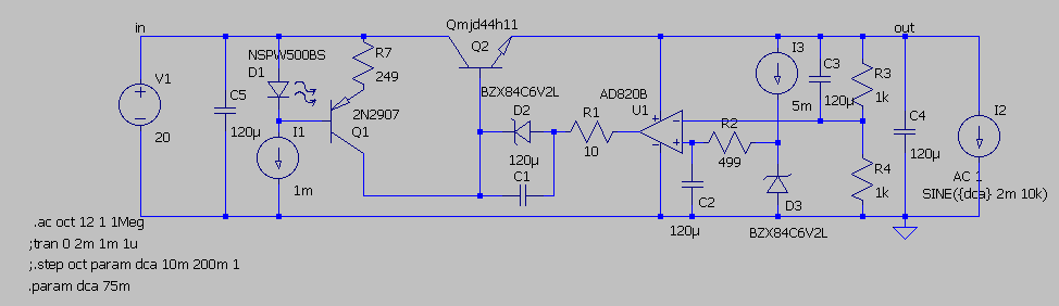

The Minnesota cct
1. uses a heavy 1000uF output decoupling cap - I also would use a big output cap because this means you can use a relatively slow, low noise op amp for the control element. This approach also makes it easier to use a slow bipolar pass element
2. C3 is the feedback 'coupling' cap I mention in my previous post - maximises the avaiable loop gain for error correction.
3. They have decoupled the reference quite heavily as I mentioned in my first post
