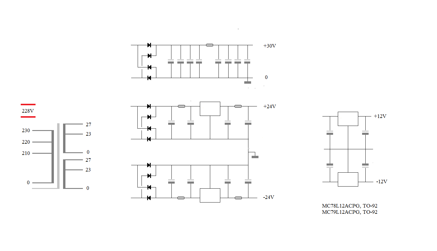

Staying with the humble LM317 Errol Dietz' NatSemi paper notes that output peaking problems from a poor choice of output cap is reflected into the input of the reg about 20dB down. And experimentation with input decoupling on a wide range of reg experiments has fairly well convinced me that the input condition really is quite important when chasing the performance you hope for - something with a hint of critical (resistive) damping is a very much more forgiving characteristic. In other words, a low raw feed Z, with immediate input decoupling constituting series RC is potentially far more effective than merely 'a big cap' or 'a small HF cap' or other folkore fixes. This appears to me especially true when using a bootstrap / tracking pre-reg approach - the intermediate node between regs demands more consideration than it is often given. (here's something I wrote earlier, without any maths applied: http://www.acoustica.org.uk/t/3pin_reg_notes4.html)
And where this input decoupling returns to also matters. Ultimately it is decoupling the load, so it wants to return to the output load 0v return point - not the raw supply 0v input (if you need to knock-off incoming supply HF noise, do that separately before the reg)

what you suggest, is it something like in this direction ?

Tinitus, the input RC may work if there is a decoupling right in front of the R to chip ground. You can experiment by adding something like a 1R9+1u snubber at the input to ground right next to the reg. If you can use non-inductive resistors, try values for the R between .22R and 2.2R. Alternatively something like an amplifier L/R zobel could be placed at the input and this may allow for a smaller snubber.
I don't see much of a benefit from giving individual circuit their own regulators if they are analog class A circuits. I would put switching circuits like class AB drivers together on their own rail, and make a separate rail for linear stuff.
However the more current you can draw from the chip the better, as this will decrease Zout, so I would use as few chips as I could.
One way to think about it is, say a reg has 100mR Zout at 10mA and 50mR Zout at 20mA. You have two circuits which each draw 10mA. With both circuits on the same rail, you get double the reg loading, but half the reg Zout, so the rails experience the same voltage fluctuation regardless of whether you use individual regs or not.
Of course I don't know whether the chip reg follows the Zout rule this closely. It could be that it behaves this way only under 100mA and then flattens out above that point, in which case it could be better to use individual regs if the circuit draws over 100mA.

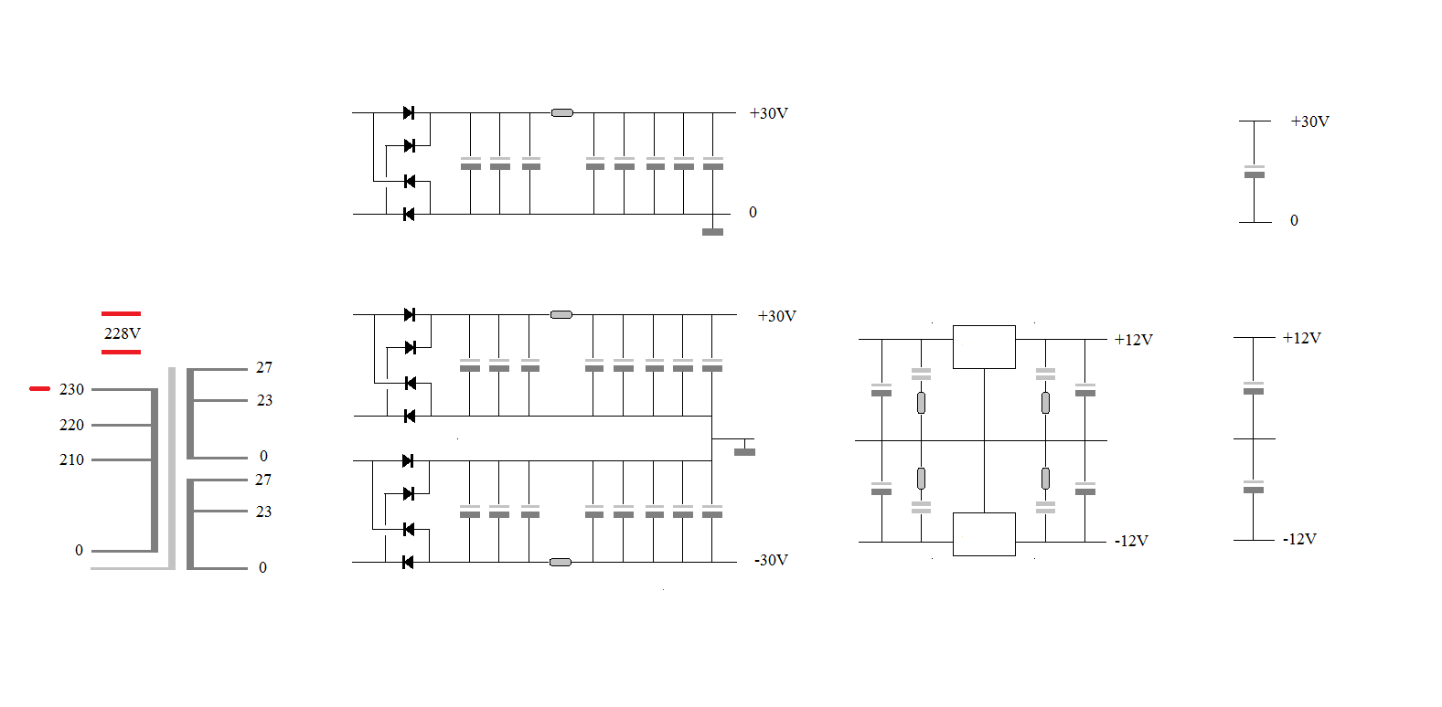

(not complete)

maybe to avoid too low impedance, causing instability at crossover point(peak/ringing)
but then, its also been claimed that a cap with too high ESR will do nothing, and pointless
funny, it now reminds me of speaker crossovers :clown:
Jackinnj is talking about ADJ not OUT pin. Output shortage to ground? We can install diode. I think diode is necessary because it is good to lower Zout with more caps at the output (its cheap). And not much can be gained from too much capacitance on ADJ pin either.
