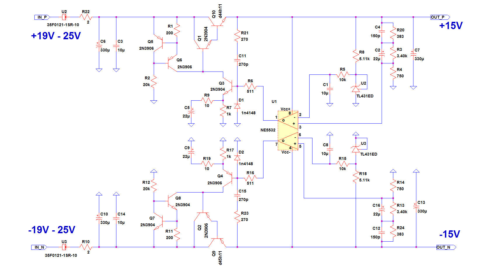

Ultra low noise series voltage regulator (stabilizator) +-15V.
Q1 and Q2 should have resistors to ground at the emitters to give them basic bias in case of low load current. Otherwise they will glitch on transients because the outputs will be horribly slow and very capacitive, easily saturating the drivers. Furthermore the dramatic reduction in Ft may destabilize the feedback loop and cause oscillation or resonance.
The D4xH11 are huge and slow outputs compared to the loading this reg is designed for. You will get better RF PSRR by using outputs suited to the application, which in this case would be something like the MJE150xx pair from ONSemi.

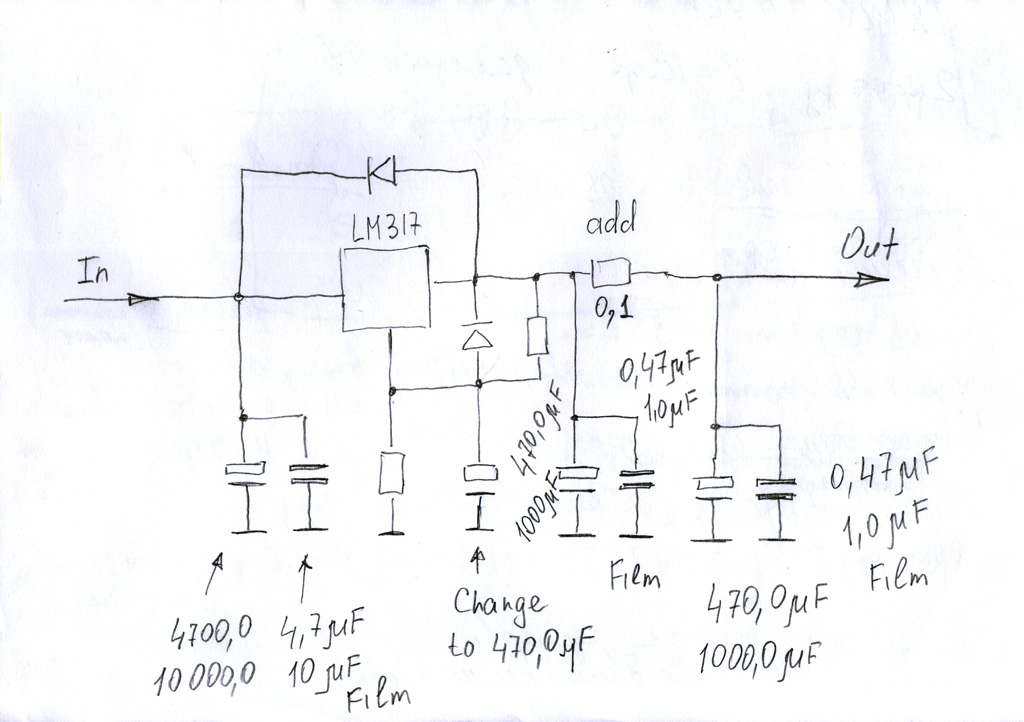

This is no good for low noise high quality audio applications.
If you use LM317, LM337 you may improve datasheet scheme.
If you are interesting, I shall write later how to do this.
You can do this.
