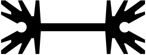

Hi salas,
I'm planning the dual mono version of shunts and I need your opinion on these:
- Because mounting 4 shunts on the existing chassis is not practical, I would like to use some board level heatsinks (see photo) that I already have. These are for TO220 packages, 35mm wide, 38 mm tall, Rth 11 C/W aprox. What do you think ? Is it adequate for Q4 (Q1 will be left bare) ?
- Fanos restocked GRs so I can use GRs for Q5 and Q6 as well. Should I use them or BLs are a better option for that positions ?
- If I'm interpreting things right there are 4 parts on the schematic. The current setting (R1,Leds,Q1,Q5,R4), the voltage setting (D1,C2,Q6,R5), the regulator bias (Q2,Q3,R3), the current regulator (Q4,R6,C4). The 2 last parts should be in close proximity (layout wise) ?
diyAudio Chief Moderator
Joined 2002
Hello,
1. For your current and voltage they seem more than OK for Q4. Q1 can be left bare in your situation, but a silly small sink like those for 7812 or 317 that just sit on air, supported by the semiconductor screw only, would make you feel better for long term reliability, given the Greek Summer coming with some heatwaves to boot.
2. BL for Q5, high Idss ones, around 10mA and over. Get a few GRs though so to stock Q6 for possible future shunts like those, because GR has the lowest pinch off under Vbe and that helps the under Zener CCS performance.
3. It better be compact as a whole.
