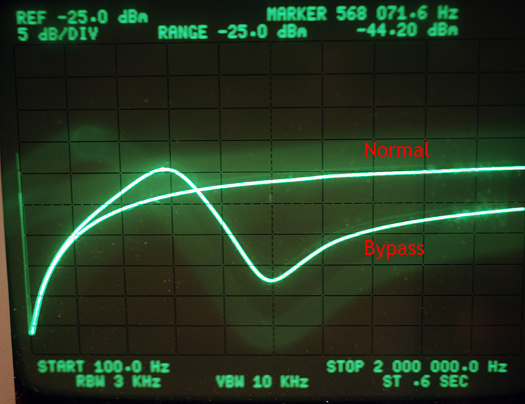

The picture below shows the impedance of 3 x 10.000 µF and the same 3 x 10.000 µF with 1µF MKV bypass.
I soldered two BNC cables to a split ground plane that holds the lytics and added the film cap.
BNC cables go to tracking generator 50 ohm output and Analyzer input.
That means, the caps shunt the signal to gnd.
Is this a correct setup ?
