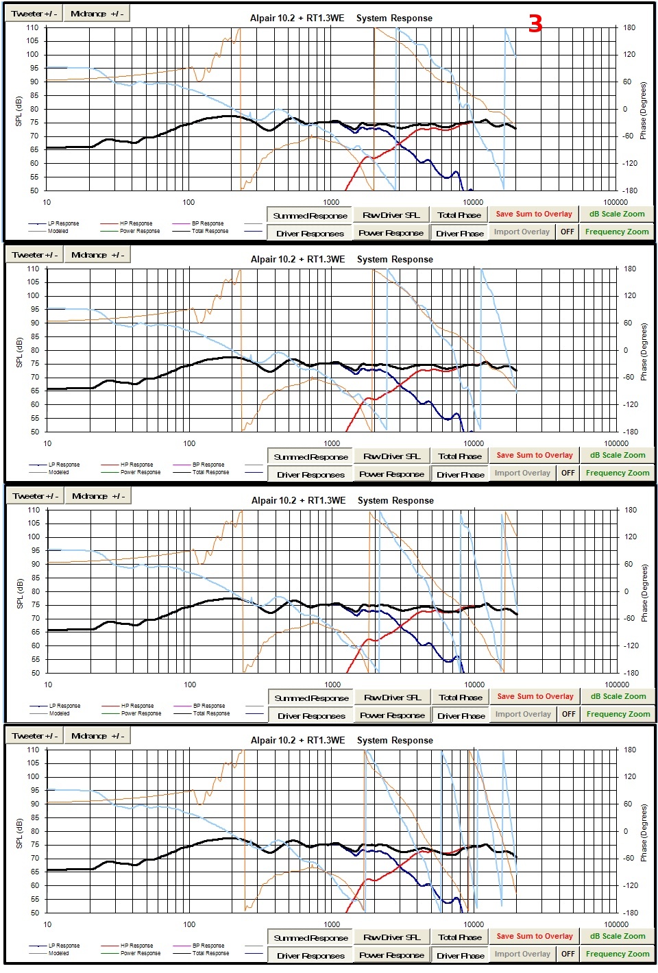

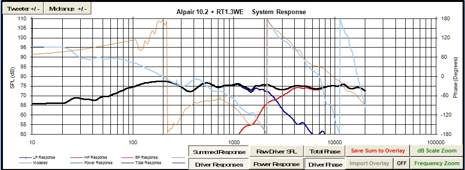

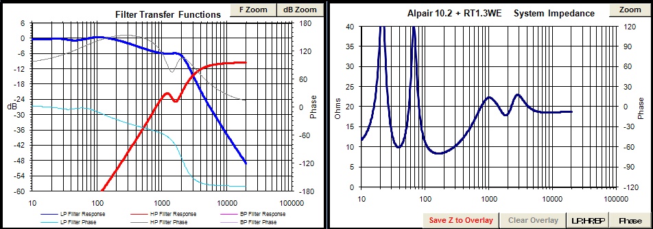

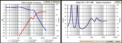

Here's a bit different crossover with better phase alignment at 2.86 degrees (shown). The summed system response line might not be quite as good but I take it some of you would prefer the phase alignment.

That looks quite fine to me!

Thanks Wolf
Scott, Dumptruck, Lojzek? What do you guys think, have I got it now?
Build it with the cheapest parts you can and then do a full range of tests outside and off the ground by about 8 feet. Models are often "off" by a bit when compared to measurements and usually need some refinement. Also do some listening tests to see if it has the in-room power response/tonal balance you are looking for.
Looks normal to me. You did lower the XO frequency and
the ribbon will receive more power at lower frequencies.

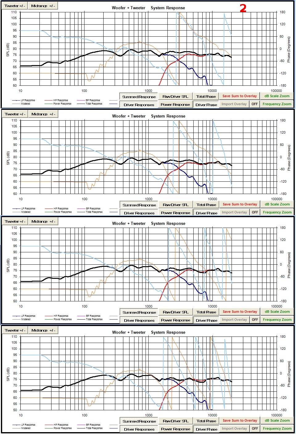

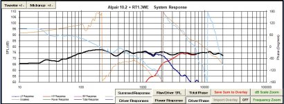

I've been changing all of the part values to try to do better - what do you think of this, better?:

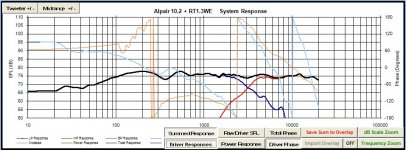

..and from a different point of view:
-worse.
Horizontal directivity will result in rather substantial suck-out around 1.5-2 kHz, and on top of that you have added-in some additional "lift" between 1.5 and 2.5 kHz. Result: listened to off-axis won't be linear, and listened to on axis will be fatiguing and "forward".
On the other hand non-linear distortion will be a lot better, but really - it's tough to hear any non-linear distortion unless you are playing them quite loud on average. (..Ex. I think I rarely listen to my speakers at much over 83db on average (at a little over 2 meters) with rare transient peaks over 6db.) It really depends on your own use.

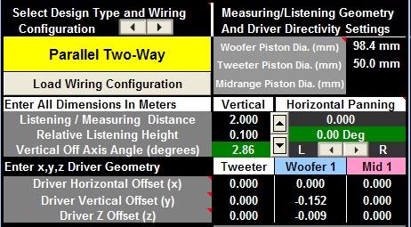

That was at 2.86 degrees I forgot to mention that. The last couple I've shown are 2.86 because that's where the deepest null is when the tweeter polarity is reversed.
That last one uses a few extra parts, a third order on the woofer and a notch instead of the contour, in an attempt to not have such a deep dip at 1.5k.
I've struggled to keep the rise around 1.1 - 2.4k in check while crossing the tweeter higher, it's hard to do!

Have you tried the filter in post #134? Better phase matching at
the same angle with improved linearity, at least in the simulation.
I don't think you need a 3rd electrical on the woofer. It introduces
an extra phase shift unnecessary.
Isn't it even better to have the vertical phase lines right on top of each other? Sorry I'm not an expert at reading the phase graph.
Not really. When you plot phase in a 2D plane, it just looks like it 'wraps'. When in fact, it is just needing to be plotted on a tube. The vertical lines in fact do not exist, but are the plots shifting from -180 degrees shift to 180 degrees shift- ie- the same phase point.
If the red tweeter phase and the blue woofer phase are not spread very far in terms of plot, not even looking at the 'wrapping', then they are in fairly close alignment.
If you have higher math knowledge, the derivative (calculus) of the freq response is the phase plot.

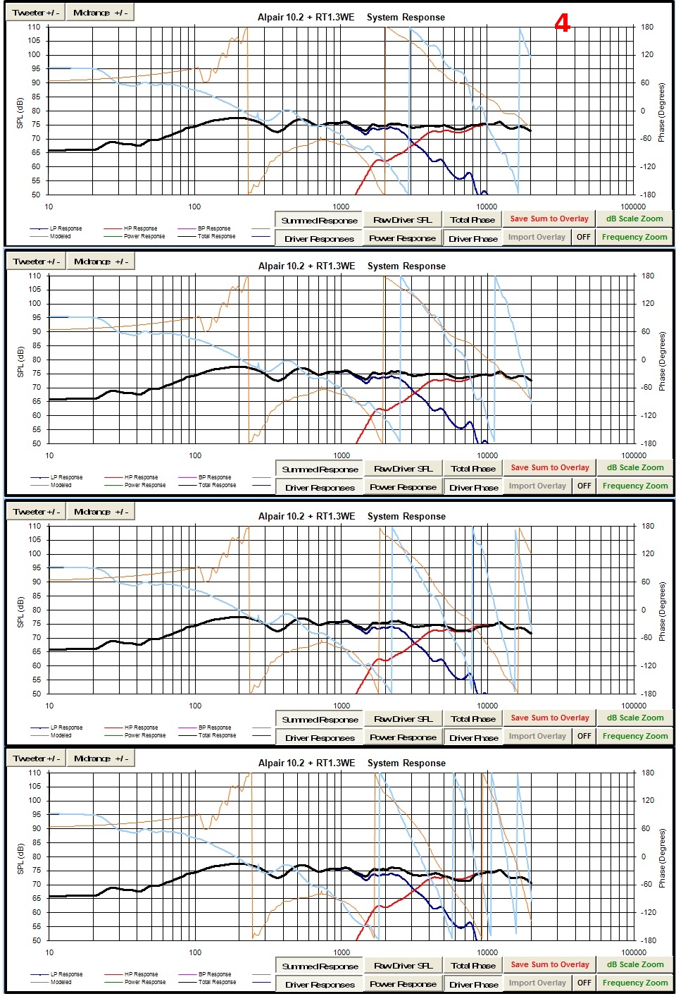

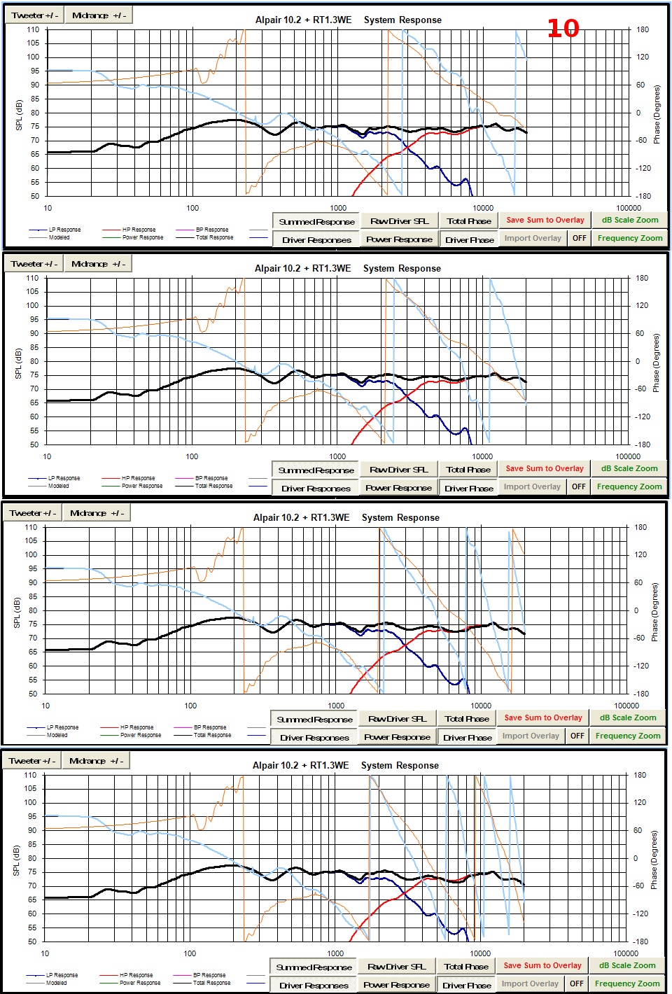

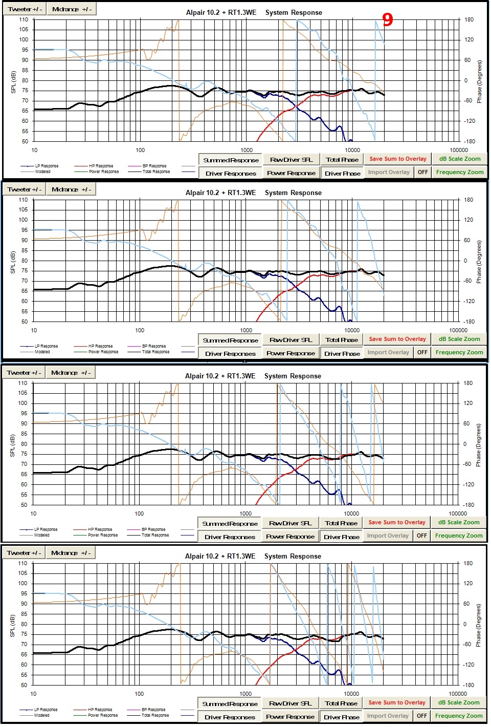

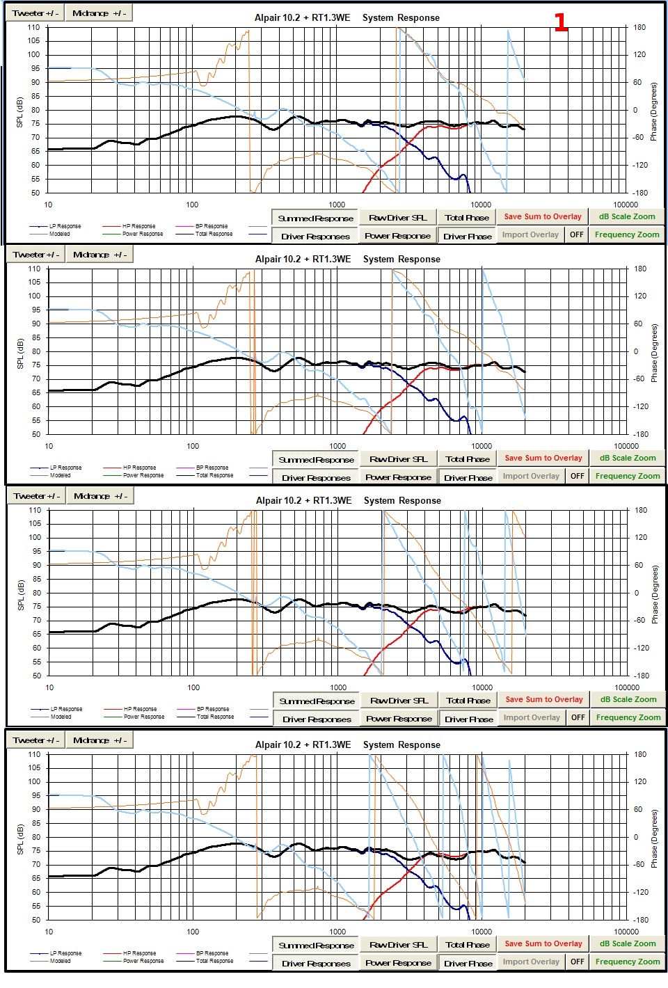

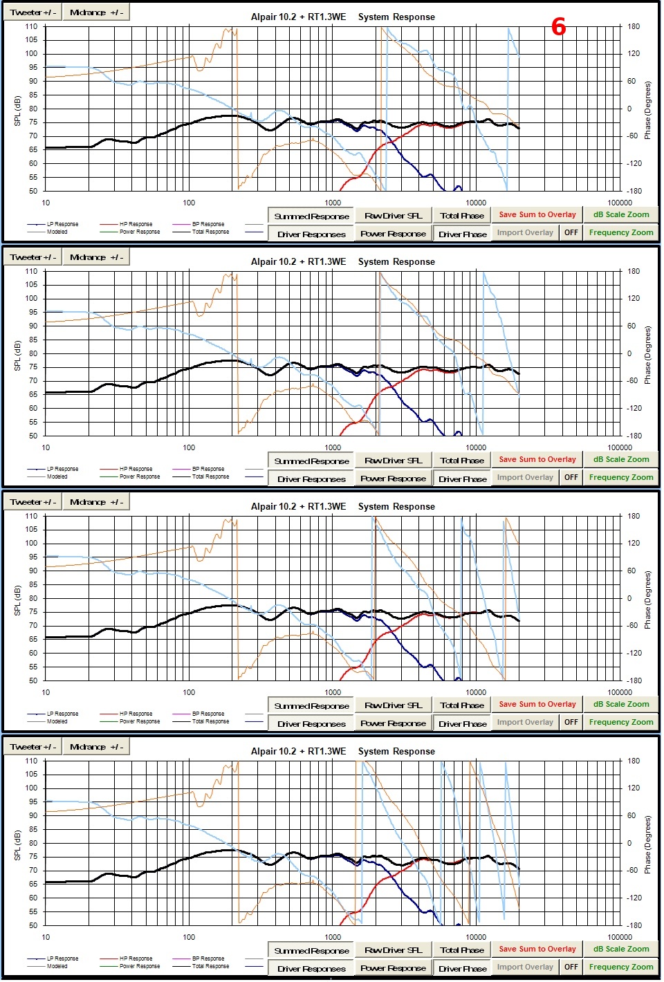

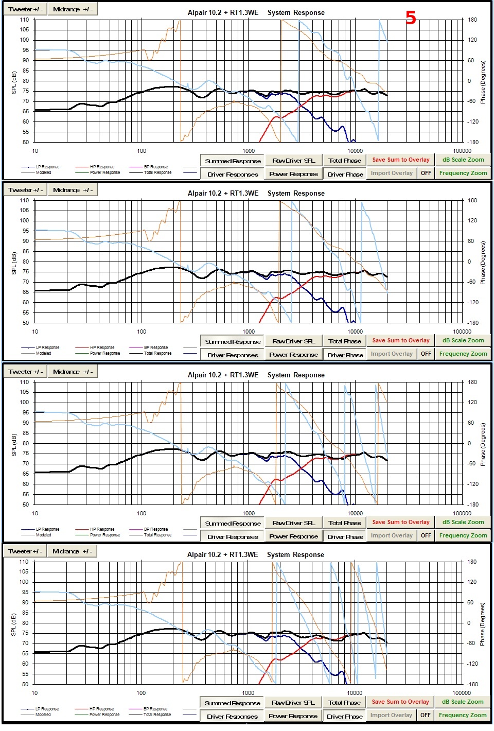

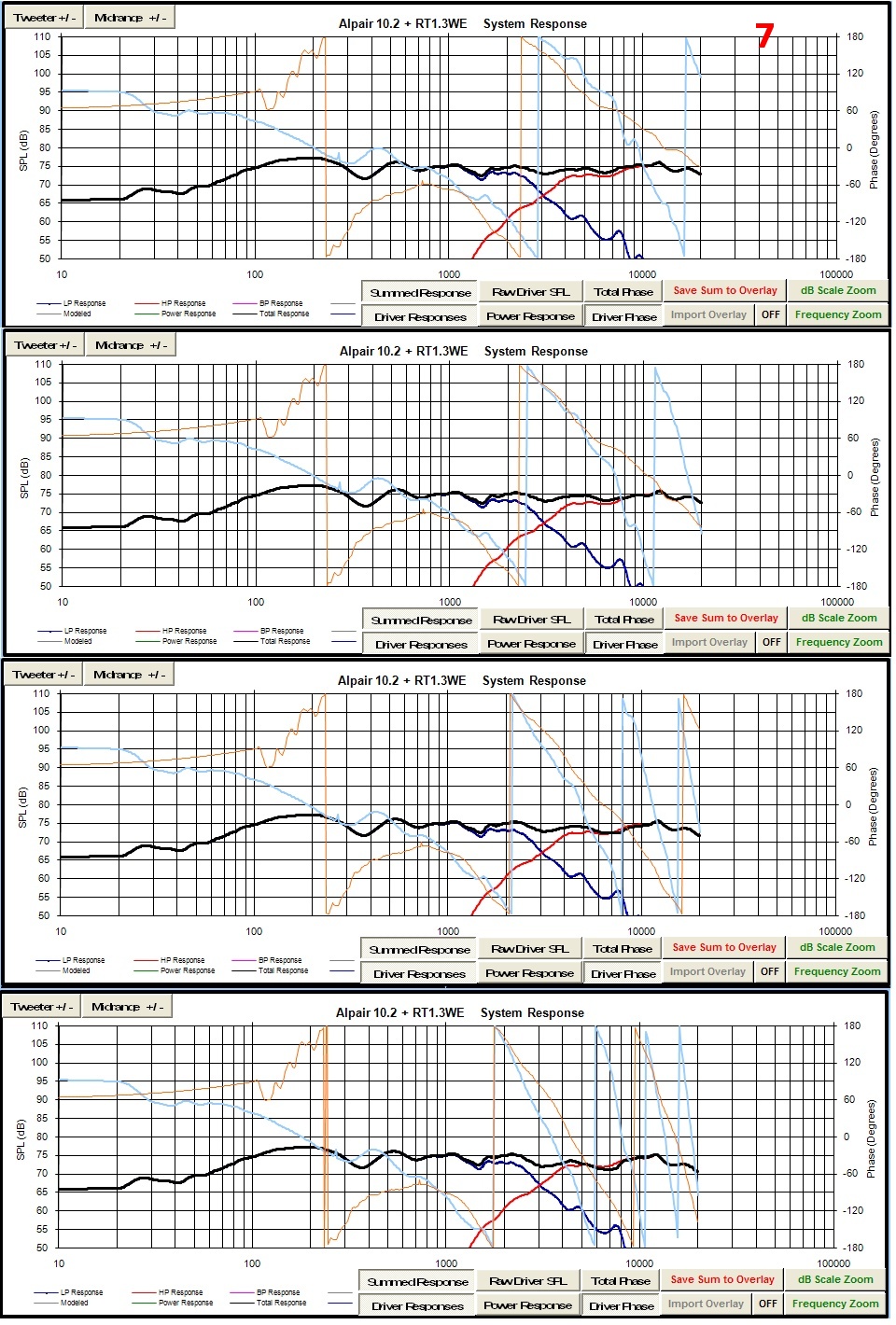

Crossover Showdown
This may be a little bit insane, but it does show my commitment to getting the best out of these. Here are the ten crossover designs I have seen in this thread. Each of the ten images shows the system response at 0 degrees, 2.86 degrees, 5.71 degrees and 8.53 degrees vertically, respectively down the page. Each page is numbered. What I'm asking is for you guys to all take a look, save them or view them full size and pick one, then tell me the number of your favorite crossover based on this data. I'll then take the winner by consensus and build it and post the info for that crossover in the original post. Thanks in advance!

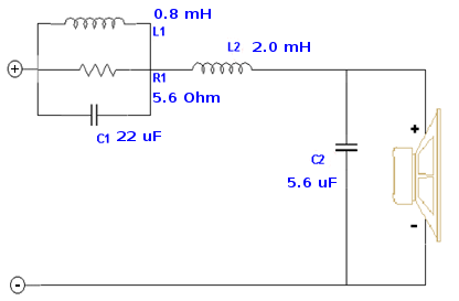

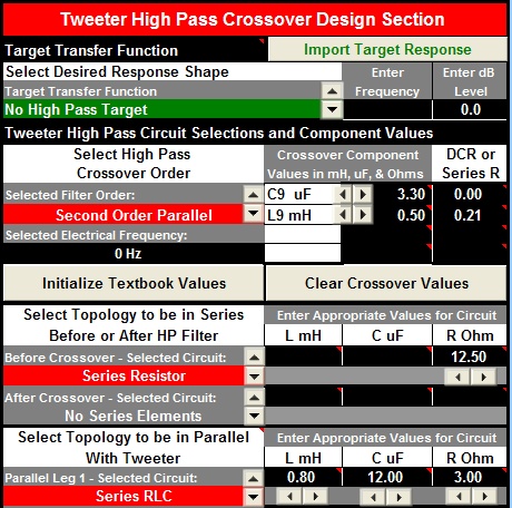

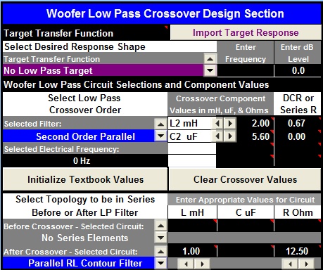

Update: New schematics with final values and parts list for crossover

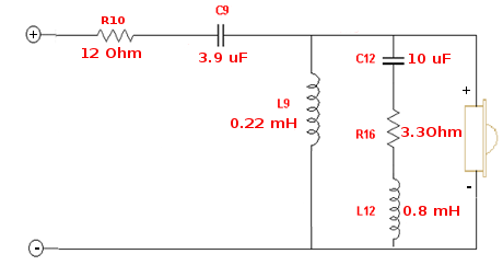

What's the project box for?
I would also question why you went for a Q4 across the woofer (good call!) but not in series with it? I see why the NPE for the shunt notch- that's fine.
A Q4 22 only runs you about $9 last I checked.

The crossover is external so it goes in a small box. I'll show some pics when it's done.
The np cap is much smaller. The film caps get pretty silly in size at a certain point.
The 22uF Q4 is only 1" x 1.5" or smaller. I guess it's your ballgame.
