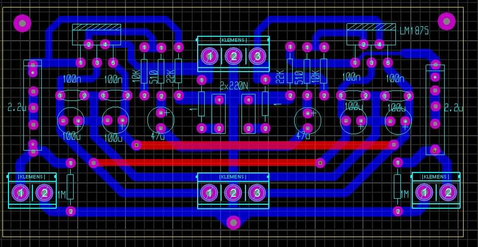

Notes...
I would like to see board space for double the number of electrolytic caps, because it is really hard to buy perfect caps.
All 3!
Additional pads for paralleling the electrolytic caps, gives you a most automated way to improve the cap quality. So, double up the in- coupler, And double up the power decoupling caps.
A good size allowance for each decoupling cap is 10mm diameter, 5mm pin spacing.
Also, change the pads on the 100n to the smaller size for ceramic disc, and in that way (wrong thing won't fit) you can easily prevent ringing bypass.
Fix needed: Input load, 22k||220p make a trip to nowhere--that needs a ground trace added.
Move the LM1875 to the edge of the board so that a heatsink can be used more easily.
Add an additional via and trace for supporting a 2uF electrolytic cap at input. Also, there's a decent polyester cap in a somewhat less than 2cm size, and someone might want to use that too.

These values are appropriate?
