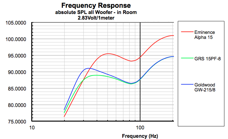

A subwoofer plate amp for the bass end would work, if it has
a L/R 2nd order low pass, and can be set as high as 200Hz.
If it has a built in bass boost option, a lower Qts driver could
be used. Sensitivity would not be critical, so more really what
you want is more Xmax, still difficult to find the right drivers.
The offset c/o schema is critical to the arrangement. Its
this that allows the 6dB sensitivity difference to compensate
for 6dB of the baffle loss, a further 4dB is compensated by
the peaking Q of the bass drivers for about 10dB's worth
of overall baffle loss correction.
The GWs would add a further 3dB @ 30Hz over the GRS's.

I don't know whether it could be considered as a beer budget -thing, nor a Jamo replica, but I've been cooking something with double 15" basses for almost a year now. It's still in a constantly evolving stage.
I built a pair of MJK open baffles a couple of years ago. They were very nice indeed (cheers MJK!). Although I used the Fostex FE108ESigma instead of the cheaper alternative. Nevertheless I thought the bass didn't integrate well with the original design. It was kind of wobbling along, while the Fostex tried keeping up pace. I first ditched the original crossover, in favor of a 2nd order Bessel series filter. This made the speaker a little more coherent, but substituting the Alpha with a Beta 15A made it even better.
At some point I ended up with a pair of Beta 10CX's. They were first intended as closed boxes for my bedroom. However I made the mistake of connecting them to my Fostex-baffles. The sound was - although very coloured with the simple one cap filter between the CX and the compression driver - very promising. There was a sense of ease and effortlessness to the sound I had been missing with the 4" fullranges.
I made the decision on embarking on what would be an almost neverending fiddling with the crossover trying to tame the 10" coaxial.
What I have now, is a 62cm wide, 130cm tall baffle with 2 15" Beta's, the 10" coaxials with ASD1001 drivers. The crossover has currently evolved to a version with only 1st order Solen Splits between the drivers at 120 and 1800Hz.
The sound would best be described as overall effortless. They do pack quite a punch, and have zero tolerance for second quality amplification. And yes, they do prefer tubes. With sandboxes the treble tends to get a bit hissy. With tubes it's cleaner and more natural. I've been listening to rock, metal (including the more underground genres of black metal), acoustic stuff and classical with them. The work is starting to pay off at last, since they are quite enjoyable with all I've been throwing at them. A little more air and intimacy would still be on the wishlist, but otherwise they sound surprisingly natural, given the cheap eminence drivers. Driver cost per speaker is a little over 200 euros here in Finland. And I'm considering spending more money on the crossover components...
I love the Eminence drivers i have. They sound different than the Fostex and TBs but not really better or worse, just different. You can absolutely listen to rock thru them as well as acoustic, classical and anything else... something i cannot say about the other brands i also own and enjoy. Funny how you crossover at 1800khz and i cross at 10khz. I think that 'cheap' tweeter they make sounds excellent!
