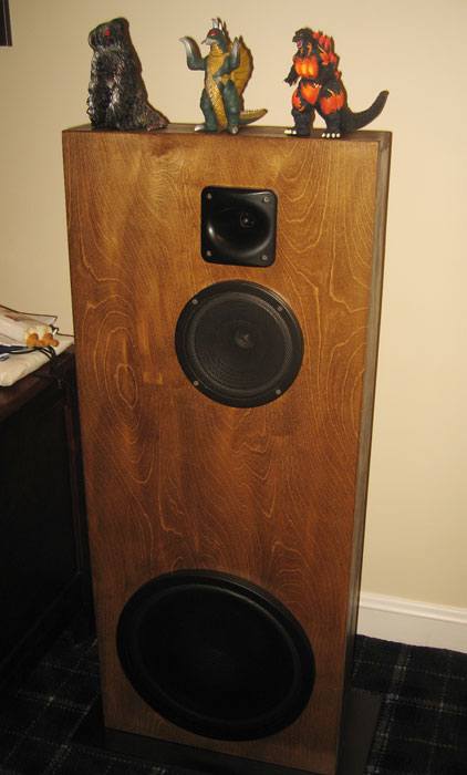

I agree with MJK on this. Attached is a pic of my son's speakers. Wood from home depot, inexpensive drivers connected to an inexpensive T-amp. Source is his laptop. I do use a powered sub amp to power the PE buyout Jamo 15" woofers to dial in the bass. The main driver is the Pioneer B20 topped with a cheap piezo (I think it cost 95 cents bc i bought a box of 10). I've had more expensive Betsys and much more expensive TBs on this baffle and while the sound changes, without knowing the prices, some have preferred the least expensive option. I even tried a $7 ceiling speaker and it sounded wonderful.
If you have space, OB offers a seductive alternative to much more expensive, complicated, boxed speakers that simply don't produce as large and spacious a listening experience. I really have a difficult time thinking of new speaker projects and designs that offer best possible sound without considering OB seriously.
