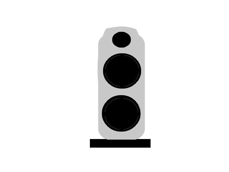

I upload picture how the speaker could look like, maybe around 1,1meter in height, curved in plexiglass with big metal foot as stand.
Is it important which distance it is from the different drivers?
Is it maybe possible to have a 8 inch and a 15 inch instead of two 15 inch, and what do you think of the result?

yesMaybe i could make the speaker a little lower in height, and only use one 15",
nowould it sound as good with one 15"?

Looks good for me, better geometry than the Jamo.I upload picture how the speaker could look like, maybe around 1,1meter in height, curved in plexiglass with big metal foot as stand.
noIs it important which distance it is from the different drivers?
8" as mid, yes with 300/400Hz crossover frequency. Also consider a 7".Is it maybe possible to have a 8 inch and a 15 inch instead of two 15 inch, and what do you think of the result?

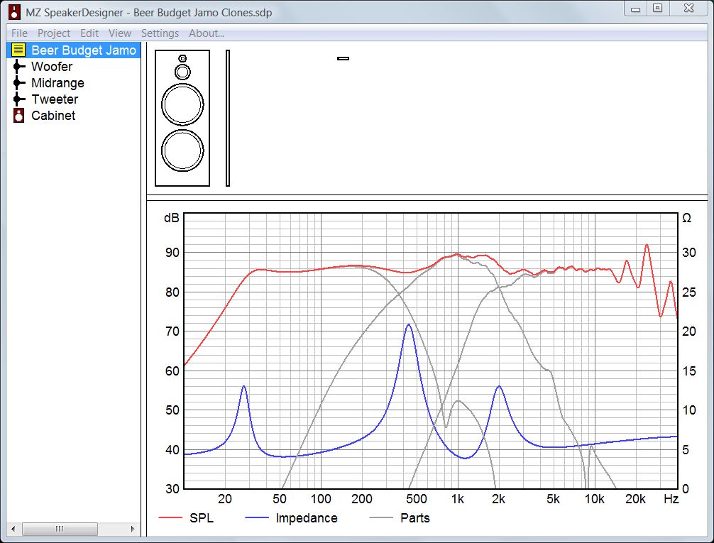

Just made a simulation of the Jamo clones proposed by sreten:
The result is not bad at all for being a pure theoretical combination of two existing designs. Only the midrange differs from the expected response. The reasons are:
- Open baffle is not infinite baffle. Edge diffraction plays an important role and must not be neglected.
- Adding a high-pass filter boosts the midrange (band-pass gain).
Thus some tuning in the midrange seems to be necessary, but then the Jamo clones will work fine.

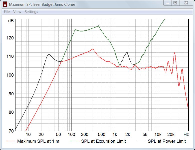

Is that software free to use ? Did you try estimating the max SPL possible with 2 GRS 15" drivers. Thanks.

I'm having some difficulty in understanding your sims general midrange boost.
I can't see how it it boosts the 500Hz to 2KHz range by around 3dB. For
sure open baffle is not inifinite baffle, but I can't work out at all how
you get such a change from a flat inwall response, the physics ?
rgds, sreten.

It's a speaker simulation program I'm writing myself. I just have implemented the open baffle simulation these days. It will not be free, but shareware (free for 30 days). The first release is still pending.
The maximum SPL is:

The baffle step can easily make 3 dB gain at some frequencies. The actual behaviour is difficult to estimate, only a simulation can tell. I'm very sorry for not having a better explanation, but that's all I know...

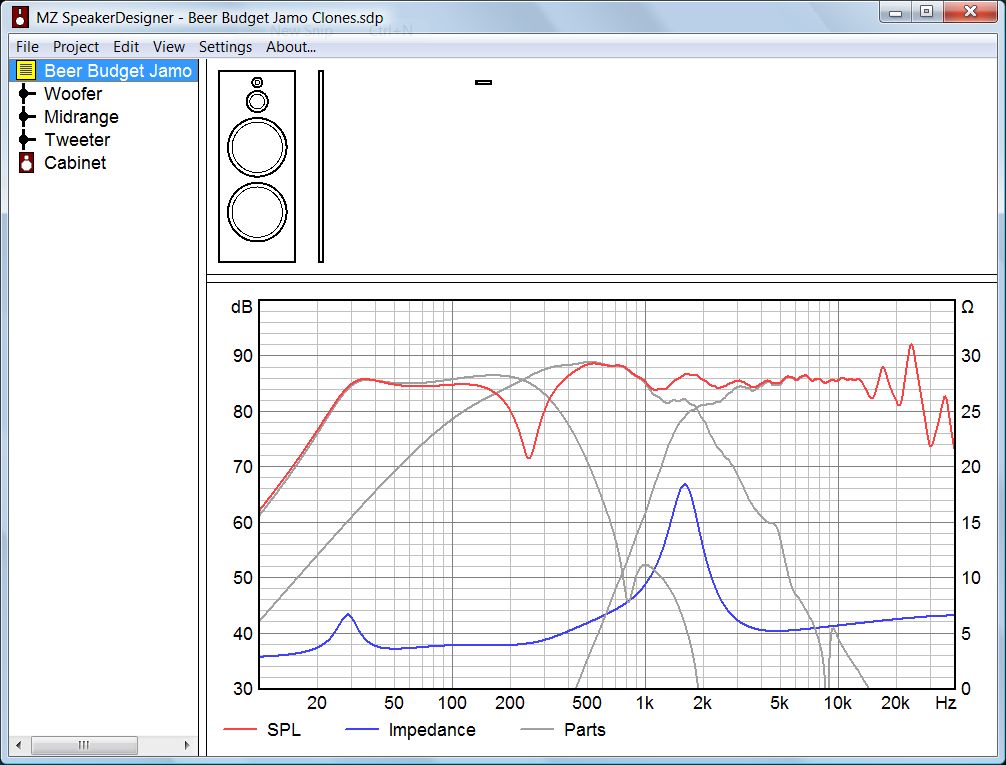

Maybe a simulation without high-pass filter in the midrange helps to understand. It shows the baffle step only, no band-pass gain involved:

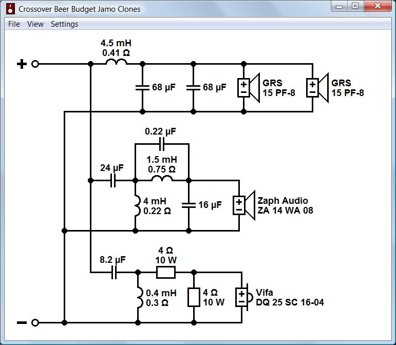

Old thread But FWIW MJKs x/o is supposed to take care of the
baffle hump and his driver mounting positions are more sensible
than central for the mid and treble units.
A simulation without the high pass doesn't help. Both the mid high
pass and bass low pass are modified by the baffle hump in the basic
scheme of things, the high pass is higher, and the low pass lower to
effectively equalise the hump is the fundamental idea of MJKs x/o.
I can't see any evidence whatsoever of the bass to
mid x/o in the impedance plot, i.e. something is wrong.
Sims of the bass on its own and with the low pass (4 ohm modified)
and the mid on its its own and with the high pass would be useful.
For a 20" wide baffle assume the mid centre is 12" from one side
(8" the other) and 10" from the top for the baffle response.
rgds, sreten.

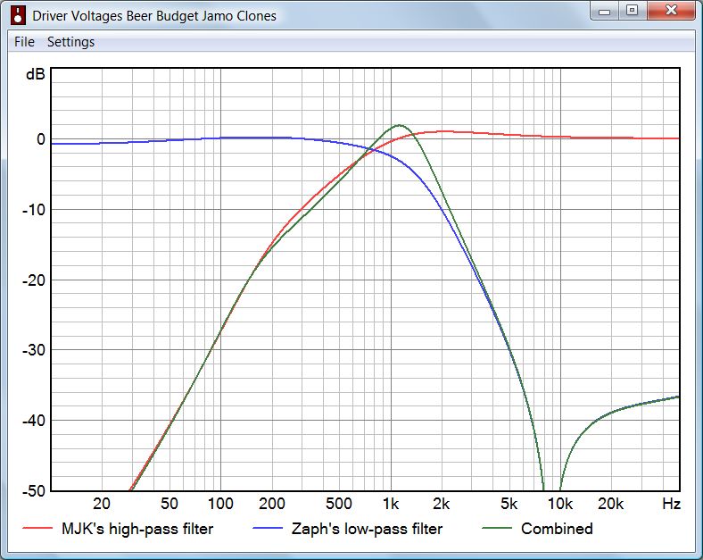

Hi sreten,
The combination of MJK's high-pass filter and Zaph's low-pass filter in the midrange section unfortunately does not simply multiply two independent transfer functions. Interaction actually causes a corrupted band-pass response, which deviates significantly from the desired transfer function and makes the midrange too loud after all.

I can't argue with that, the x/o points are relatively near.
Active bi-amping is the way to go IMO, passive mid/treble.
