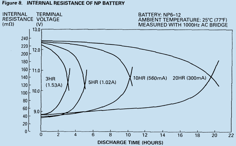

A 12V/7Ah will typically have ca 100mOhms, not well below. And remember you'll usually have to put several in series to get your desired voltage, so this will add up. How important this is depends of course on the application, but I'd say for a class B or AB amp drawing substantial current peaks, this is more than you'd probably want. IMHO, YMMV, etc...Steve Eddy said:
Typical SLAs already have internal resistances well below 100 milliohms. Why would you need to add a big gob of capacitance?

Well, the Panasonic LC-R127P has an internal resistance of 26 milliohms. I don't know about you, but I'd consider 26 to be well below 100. And the higher the Ah rating, the lower the internal resistance. Their 28Ah LC-XC1228AP has an internal resistance of 6 millioms.
Ok, with 3 in series, that's 78 milliohms. Still nothing to lose sleep over in my opinion.

Verbal said:A 12V/7Ah will typically have ca 100mOhms, not well below.

Also this is at 1kHz. A8 rises a good point, they may get worse at higher frequencies...(honestly no idea, though...)
A lot, actually. Class A draws a fairly constant current, while you'll find half a cycle of your output waveform on your supply voltage with a class B amp and high power supply impedance.
Yes, because Panasonic measures fully charged, while other mfgs seem to use the IEC norm. Below is a chart for a similar battery from the Yuasa VRLA manualSteve Eddy said:Well, the Panasonic LC-R127P has an internal resistance of 26 milliohms

Ok. But by the time you start getting around 100 milliohms, your voltage has already dropped considerably.
Or it may not.
I just go by my own experience and so far, I haven't had any anomalies crop up at high frequencies using batteries.
It may be interesting to see what resistance is at higher frequencies, but I only care about the end result. I listen for my own pleasure, not the pleasure of some piece of test gear.
