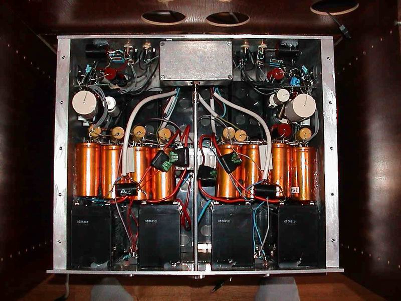

Batteries??
I've got my lc audio millenium power amp running on 16 (2x4 per channel) Panasonic 12V 7.2Ah SLA's.
I am using a normal power amp PS to charge ie transformer and the rest results in 2x55 volt per channel which during charge puts 13.75 volts per battery.
This is my second set of batteries using this very simple "charger" and the last one kept the batteries OK for 9 years (then they started to loose voltage and get really warm...)
This is how it looks.........

Hi Pan,
There are no huge differences, but still there are some, particularly the midrange gets really clean and very..very (relative description) intense/powerfull.
Other then that it affects both low and high frequencies, the lower gets a bit more solid and paced, upper ranges gets slightly softer and better defined.
All in all it is more fun to listen with the batteries switched on.
NOTE My set up still has 240,000uF when running on batteries and 480,000uF when I run the normal supply. The transformers (one per channel) and half the 480,000uF are in a separate box. The batteries and the rest of the caps are in the poweramp case.
The benefits are still there during charge so I typically run with both supplies going.
