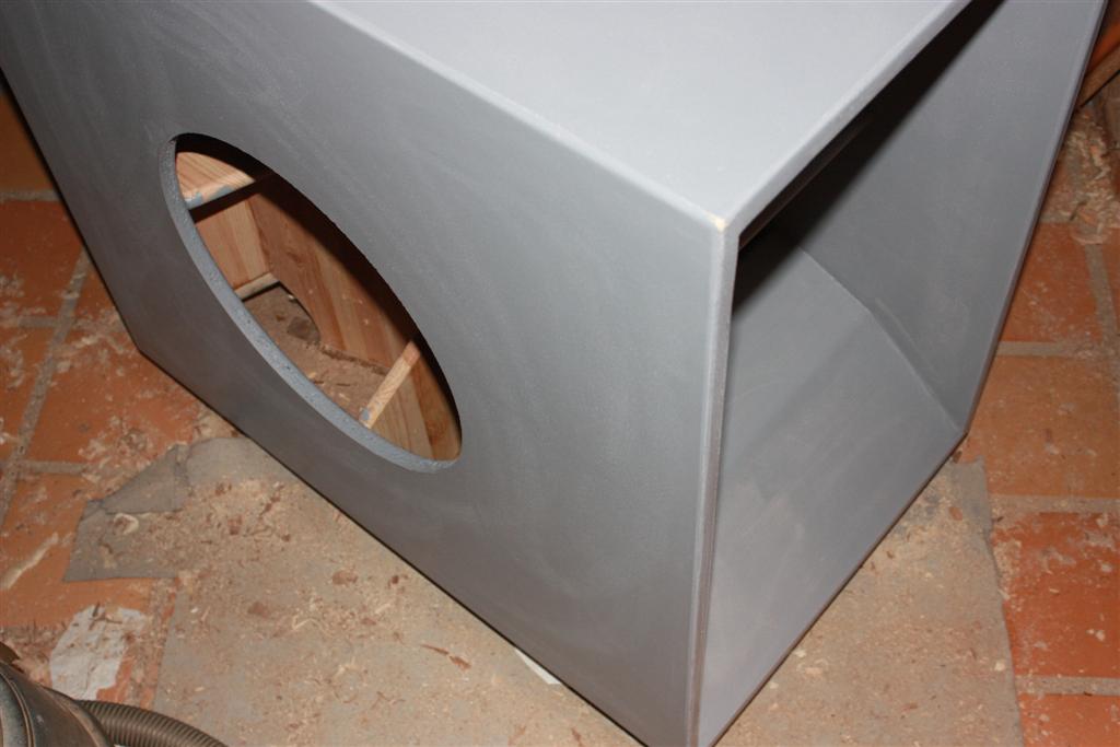

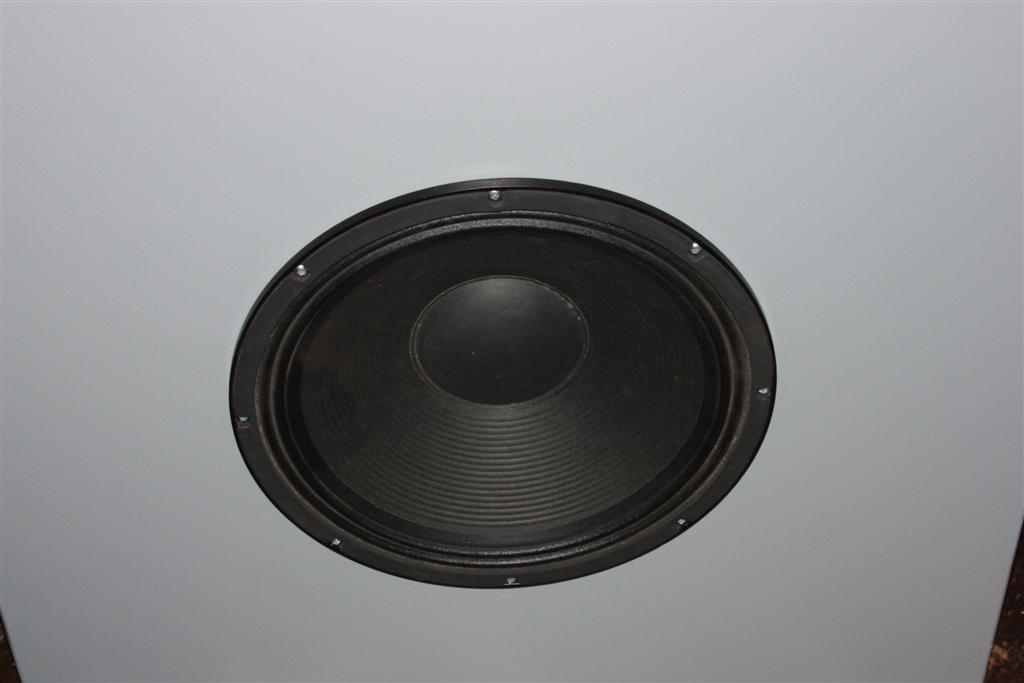

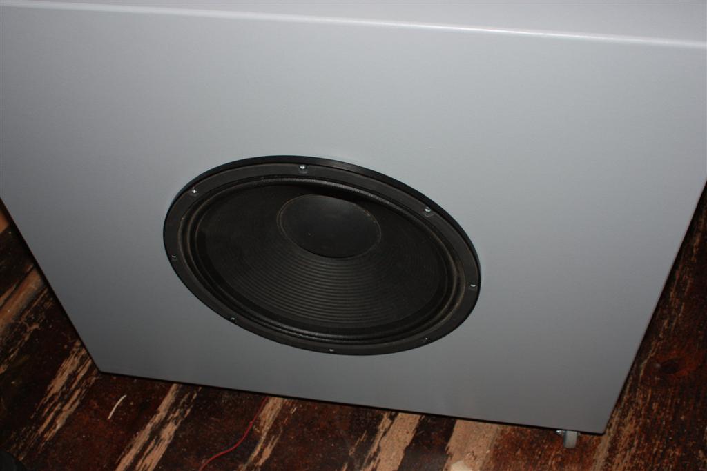

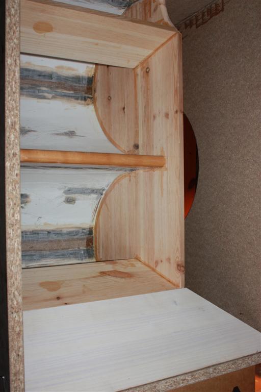

hey, managed to cut a hole for the 15" woofer
looks kind of small :D

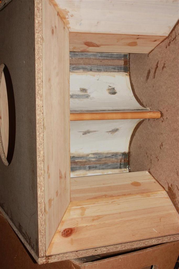

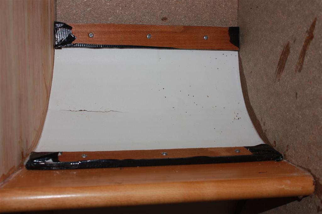

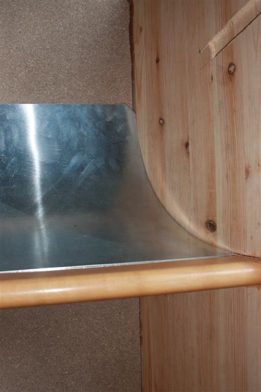

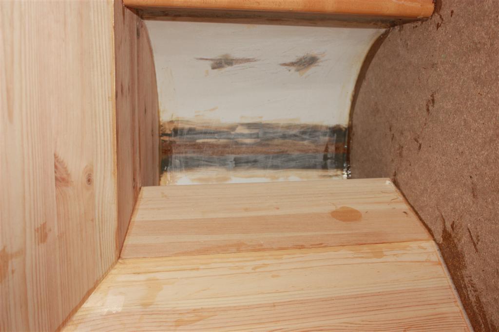

ok, small problem, but solved
its the foam I plan to use
the spraycan can't be used more than once
well, there are other types of foam, but whatever

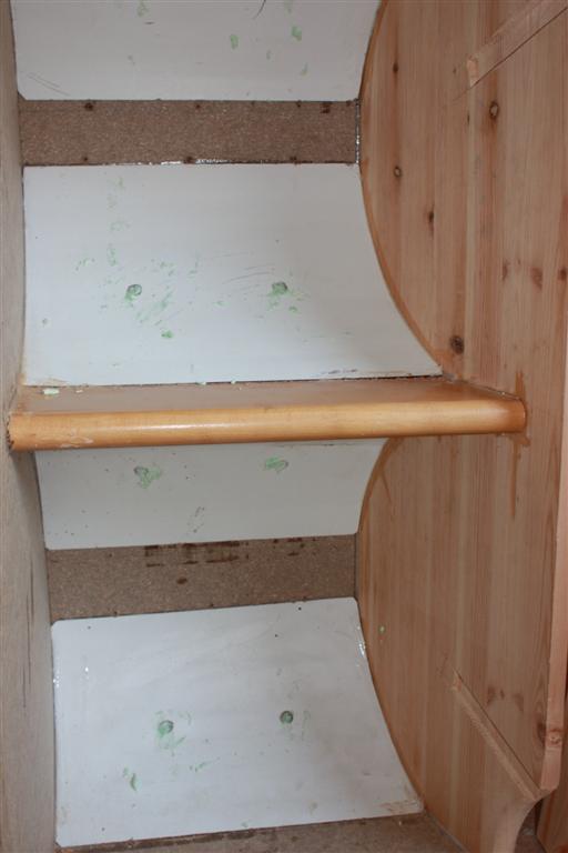

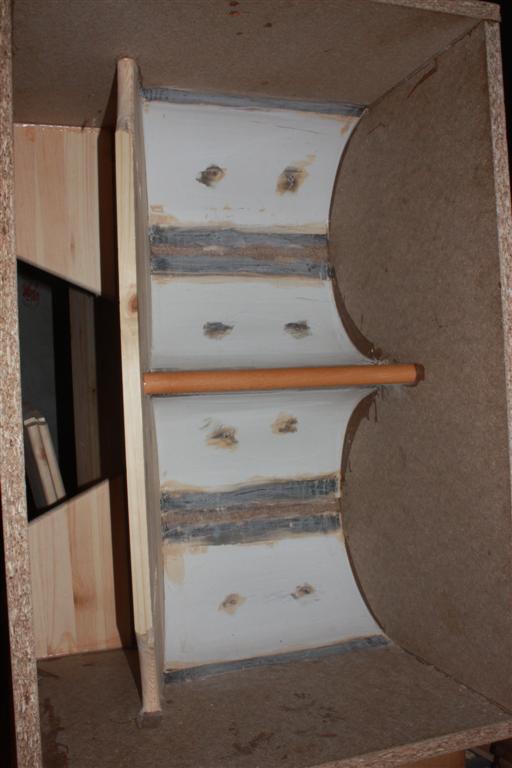

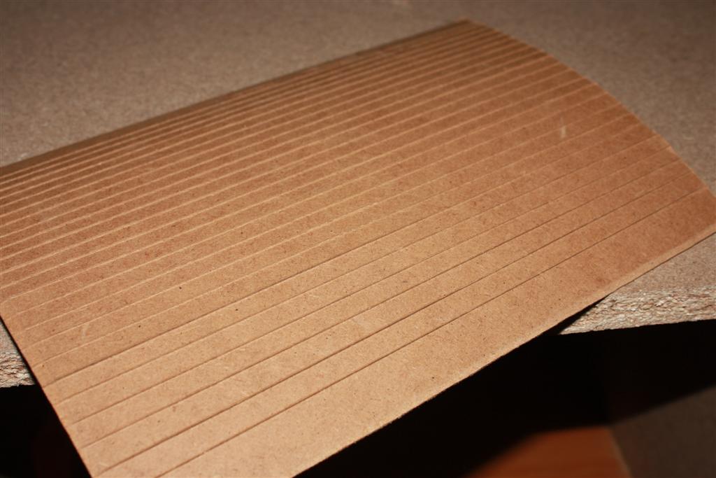

I found this massonite back panel from an old wardrobe
slicing the plate with a hobby knife makes it more flexible
not much work really
then I can just fill up with foam, after its glued into place
that should work ok

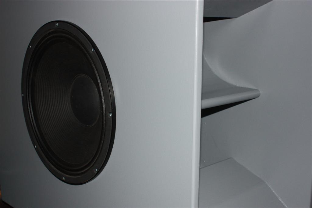

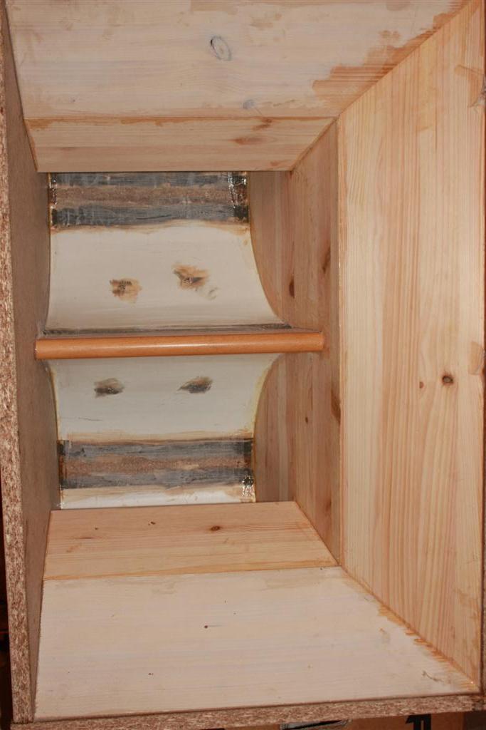

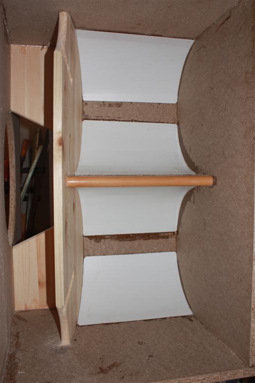

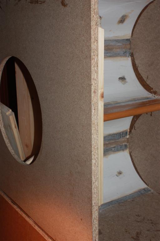

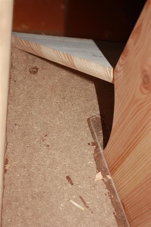

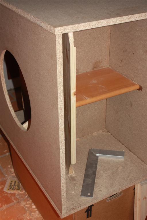

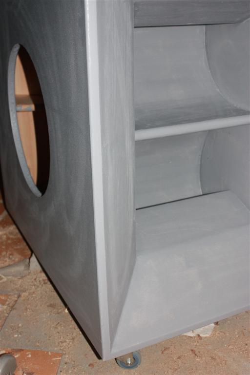

that last curve baffle proved more difficult than expected
but it done now
just a reminder, there's a horn mouth on both sides
'the voice test' sounded nice and soft
can't wait to play some nice bass tunes through it
maybe it works, maybe it doesn't
but its exciting :)
now on to finishing
and maybe some wheels :D
