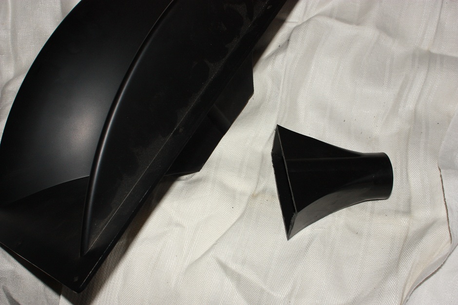

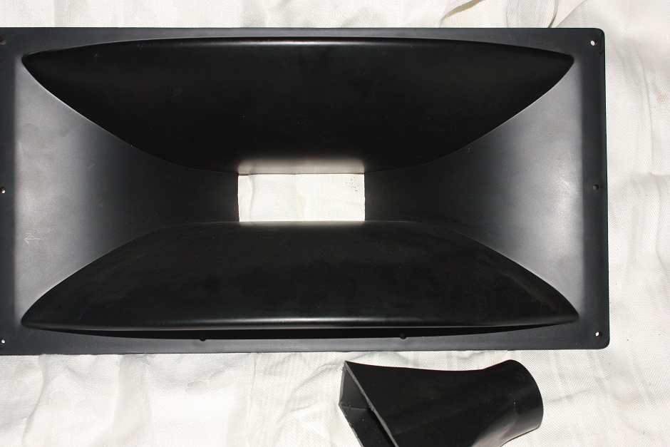

mounted a mid horn with compression driver
a 1.5uf in series, fore a first try
huge difference
can't really hear much sound from the mid/tweeter horn
but now I can hear what I'm playing
even the low notes are much better
I had so blurred sound I was about to throw it away
funny that something this simple can make the whole difference

hey, you gotta hear, its even more crazy than I imagined
as said, I started out with a series 1.5uf on tweeter
then went on to 3uf, with another 1.5uf
that sounded real sweet
but I still couldn't hear any real sound coming directly from tweeter
I thought, lets try bigger cap
mounted yet another 1.5uf, increasing to 4.5uf in total
and whack, my bass guitar went nuts
suddenly impossible to tune the bloddy bass
didn't sound really different, as such
just out of tune
hmm, removed 1.5uf, and back to the 'magic' 3.0uf
and some minor quick tuning
showed to be a piece of cake
sounds weird ?
well, yeah, it is
I really like them spanish gypsy tunes
and guitar tuning has to be close to perfect to sound right
and it tells me that designing bass guitar speakers may not be so 'simple' at all
and I wonder if a guitar speaker would be even more tricky
but its probably about the same thing

just a thought..... what's the damping factor of the amp? class D amps tend to have very low damping factors (even compared to tube amps sometimes, the cheaper it is the lower it is). sounds like you are getting a lot of interaction between the amp and the load, and loaded horns are hardest to tame. it seems that the tighter you coupled the mid with it's loaded horn to the amp (by using larger capacitances) the more pronounced the interaction became. cheap class D amps have no feedback, and their voltage gains are determined strictly by the ratio of the modulator's triangle wave to the rail voltages of the outputs. there is no mechanism for controlling the effects of back EMF from the speakers in a case like this, and the back EMF interacts with the amp's output. try the experiment again with a classAB SS amp and you will see what i mean. there are ways of lowering the damping factor of a class AB amp if the sound isn't what you want.
just a thought..... what's the damping factor of the amp?..................
hi Jed, yeah, I know
its a 15watt Crate guitar 'combo'
I'm working on it
but, I will remind you that problems described above are exactly the same without the tweeter horn
I know a lot of those problems come from my 'amp', but I still find it interesting

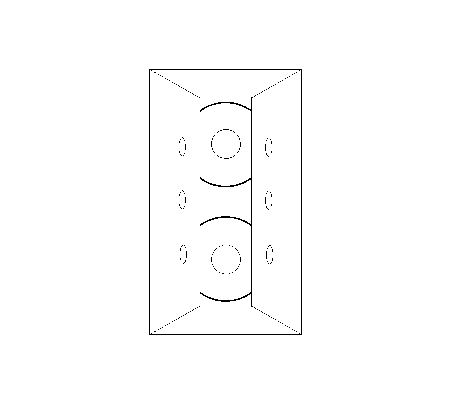

well, my main issue right now with the unity horn is the design complications, caused by driver mounting/assembling
and the size, ofcourse
in the end, to me its basicly the available drivers that determine my design decisions
and right now looking at some pretty interesting new woofers from Faital, model numbers ending on **10
not really sure where it leads me yet
