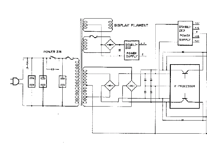

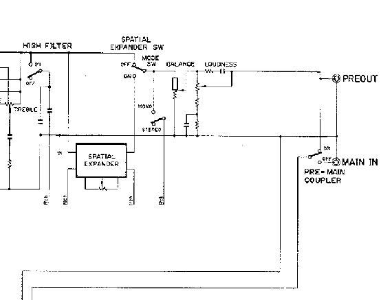

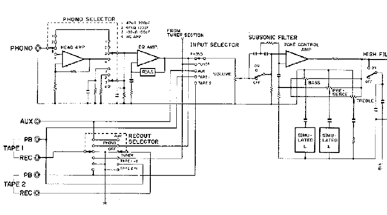

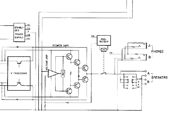

As far as what measures Yamaha took to prevent some LED head from burning up his amp and speakers is hard to tell. The only schematic I have is off a low resolution (fuzzy) PDF file, which I had to split into 4 images (below).
On the 1st image you can see some capacitors & resistors between the volume pot and the "tone control amp" that can be switched in or out of operation using a button the front panel. Yamaha calls this a "sub-sonic filter" for reducing "ultra low frequencies ..... caused from rumble or warped records....such signals can sap vital power and even harm speakers if not attenuated".
On the 4th image you can see the power amp section (which gets its signal from the pre-amp final output shown in image number 2). I don't see any DC blocking capacitors here.

I just had a quick search for your amp but didn't turn anything up.
The above piccys are just basic block diagrams... I wouldn't read too much into whether it has any caps or not from that.
For example the power amp shows the input and feedback loop to be DC coupled (can you see how it is basically an "opamp" with power transistors added) and that would be really unusual to say the least. The feedback return is always (99.999% of time) AC coupled to reduce the gain to unity or 1 at DC. The input is almost always AC coupled... an more so on something where they invite connection to unknown equipment.
I'm sure it will be AC coupled.
It's normal to show the filter caps etc as they have done (rumble etc) but that's about all.

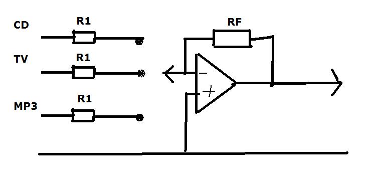

Ok. So if this integrated amp could support three(3) sources, where Source #1 is a line level device (like a CD player), Source #2 is another line level device (like a TV set) and Source #3 is and MP3 player that needs a preamp to boost it's output up to line level strength, would the circuit topology look something like this?:
Source 1 ---------------------> selector switch --|
Source 2 ---------------------> selector switch --|----> Vol. pot----> Power Amp
Source 3 ---> Preamp ----> selector switch --|

Now you could use an opamp (inverting mode) and have the "input resistor" a different value for each source so as to "equalise" volume levels.
Like this, post #2
http://www.diyaudio.com/forums/solid-state/119151-my-mosfet-amplifier-designed-music.html
the second OpAmp restores absolute phase. There is a lot of debate whether absolute phase matters at all... you can experiment by just swapping both speaker lead polaritys over and see if you can tell a difference. Something I have never tried tbh.

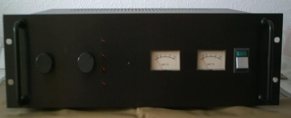

That's "gotcha" hasn't it
The amps here starting post #283
http://www.diyaudio.com/forums/solid-state/96192-post-your-solid-state-pics-here-15.html
It's what I'm sat in front of now

Hi Obe1,
It's one opamp and as many inputs as you want.
It's a "virtual earth" mixer configuration.
You have each input going to it's own "R1" and then to the switch. Each input goes to a different pole on the switch. The wiper of the switch goes to the opamp... easy.
You select each "R1" to give the same volume for each source. It the classic inverting amp, gain being RF/R1.

Ahhhh! Now I get it. Very clever.
