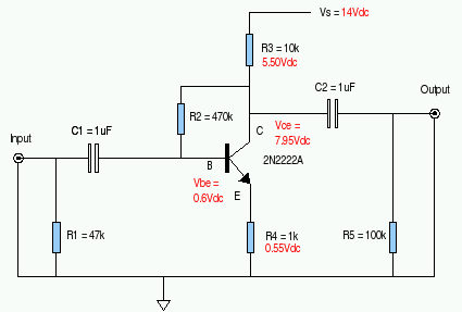

I breadboarded a very basic Common Emitter voltage gain stage as seen in the diagram below and the results are confusing to say the least.
The steady state (Q point) voltage readings (shown in red) seem reasonable, yet this circuit does not behave as I would expect when an audio (AC) signal is applied to the input jack. For example, when I plug an MP3 player into the input jack with a signal level of approximately 0.050 mV AC RMS, the output jack signal measures only about 0.040 mv AC RMS. (Note that these signal levels were measured with nothing more than a cheap Digital Multi-meter).
While I don't have a real signal generator or oscilloscope to run accurate tests, when I connect the output jack of this circuit to an auxiliary input on my Yamaha integrated SS amplifier, the results I hear through my loudspeakers seem to verify what I can read off my DMM. That is to say that the sound level out of the loudspeakers when the Common Emitter stage is in the signal path is less than when I connect the MP3 player directly into the Yamaha.
I'm trying to learn about basic amplifier circuits by trying this very crude circuit as a first step and I realize that it's biasing technique and high output impedance are far from ideal, but a guy's got to start somewhere.
Any feedback on why I'm seeing what I'm seeing will be much appreciated.

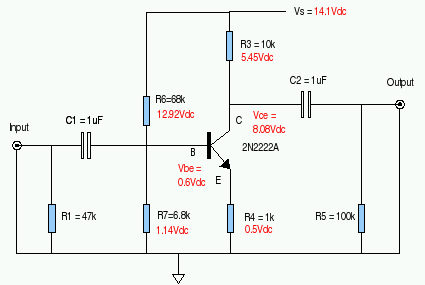

Well this circuit sure acts more like a buffer than an amplifier. If I understand the theory correctly, R2 does provide bias to the transistor as well as some negative feedback for thermal stability, yet not so much feedback as to negate any decent voltage gain. I was expecting to see a gain equal to approximately - R3/R4 (-10K/1K = -10)
Just for the heck of it I removed R2 and replaced it with a more traditional bias circuit as seen in the diagram below. As expected, the steady state DC voltages remained about the same as before. Unfortunately, the final results were the same when I applied an audio signal to the input as well (ie. no output voltage gain, just a bit of attenuation instead).

Also what is the load it is working into ? as any significant loading at the collector will reduce the gain.
Your circuit and basic theory is sound... you really need a 'scope etc to see for real what and why it behaves as it does.

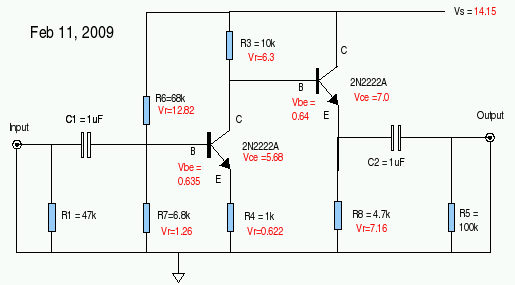

Well I went ahead and added the emitter-follower stage as seen in the attached sketch. Again, everything appears to work fine, although my ears detected a slight loss in overall gain (yet I think that was to be expected).
Thanks for the suggestions on other things to try. I see that TL071 OpAmp you suggested has a J-FET input circuit. This intrigues me as I was reading that J-FETs replicate some of the sonic qualities of vacuum tubes due to their transconductance. As I continued to read, I was a bit intimidated by the fact that individual J-FETs means fiddling around to get them to match. Do TL071's minimize having to stress over mis-matched devices?

It's good you are trying things out. tbh I wouldn't have expected the gain to be noticeably different with a follower (not audibly so)... and certainly not lower as it "helps" the first stage by isolating it from the load. The voltage gain of a follower is slightly less than 1 (unity) but I'm surprised it's audible. Connections OK ;)
