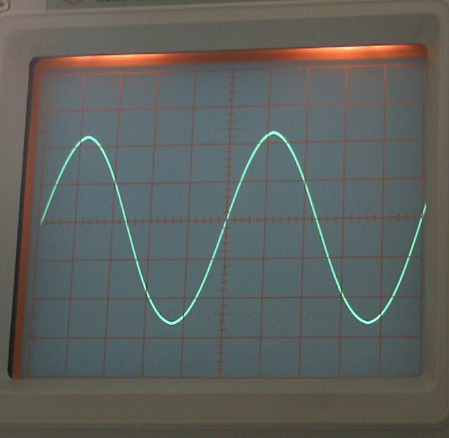

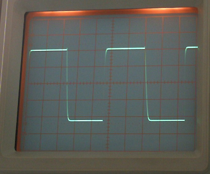

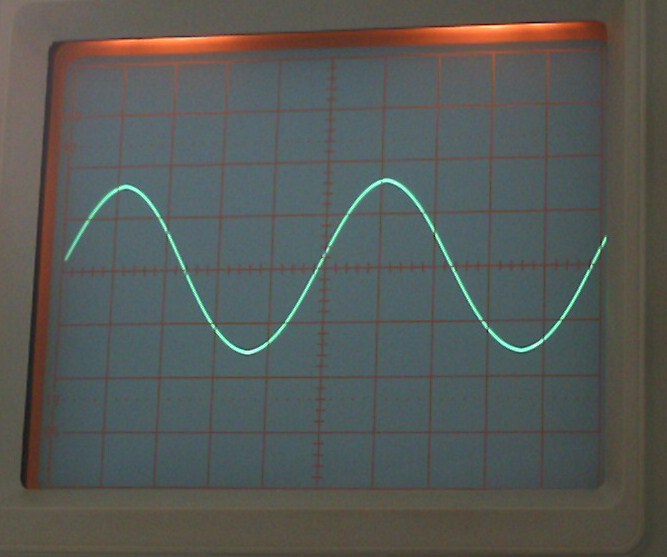

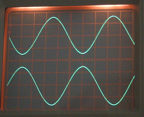

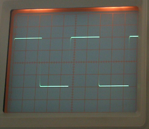

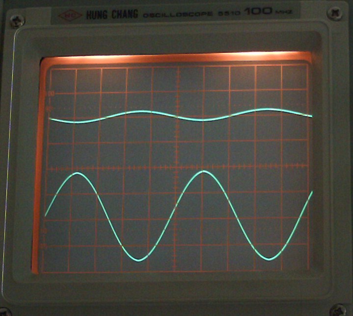

Some 'scope shots then. This is the simple circuit you show in post # 28
The supply voltage is approx 10 volts and the frequency is 10khz.
The input is the top trace and the output is the lower.
Picture 1 shows the amp with 200 mv peak to peak (pk/pk) applied to the input. The output is approx 1.7 volts pk/pk approx. Any loading on the collector (the 100k) and whatever you connect it too reduces the gain as that change in impedance has to be taken into account. And you have some feedback due to the bias resistor.
Picture 2 shows more clearly the 180 degree phase inversion that the common emmiter amp produces.

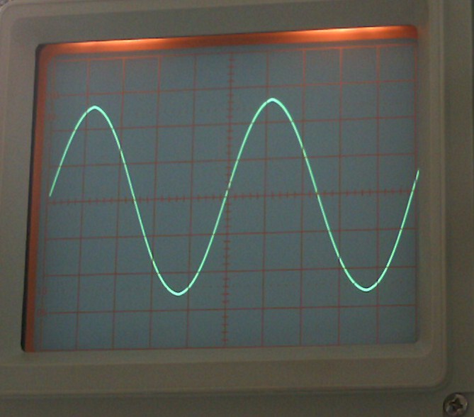

Picture 3 shows a problem. Assymetric clipping. This is due to the bias being less than optimal. With a high impedance simple bias network the characteristics of the transistor have a real effect. Normally in a design it doesn't matter if the transistors have a gain of say 60 or 600... the circuit should be totally unaffected. So here you need a two resistor bias network to give a precise defined reference voltage and at a low enough impedance that the transistor base current is many magnitudes smaller than the current in the bias network and can thus be discounted. The maximum undistorted output here is only 3 volts pk/pk.
Picture 4 shows a 100 k added from the base to ground to alter the bias. Now the maximum output is nearly 7 volts pk/pk.
Picture 5 shows the LED replacing the 1k resistor. The gain approaches 100 at low input levels below clipping. As the amp is overdriven you can see the distortion produced.
Picture 6 shows effect of a 330k resistor from base to ground, again altering the bias. If you look closely there is some "thickening" of the trace at the lower part... a sign of high frequency instability.

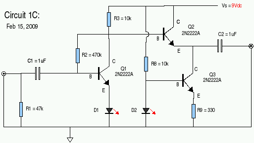

Hello Mooly and company,
Well, I added the Emitter-Follower (EF) stage back in today and it's being fed with 3mA of current using the (LED based) CCS circuit Mooly suggested. While my ears can't detect that it did anything positive, I didn't detect anything negative either. For that reason (and I get one more pretty light) the EF stage stays in. Please see attached sketch below.
So, what do you all suggest I explore next?
CBS240 suggested bigger coupling capacitors. I'm OK with that, but the only thing in stock locally are gigantic motor starting caps (if I need to stick with a film type cap) or aluminum electrolytic's. Anything else will require mail order (which is OK too).
How about adding another stage to make the whole amp non-inverting? Gosh knows I don't need any more gain, but maybe their's something magical about non-inverting amps I don't understand.

Are you building all these on a plug board ? (no soldering)

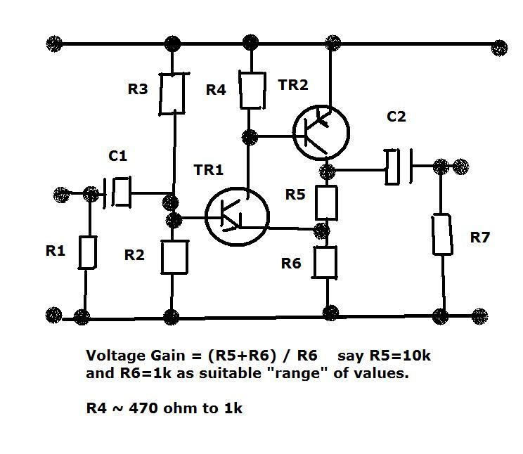

What next... how about a two transistor gain stage using an NPN and a PNP device. It's very different to "just adding another stage" as the two devices work "as one" as it were.
Have a look at the circuit here.
I'll let you "calculate" the bias resistors. :)
Remember for maximum voltage swing the collector of the PNP transistor wants to be at half the supply voltage approximately.
Hint... so put a value in for the supply, say 10 volts, and calculate the voltages across R5 and R6
Now you know what voltage the emitter of the NPN will be at (ve).
So what voltage does the bias network need to provide at the base of TR1 (vb) ?
Answer... TR1 vb equals TR1 ve + "something" ;) :)

Hello Mooly,
Construction: Yes, everything I've wired up so far is on a plugboard (no soldering). Yet soon I would like to take one of my circuits and solder it together on a chunk of perfboard to create a finished/usable project. I've never tried that before either, but interested to see if I can pull it off. :xfingers:
Circuit Quiz: So 5Vdc at collector of TR2 means 0.45Vdc at emitter of TR1 when R5 is 10K and R6 is 1K. Then 0.455Vdc plus a "something" of around 0.65Vdc, means base of TR1 is sitting at 1.105Vdc. With R4 selected to give about 1mA through TR1, I want current through R3 and R2 to be about 0.2mA (assuming conservative Beta of 50 for TR1 and desire for biasing resistors to carry 10 times TR1 base current). So, 10Vdc supply divided by 0.2mA means I want R3 + R2 to be 50K Ohms or a bit less. With R3 at 39K and R2 at 5.1k, total is 44.1K and bias on TR1 will be 1.156Vdc, which is pretty close to the 1.105Vdc target. How did I do professor? :confused:

Well that all looks pretty spot on to me at a first look through... I hadn't calculated any values this morning when I drew the circuit... so you have saved me the job :)
Your figure of 50 for the gain (hfe) of TR1 is good... very conservative so no problems there.
R4... that's an odd one. You say you will select it to give a current through TR1 of 1ma or so. The base emitter junction of TR2 means R4 can never see more than 0.6 volts or so and the emitter of TR1 is at .455 volts. So the combined current of TR1 and the current through R5 give 0.45ma total. The circuit will actually work without R4. R4 helps speed things up by removing charge from the base of TR2 (so called charge storage effects).

This is useful to know about transistor currents. Perhaps you have come across this already.
Ie = Ib+Ic
Ib = Ie-Ic
Ic = Ie-Ib
Do you understand R4 ?
Selecting it's value is a "balancing act". The limit of 0.6 volts that can ever appear across it means that if you lower it to much then the circuit just stops working as you starve TR2 of base current because the resistor chain R5 and R6 are determining the available current.
You could drop the value of these, say to 1000 ohm and 100 ohm, but the trade off is increased current draw (when it's not really needed) and increased power dissipation in TR2. The bias network would still be correct... as long as TR1 hfe (beta :)) was sufficient. If not you just decrease the value of these to compensate.
Now you can add an emitter follower to this amp if you wish (this amp is non inverting by the way).

First an apology... I have given you some very misleading info on the two transistor amp. The info I gave regarding bias really only holds true when R4 isn't present.
In all these shots the amp was as previously drawn, but using a 12 volts supply.
The first shot shows the amp with no R4... the collector of TR2 is set to 6 volts (I substituted R2 with a 100k multi turn pot to make quick bias adjustments). This is the condition that allows maximum swing at the collector of TR2... and as can be seen there is over 10 volts pk/pk available.
Next up is R4 at 470 ohm. This "lifts" the emitter of TR1 from 0.54 volts with no R4, to around 1.71 volts. The maximum output is now only around 9 volts pk/pk.
And thirdly with R4 at 180 ohm. Now the emitter if TR1 is at around 3.56 volts. The maximum output is also greatly reduced to around 6 volts pk/pk.
