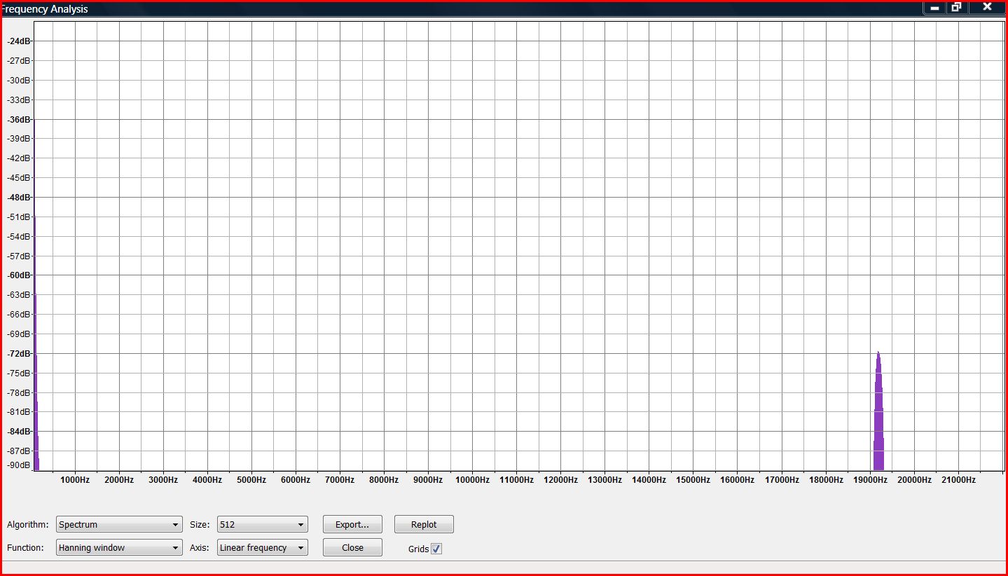

It is not at -30dBFS but at -78dBFS. Please recheck your files. Even your post shows something below -70dB.
There are many recordings with standard high frequency (signal, not interference) content well above -70dB!!

You missed the point I made about the fact that the high frequency signal is only 30 or 40dB below the audio content. The absolute level is irrelevant, it's the volume that it will be played at which is significant when determining if it will be damaging.

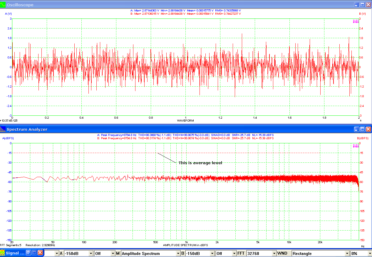

Very sorry to say that but you are wrong again. Level of the 'audio content' is summed from spectral components. So the 'level' is much higher than you are expecting. On the other hand, 19.2kHz was the only and isolated spectral line so its 'level' was correct. To see what is 'level of the audio content' please check the attached file. Do not forget that FFT is a narrow band tool and shows only amplitudes at the selected frequency, it is like narrow band filtering. In the image attached, the level is -15dB though no component is above some -50dB.

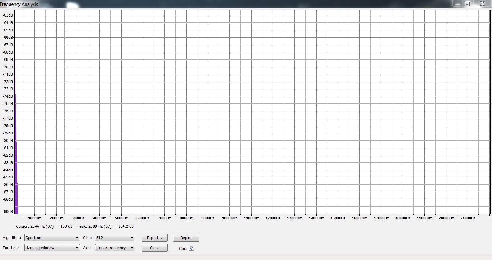

Well none of you lot told me I could look at an FFT plot even in Audacity
I can see it for myself now. I must try this on the Dell at some point.

Mainly the fault in your sound card I think
You can change the scale in Audacity to 0 - -160dB and the FFT size. The analyze feature supports 1M sample FFTs. It's much better than most of the FFT plots people as to be posting here.
Thanks. Yep, its the sound card in the Acer doing it.

The fault in your sound card was mainly what I thought I was listening to. That and a low pass filter of some kind. Possibly a long cable or a simple RC network in opal.
