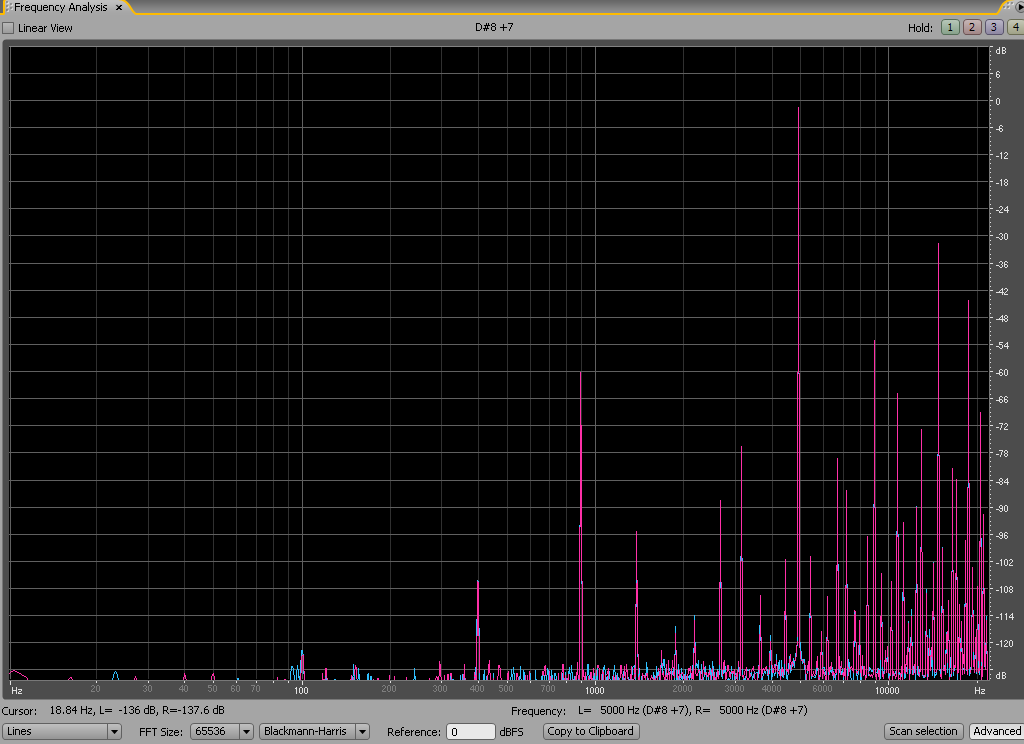

I am a cheater :). The 'vinyl' version that I have posted in this test is almost no vinyl version.
How was the FL_vinyll.wav created?
1) the data used were the original data from CD, i.e. FL_cd.wav file

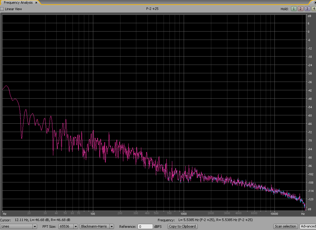

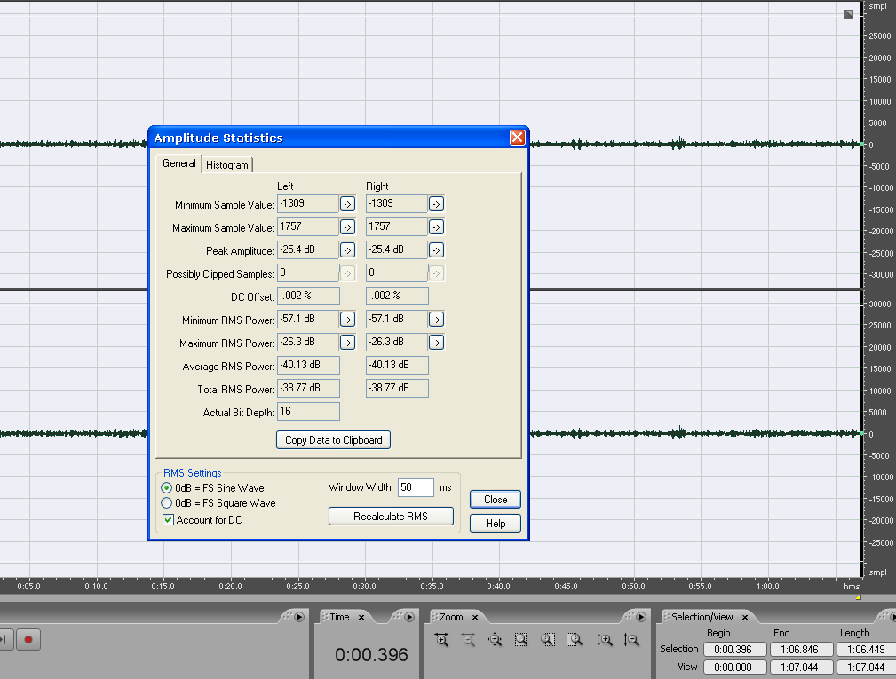

2) I have recorded the noise of empty groove of the vinyl, empty track of the measuring LP was used. I have made only a mono record – this is the weak point of my 'vinyl' file.
3) Stereo mix of original CD data and recorded LP noise was created. I thought the job has been done, but it only sounded like CD with vinyl track noise.

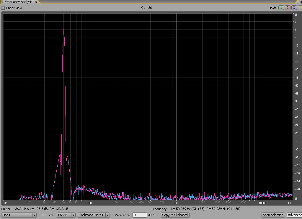

4) Retro exciter mastering function at 5% was used to make the vinyl like sound. Now the result was fine, but still too much channel separation.
5) Another mastering function used – narrowing the stereo bas by 20%. The result of these 5 steps is the posted FL_vinyll.wav file.
Attached please see empty groove noise (that was added to the CD data), groove noise spectrum, and exciter function applied to 50Hz, 1kHz and 5kHz, to demonstrate 'midrange improvement' ;)
The steps 2 + 3 were inevitable. There was no way to achieve vinyl illusion without having the real groove noise recorded.

The thought had crossed my mind that this was a setup in some fashion - and so it came to pass, :). I don't know about "retro exciter" processing, this was obviously the origin of the "stew" effect - interestingly, I have just sampled two CDs, recently recorded, which have been put through the "old time recording" manipulation routine, and it doesn't really work - it doesn't sound as good as a clean version, nor truly capture the positive qualities of the older recordings.
