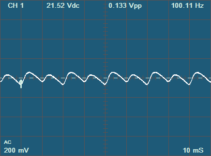

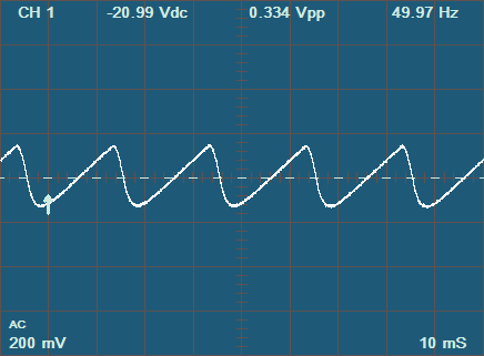

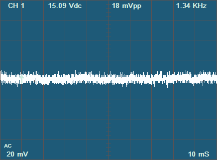

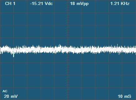

Nothing... that is not the problem...
I fixed some ground solder and now I'm again at the start point. +/-15V seems good and I can hear the hum in the output.
In attach you can see the positive rail and negative rail, in input and in output to the stabilizers.
I see that on the output of the stabilizer there is a nois of 18mV? Is this ok? Because in the datasheet I read that the nois should be 90uV.
Finally I solved the issue. I added 2 100nF ceramic capacitor between output and ground pin of both lm7815/7915 and the hum disappears.
So it seems that they are very important and cannot be replaced by 10uF elettrolitic.

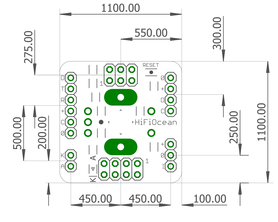

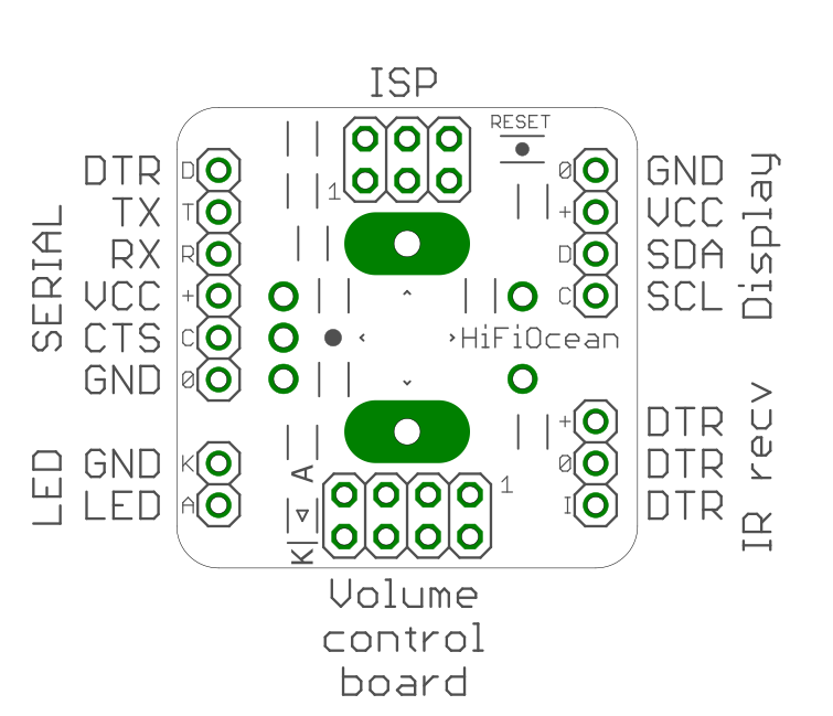

The controller board is 1.1x1.1in and carries six 0.1in pitch headers:
  • Eight pin in two rows for the volume control board
  • Four pin for the display
  • Three pin to connect an IR receiver for remote control
  • Two pin for an LED (not used by the current firmware)
  • Six pin, single row for a serial port
  • Six pin, double row In-System-Programming (ISP) port
The last two connectors are mainly intended for development and are not used by the current firmware, so I may remove them from the production version.
All connectors except LED carry power, so any one of them can be used to power the board, and the remaining ones - to provide power to other devices. Normally, the power is provided by the volume controller board, which carries a 5-volt regulator. In turn, the controller provides power to the IR receiver and display. Other arrangements may be possible. The controller board needs between 2.7 to 5.5 volts. The display from SparkX works with both 3.3 and 5 volts.
The attached pictures show the size of the board and connector placement.
