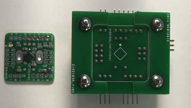

Also, I finally built a little programming and testing jig with pogo pins, which allows me to test and program controller/encoder boards without soldering connectors to them:
attachment.php
So I am moving forward with this project.

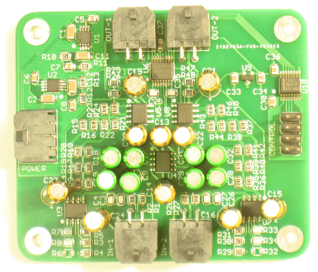

2 questions please
- I was looking at the PCB and balanced output is not very obvious. I can see the balanced input though.
- is this a "preamp" with built-in volume control? If yes, what's the gain?
- can I use other dual opamps? I have several/enough opa2132 (and perhaps other dual OPA chips)
- is there a need to match resistors? If yes, what are the important ones? Thanks a lot.
Sorry Deenoo, no progress with LED displays lately as I've been busy with other projects. On a positive side, I built a new MDAC based volume control:
which needs a controller, so I am getting back to the topic.

The new volume control is similar to the three previously published but uses a two-channel 16-bit MDAC (DAC8812) to actually vary the signal level. I don't know yet how it compares to the other variants. The MDAC can be controlled over a ground-isolated, voltage-level-translated SPI-compatible serial link by any MCU, including the little guy I have been promising for so long. MUSES, PGA and WM8816 boards are not much different, but as of now each requires a slightly different version of firmware.
