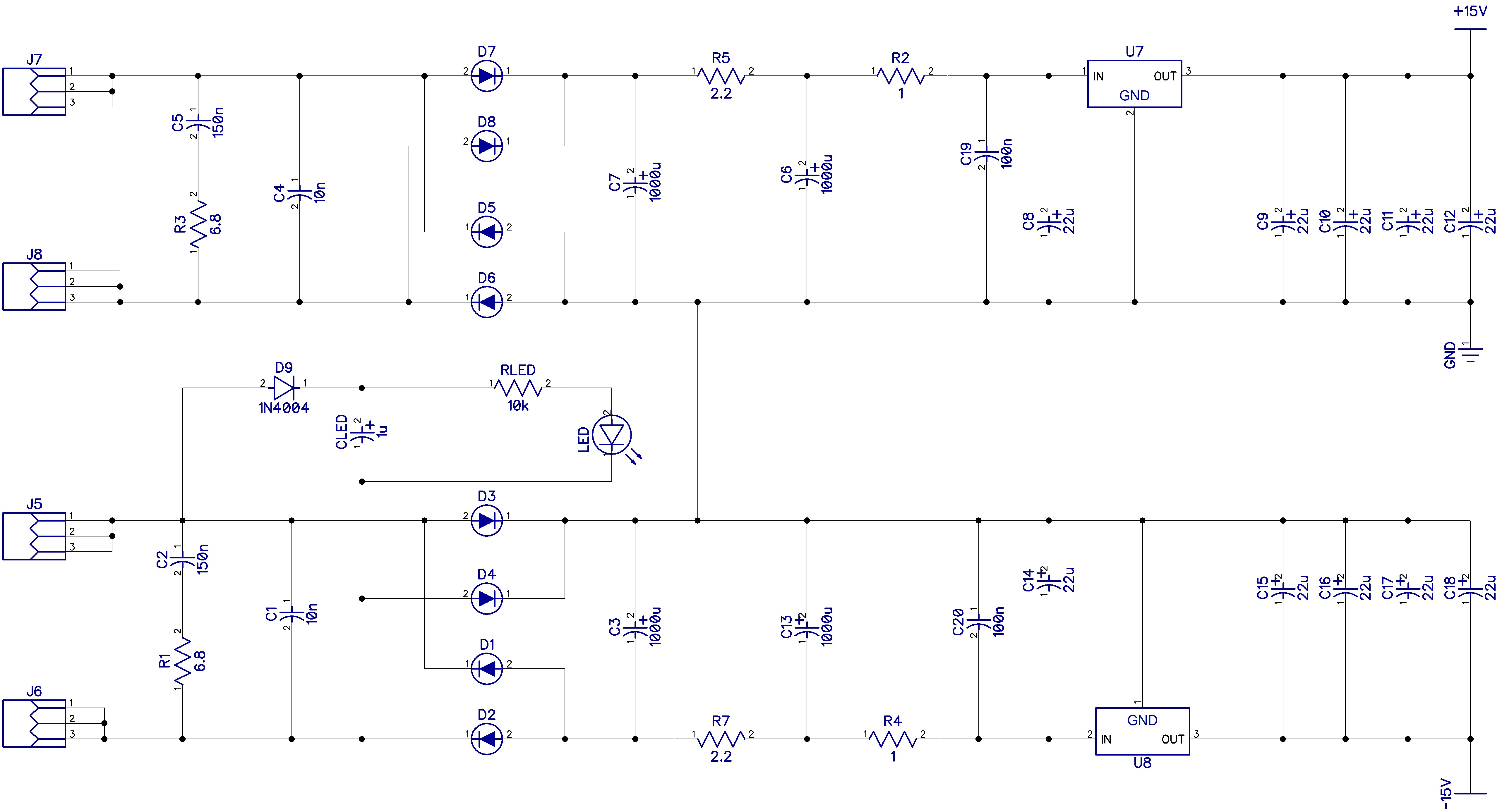

Even though 50VA is excessive, your 2x15V trafo would work great if you omit the cascode transistors in the onboard power supply. 2x12V is too low for the regulators to work as is. You can still use it, however, by changing the regulators to 7812/7912 and omitting the cascodes. It will lower the rails to +/-12VDC and, although I did not test it, should work just fine.

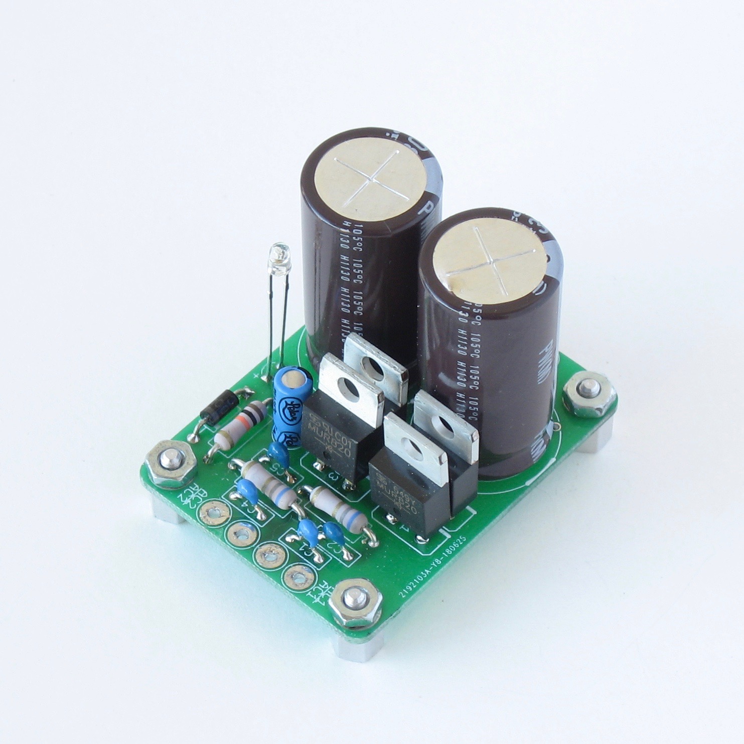

Any kind of reasonable rectifier and capacitors should work. I tested the board with a simple rectifier and a single 3300uF cap per rail (see photo). Bruno Putzeys added a second pair of capacitors and resistors, effectively cascading two RC low pass filters with the corner frequency of 72Hz, a simple and effective solution.

So...
suppose to use a new trafo with secondary as 2x15 25VA and 7815/7915 as rectifiers, copying some schematics and taking into account your suggestion, this is my result. Wdyt?

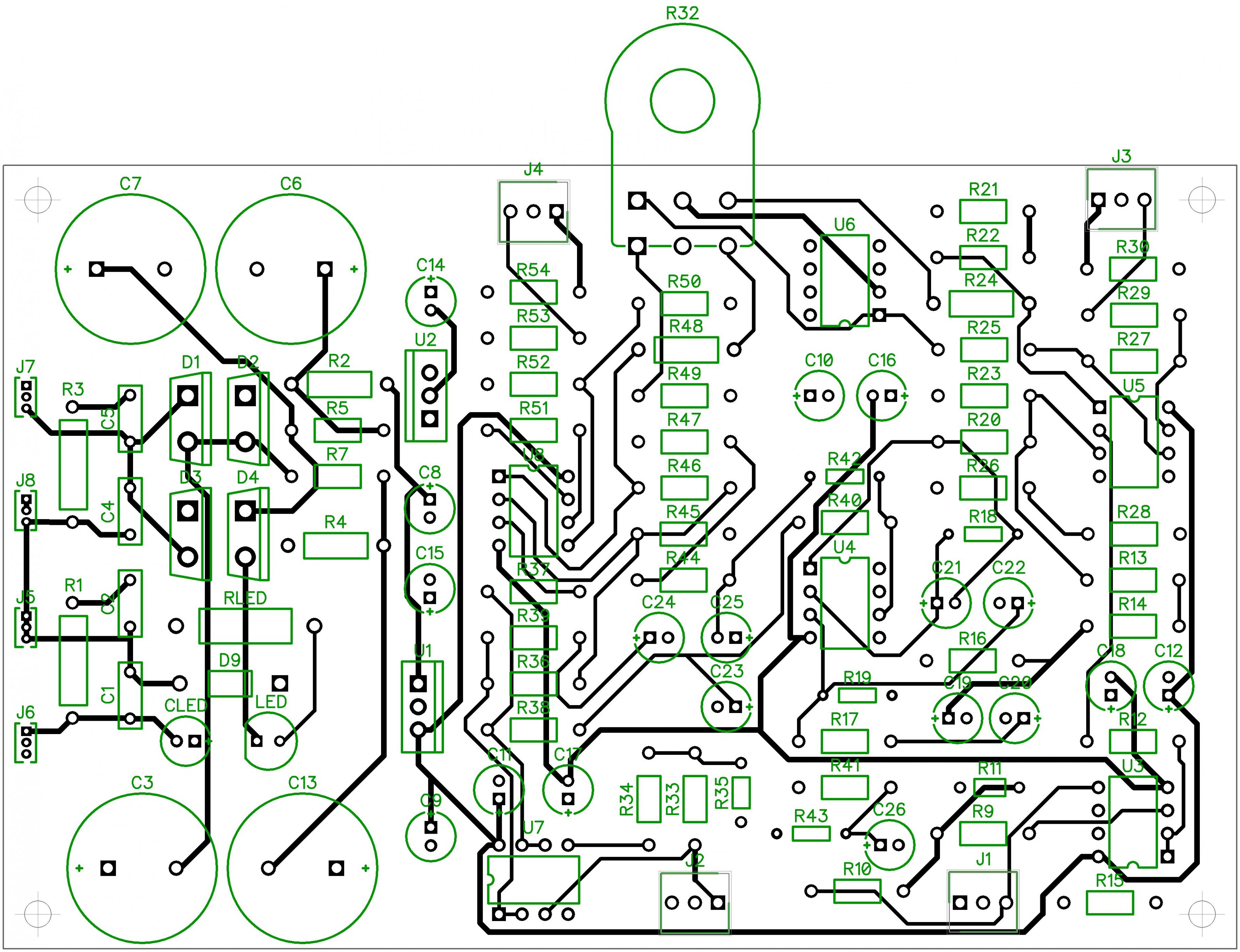

Joined 2009
You need a ground plane, however ground-connected signal references must be kept separate and connect to the ground plane at a single point.
The wire size is relatively unimportant. The BPPBP board uses 0.5mm for power supply, 0.2mm for signals and a solid ground plane.

So...
I hope to not become off topic.
I created a ground plane on the bottom layer and all components that refer to the ground are directly connected to that plane.
All other wires are on the top layer except for that ones that can only be created on the other side.

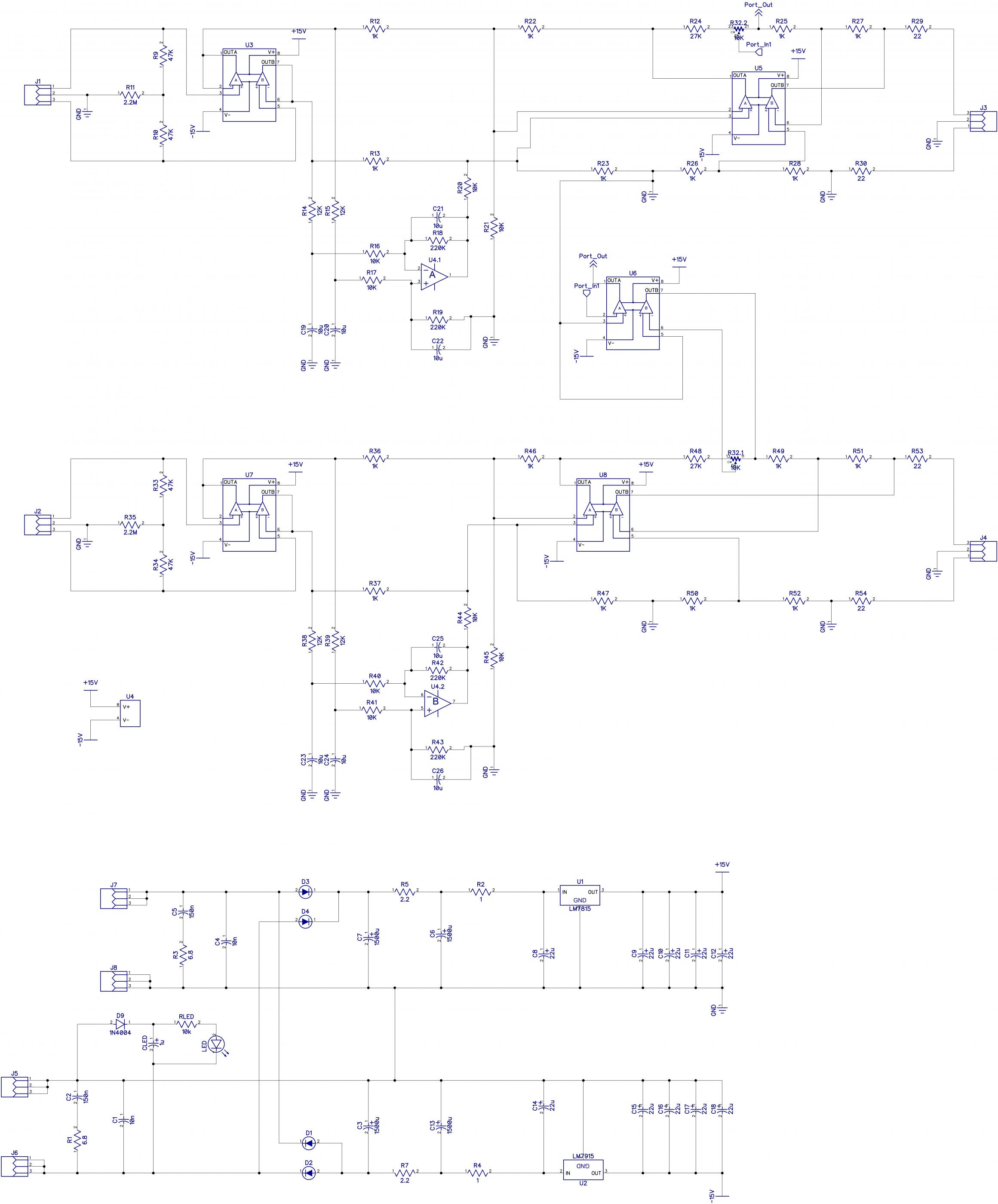

In attach the schematic and the result of my job.
